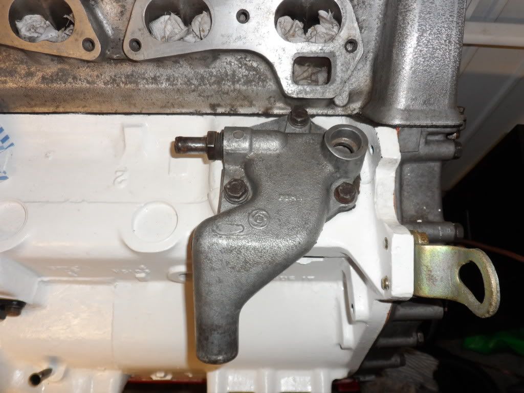

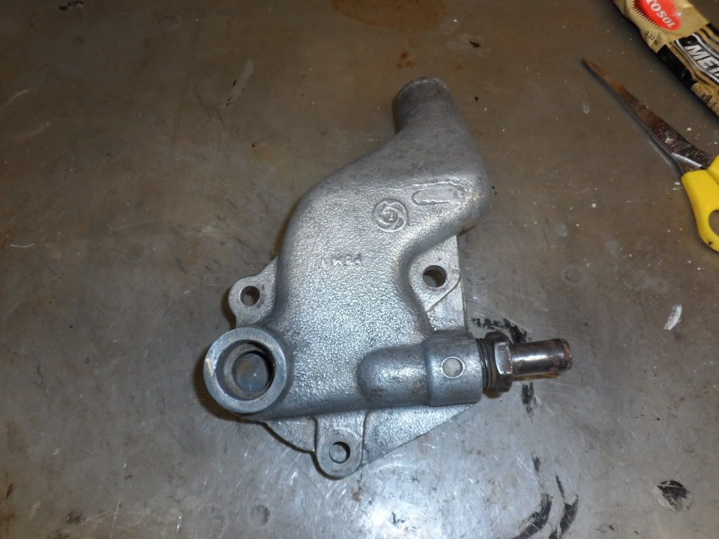

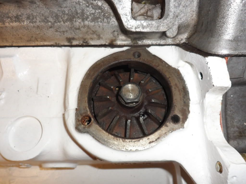

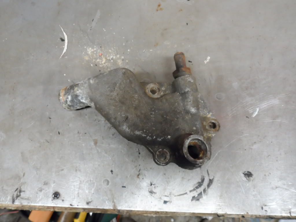

Cleaned up the water pump cover
Before....
After.....
Then fitted the pump to the block
Impellor next
Finally the housing with appropriate thickness gaskets.

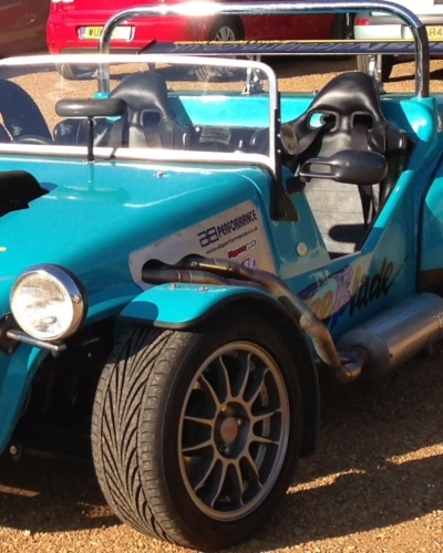

I'm running the Carledo with similarly modded arches and a choice of MGF or minilite replica 15s (though I think both sets are only 6" wide)
The F rims have 195/50/15 Toyo R1s which cost me £50 each a couple of months ago through a trade mate. These are BEAUTIFULLY sticky! The minilites are wearing Yokos, also at 195/50, whilst these are also pretty sticky, I seem to have worn them out in a little over 3000 miles (they are now my racing slicks!)
With polybushing, Gaz adjustables and the modded arches, (almost exactly what you've done) Ive now got the ride height roughly level and the tyres don't rub.
When first built, I had flanged standard arches, knackered original bushing, newish stock shox and 205/50/15s on the F rims. Even with the (accidental) tail high stance the car had then, the tyres rubbed the arches a bit when cornering agressively, but not any more and the Gaz have let me drop the rear ride height by almost 2"
I'm pretty sure the minilites have a slightly bigger offset than the F rims but, like you I'm going to get 3-5mm milled off them to help with potential problems.

Carledo wrote:...........195/50/15 Toyo R1s...........
:thumbsup:
photo 3a_001a.jpg (184.27 KiB) Viewed 1995 times

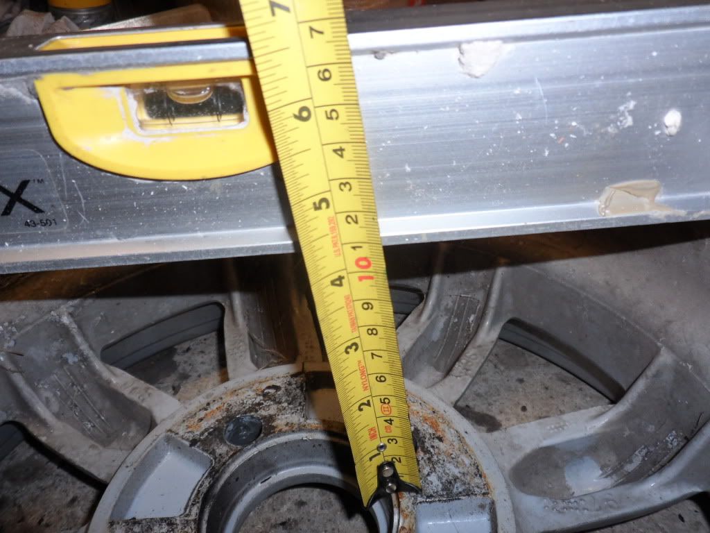

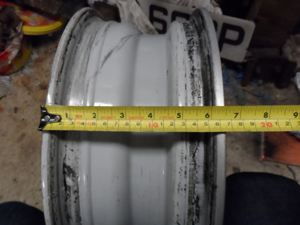

Thanks for the replies, I had the old tyres removed today as I am going to refurbish the rims, the guy at the tyre place said Yokos or Toyos, will see what is available once the wheels are finished.
Gave me a chance to measure them, they are 6.5" wide from the outer to inner rim:

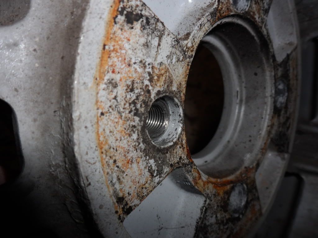

I could also measure the distance from the inner rim to the inside of the wheel, it's about 105mm, Steve do you know what you have on your wheels?
I have to be careful how much the offset is increased, looks like a maximum of 4mm, otherwise I will have to shorted the wheel nuts.
So I think I will have to stick with 185/55/15s
