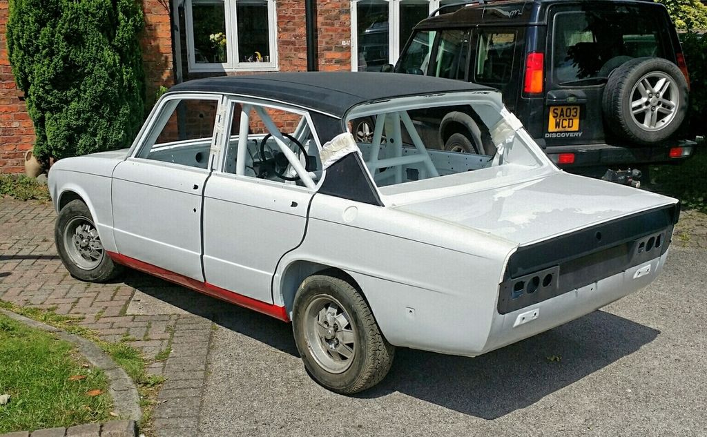

Crap picture, but it does look remarkable in the sunshine....better pics to follow....will be giving the Vikings a run for their money!

Glyn at Martrim, £300.SprintMWU773V wrote:Who did the vinyl roof?

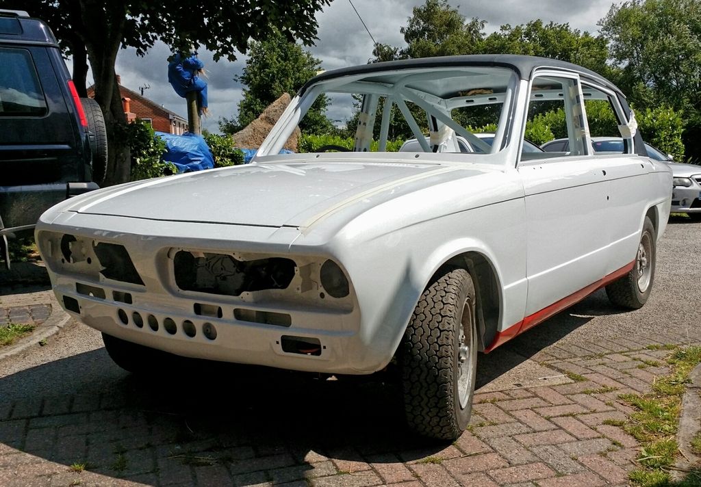

It's back!
H u g e run along the front edge of the front panel, but apart from that, pretty pleased really!
Gone over the top with the photo editing, but you get the picture....now the fun stuff begins I guess!

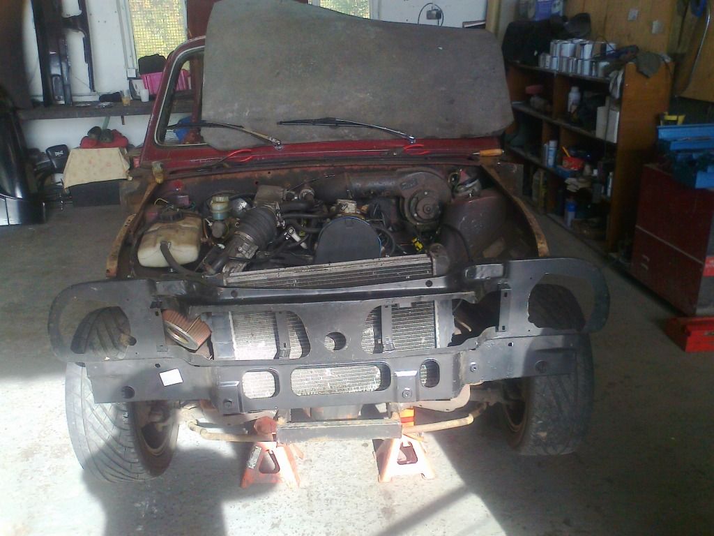

I have the 9-5 radiator and am looking at the engine going hmmmmm. Does anyone have insight on fitting this 27" x 17" piece in my Sprint? Help!
- Posts: 7247
Re: How bad is my Sprint?
I have used the 9-3 rad as have several others, I couldn't say if the 9-5 one is bigger (and can't measure mine at the moment) but the 9=3 one fits very nicely between the chassis rails, needing only some superfluous plastic trimming off the outside edges. I made up 2 "Z" brackets bolted under the front main rails to hold it up and one day i'll get around to making another couple for the top but the top hose holds it in place nicely!
Below are a couple of pics taken while I was rebuilding the front end which may help you, sort of like exploded diagrams. You may also notice that the rad is not square in the car, this is deliberate, to allow room for the bypass hose under the bonnet on the RH side. I know mine is a Toledo with a Vauxhall engine but the principal of fitting the rad is the same, the hole is the same size and shape and the hoses are in the same place.
