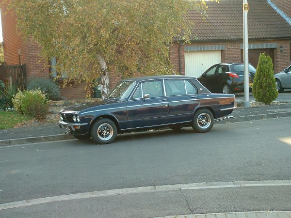

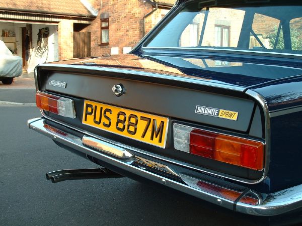

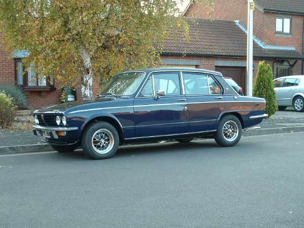

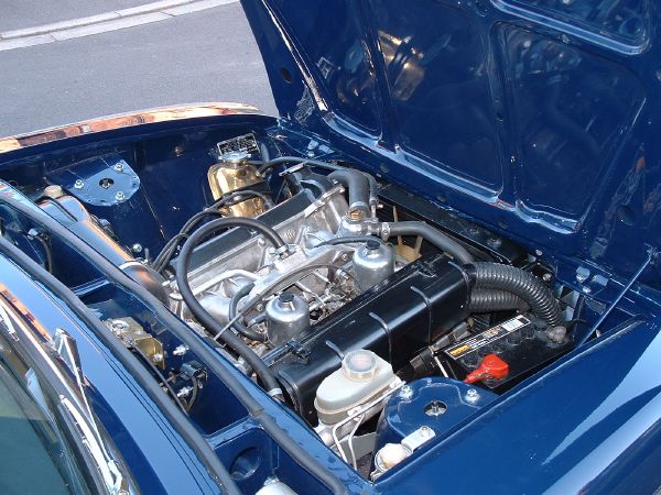

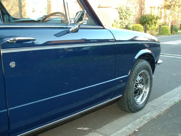

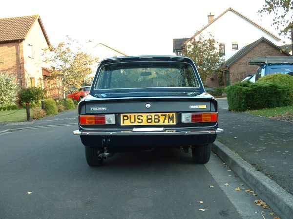

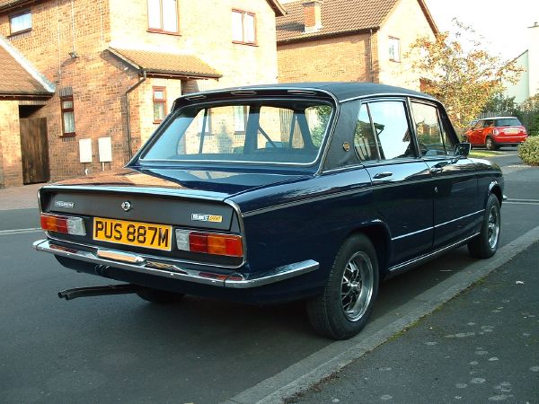

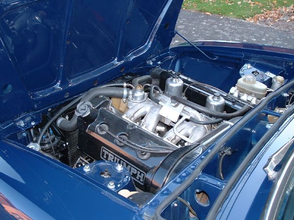

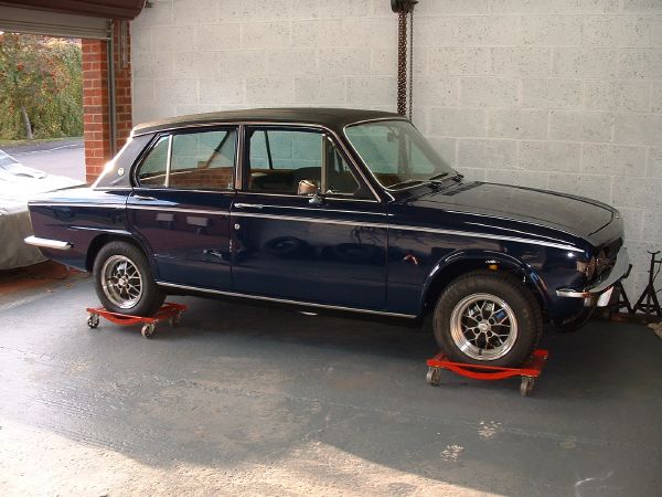

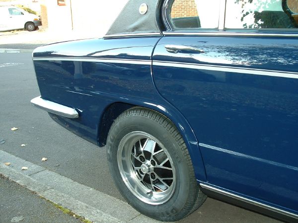

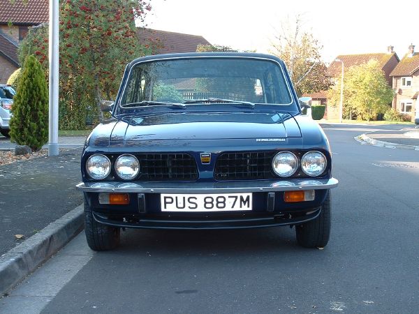

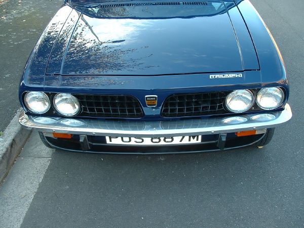

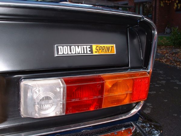

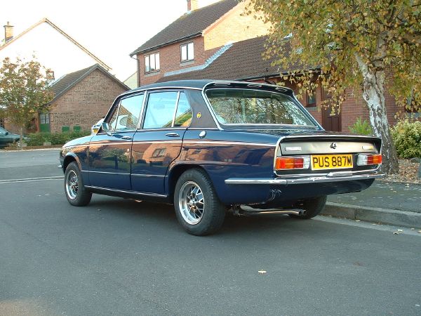

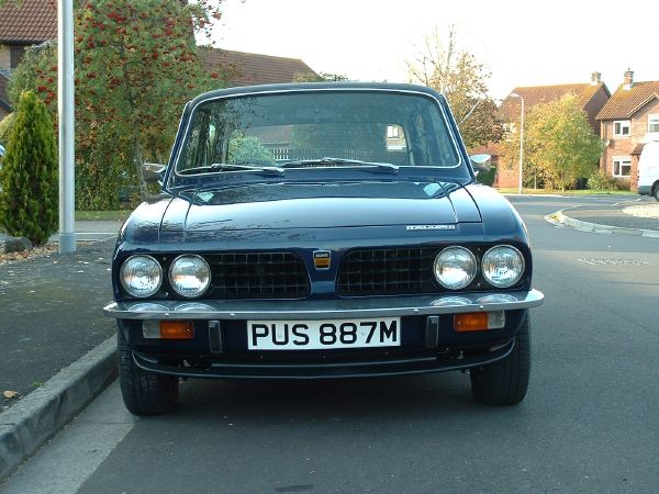

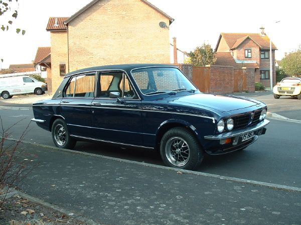

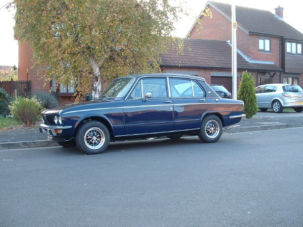

We collected PUS from the sprayers yesterday & on the way back home popped in to get the stripes put on.

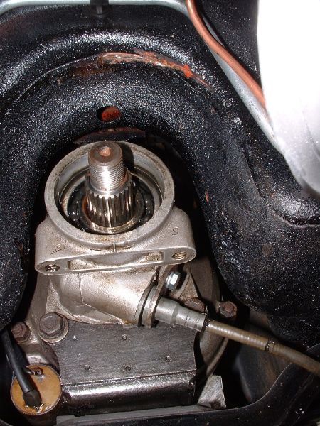

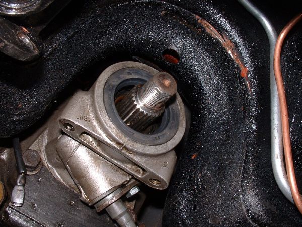

This morning I jacked it up & took off the diff. cover to renew the gasket, then I proceeded to fit the new rear gearbox oil seal...
After that we put the chrome cill trims & the chrome boot trim on and the rest of the badges & fitted the headlight surrounds.
I have a few more things to look at but essentially PUS is finished.
