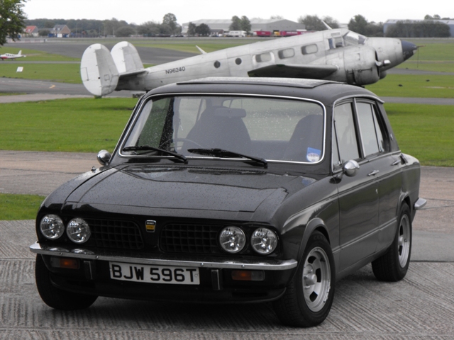

Excellent idea with painting the wheels black - I think it accentuates the rest of the car perfectly

The car is looking really, really smart. The black wheel centres suit it perfectly. You have done a cracking job given the constraints. Well done!

Looks great and a real credit to your hard work and skills.

Seeing the colour it makes me think that Triumph really missed a trick not marketing the Sprint in black, they would have sold a good number more I reckon.

what a cracking car this has turned out to be. looking back on the blood sweat and tears and not inconsiderable skill, it is a credit to you and I'm shaking my head in appreciation. It makes me look rather stupid sitting in front of the computer, but I'm nodding away
Black is good. Suits the car beautifully.

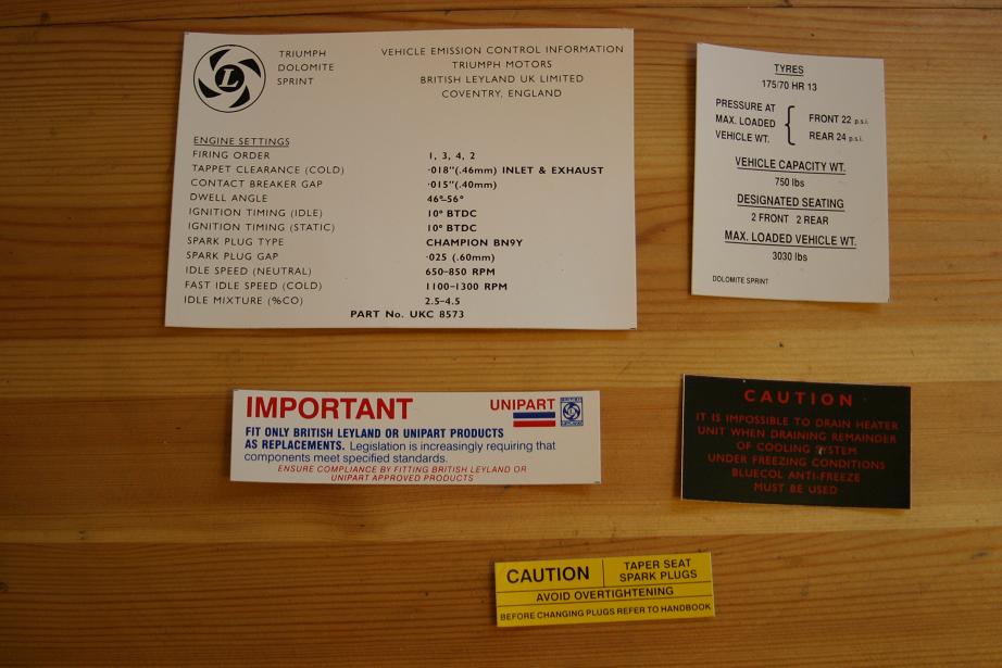

Got some stickers from rimmers before i started the resto, when i've finished all the main/needed stuff il stick then on. So if anyone wants to kindly let me know where they go with a pic or two maybe it would be appreciated.
