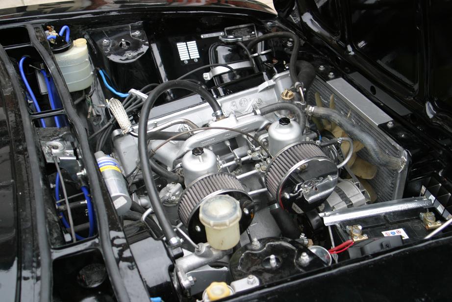

Still need to fit the heater motor, waiting to check all the manifold properly before i do that though..
- IMG_6283.JPG (112.67 KiB) Viewed 3347 times
