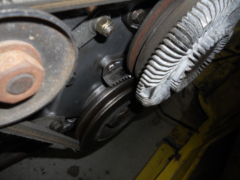

Then around the the front of the engine. Crankbolt out, inspected the timing chain, helicoiled two threads in the block and cleaned it all up. I've made the decision not to undertake a full engine rebuild and I'm leaving the head on, fingers crossed the engine is sound. Finances are one factor in this decision, the other is holding myself back from undertaking another bare metal resto and trying to draw the line on how mch work should be done. With the engine turning nicely I'm taking the gamble and if the engine has to come out again, then so be it. I'm stuck on taking the cylinder compressions as well, the tester I've got doesn't have a long enough extension to seat in the plug tubes. Gamble.

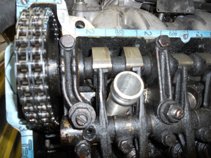

A few things worry me though, that horrible clanking noise while the engine is turning over, which is rather clear on the youtube clip, seems to be coming from the timing cover. It doesn't sound healthy at all.
I also inspected the valve gear after that run and a shortage of oil on #2 and #3 rockers was pretty obvious. The others looked okay and plenty of oil on the timing chain.

Sad to say you really need to see a good pulse of oil out of every rocker. If that isnt the case then you really need to strip and clean the entire rocker gear or you will
damage cam lobes.
This happened to my car donkeys years ago which is now why it has a STR91 and vernier pulley, so its an ill wind....but I doubt that's an option in Oz in this day and age...:-)
You could try a fine jet of compresed air up each dry rocker? The holes in the rocket shaft are very small though and may not unblock easilly.

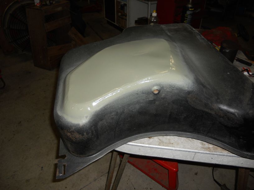

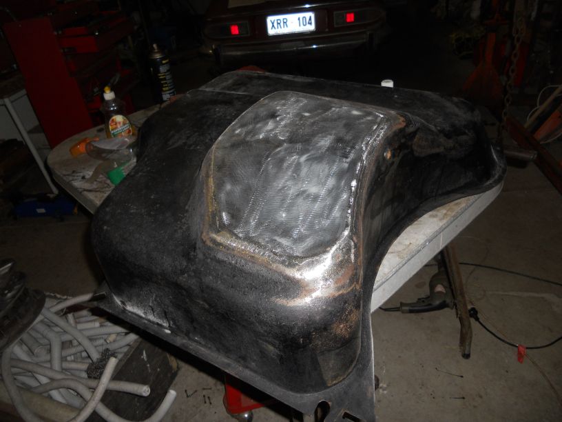

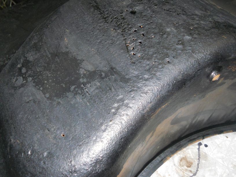

This week's work has involved getting the fuel tank sorted. Full holes on the bottom.
rusted out fuel tank
Took it down to george and we deliberated the best way to fix it. George told me to cut out the base and he would weld another piece in. I nervously dropped a burning rag into the tank and when it went out, I started the angle grinding. I dropped it in this morning, go it back tonight. All time record for George I'd say.
back from george.
back from george.
Just hit it with some primer, black paint to follow.
primered up.
primered up.
I cut around the standoff that takes the outlet tube across the tank holding it off he bottom and was lucky in not cutting into the bowl that confines the fuel float gauge. Not sure how George got the standoff back on, but it is supported. Next step will be to spray the inside with some fuel tank preservative. Any suggestions ? I was disappointed not to take any pics of the inside of the tank, it all happened too fast.
I also got the rear door handle back on as I move towards getting her back on the road. Painstaking job cutting out new gaskets for the handles and working out how the mechanism worked again. Unlike the first resto where all the parts were labelled and put away methodically, this one involves hunting for bits through boxes of parts. Even finding the correct bolt becomes a 15 minute saga of searching.
anyway, progress and a fuel tank where before I had none.
