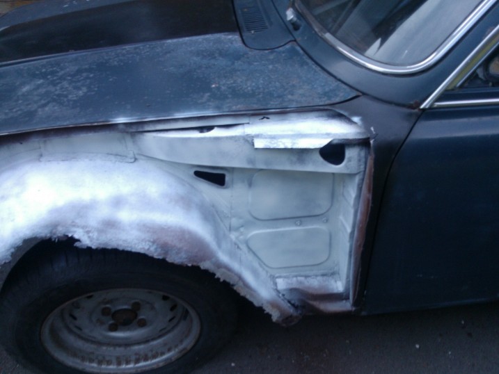

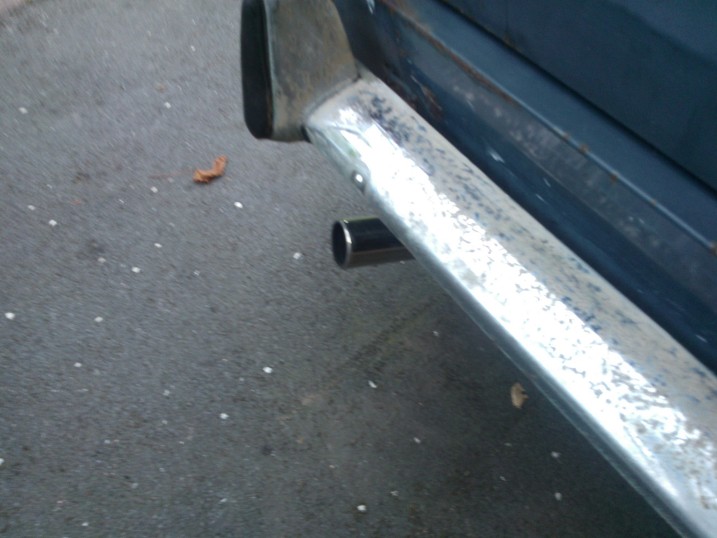

Apologies for the delays, I've been a bit busy with work etc, however, let's see if we can get some pictures to attach, note that the wing is only self tapped on at the moment, there's work to be done on the nose of the sill before it's fitted

Re: oh no, not a Triumph 2000
Exhaust looks good! Inner wing looks frilly.
Progress is progress however. Good to see some photo's.
Inner wheel arch looks frilly, inner wing looks solid as a solid thing!
Also advised that bottom of windscreen and A pillar would be rotten, they're wrong, it's all nice and solid!
What's really frightening is the lack of paint on the inside of the wing, and the enclosed boxes, hence the white that has been sprayed on to act as protection. Why white?, it was all I'd got knocking around, but it won't be seen once the wing etc is re-attached.
