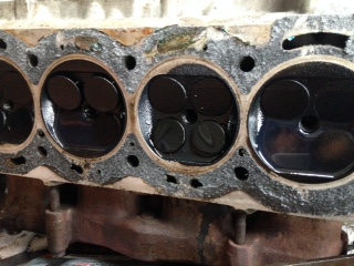

I also took a photo of the valves it looks a bit on the sooty side to me
Re: PCK911T MY STORY
With the head off its much easier to attend to the timing chain. You want to be really sure what caused this having just done the water pump. With the timing cover off it may be more obvious. You need to be sure that the jackshaft spins freely and you can feel the pump
turning nicely.
Any impact marks on the pistons? They are often numbered and also graded in letters with F being the closest to bore tolerance IIRC.
turning nicely.

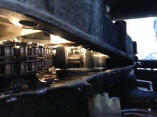

Today I partly removed the timing chain cover ( I say partly because I haven't got a socket big enough to remove the pulley wheel yet) just to see if their was anything visibly wrong and I noticed that the chain tensioner was quite extended so much so that the chain was coming back on itself. So I think I may need a new chain as this looks stretched to much
Apologies for the picture it's the best I could do
I've looked at other photos and the tensioner gap isn't even half the distance mine is protruding I forgot to mention that the head is off the car Apologies for the picture it's the best I could do
No that's misleading....with the head off you dont have the chain in the correct position and if you turn the engine the tensioner
will ratchett out.
Its not broken....take it all off properly and get that pulley off then you can reassemble and know its done right. The pad is still on
the tensioner and doesnt look too bad, but you will see more when its all off....
You still want a diagnosis as to why it locked up....
Can you turn the cam over reasonably easilly - it will sort of jump as the cams press on valve springs?
Sorry to say but getting the crank pulley off is going to be a mare with no starter and only the gearbox to hold it now.
Lock the flywheel ring gear with a suitable wedge in the starter hole.
Dont forget the bolts through the sump that go in the base of the timing cover.
will ratchett out.

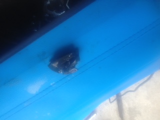

For those of you that have been reading my little resto thread , I have now discovered what made my engine come to an abrupt stop after attempting a compression test.
It was this It's the rubber seal on top of the cylinder head, god knows how it got past the cam sprocket holder
All I can think of it stuck too the rocker cover and dropped down onto the crank sprocket
At least it's nothing terminal.
I also discovered that whoever worked on the engine before used a alloy cylinder head nut which has stripped it's thread so I'll have to get a new nut

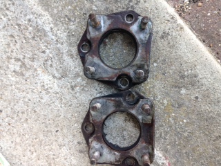

After doing the timing chain and valve timing which went better than I thought it was going to do.I set about doing the ignition timing and after a bit of prompting from incadolly I got the car to fire up but it wouldn't run at all well ,after a bit of a search I decided too strip the carbs, the mounts didn't look too great
and I think I was right here's a pic
looks too hav been leaking air badly on the side and bottom of the mounts
I also found the jets are different sizes is this normal
one is orange and the other is yellow
So it looks like a rebuild on the carbs And some new mounts
Wrong jets....a T plate should have waxstats...
Some dont like them but I quite do....
Thanks for the reply Jon, the thing is when looking to see what I needed to rebuild the carbs I typed in the numbers on the float chambers AUD545 and apparently these carbs were made only between 1973/74 so a previous owner has changed them. So are they still the right jets for those carbs?Jon Tilson wrote:Wrong jets....a T plate should have waxstats...
