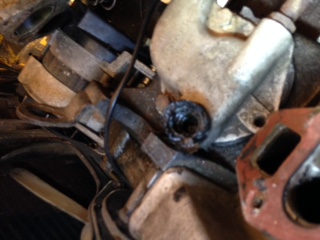

After taking delivery of my dolly I noticed it had what I would call a medium sized oil leak. So today I thought I'd have a look too see where it was coming from. So spanners in hand I trot off to the the garage expecting to order a gasket of some kind. Started her up and waited and soon enough their it was coming from the water pump :roll: :roll: So I drain all the coolant and whip off the inlet manifold and discovered the connecting tube caked in gasket seal. Not a good start :roll:

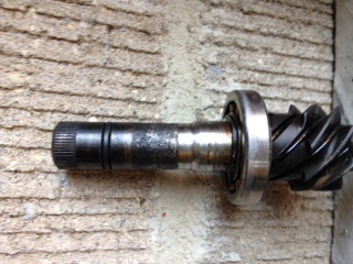

After removing the impeller ( which on many occasions didn't have a father) I was a bit concerned about the condition of the pump shaft. Your opinions would be greatly appreciated

#4 Post by Jon Tilson »
Looks fine....

I had the dollywiki article with me on my tablet it was a great help. I've still got to get the brass basket out yet. The bearing seems to be in good shape so bit undecided wether to take it off the shaft. The oil seal was a different matter thou

I can't really see from the pics/avatar if it's a Sprint or an 1850?
Sprint - get the rocker cover screws from xvivalve. 1850 - get the rocker cover screws, washers and gaskets from James Paddock, part numbers 147737, 147738 and 148090
Posts: 6502
Aye,....
#10 Post by sprint95m »
GTS290N wrote:I can't really see from the pics/avatar if it's a Sprint or an 1850?
In the first photo you can see the cylinder head port for the coolant to exit, said port's shape shows that this is a Sprint.
