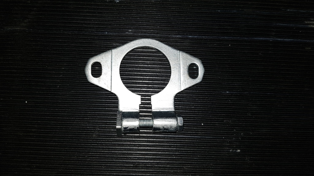

Also, I am not using the adaptor made by Jeroen for now, (I have two 123's so maybe on
the second one) instead, I am opting for some experimentation with readily available
items, such as the "3h2138" Triumph TR2/3/4 clamp.

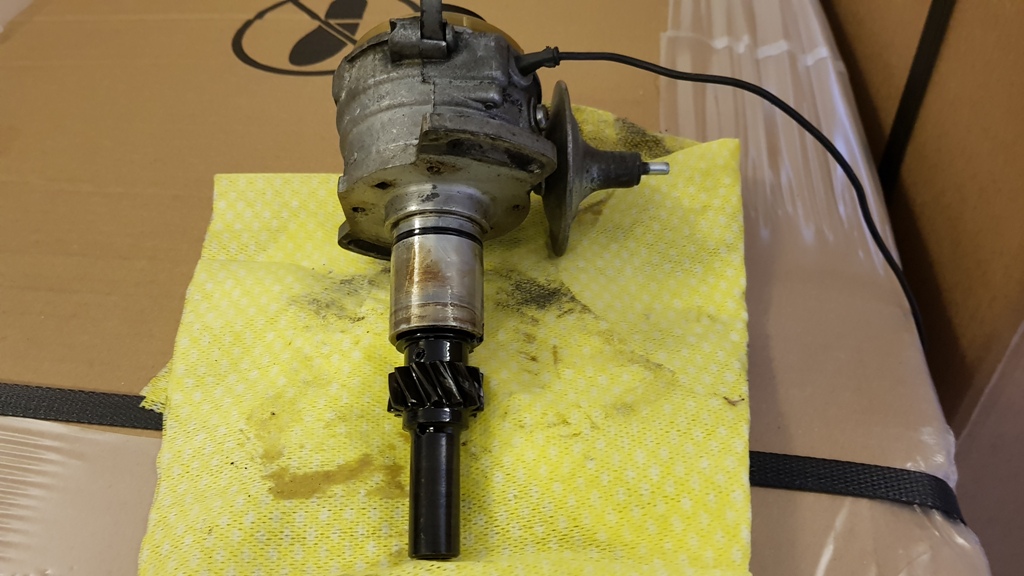

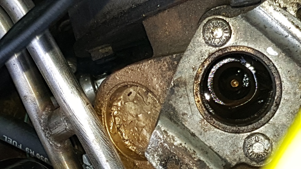

Still sifting throught the pics, took out the old dizzy.
Mahesh

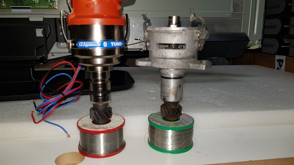

Ok, first thing is to get the drive gear onto the end of the 123,
Inserted a parallel pin into the 123 to reduce the size of the hole, then another through the drive gear, and 123.
The 123 is slightly longer than the old 44d, about 1cm, but that is not a problem.
Mahesh

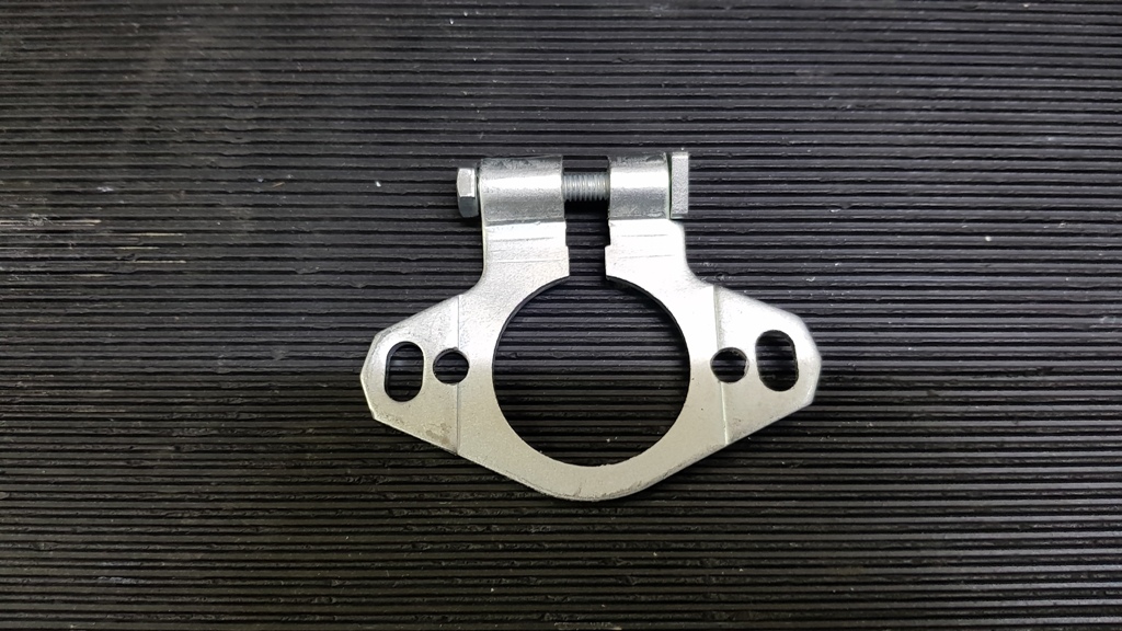

Next, the clamp
Mahesh

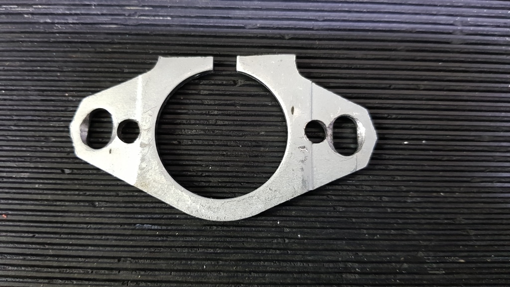

Re: Sprint 123 USB dizzy
#42 Post by Mahesh »

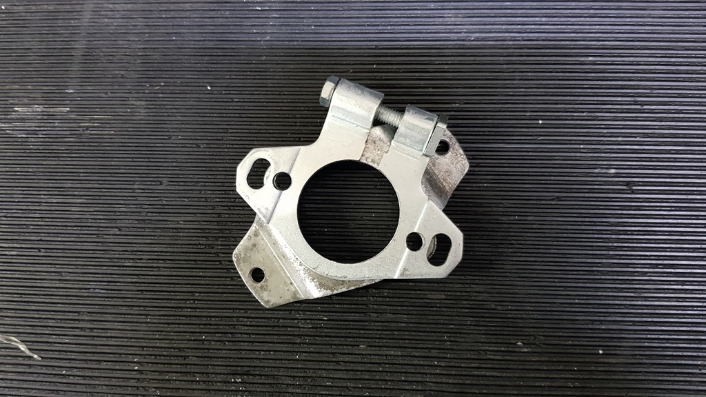

Drilled two holes through to match the original distributor mounting plate,
The wings do not match up with the original plate, it would have solved a few problems.
Mahesh

The clamp would not mount into the car, and was being raised from the back, which touches the block.
Mahesh

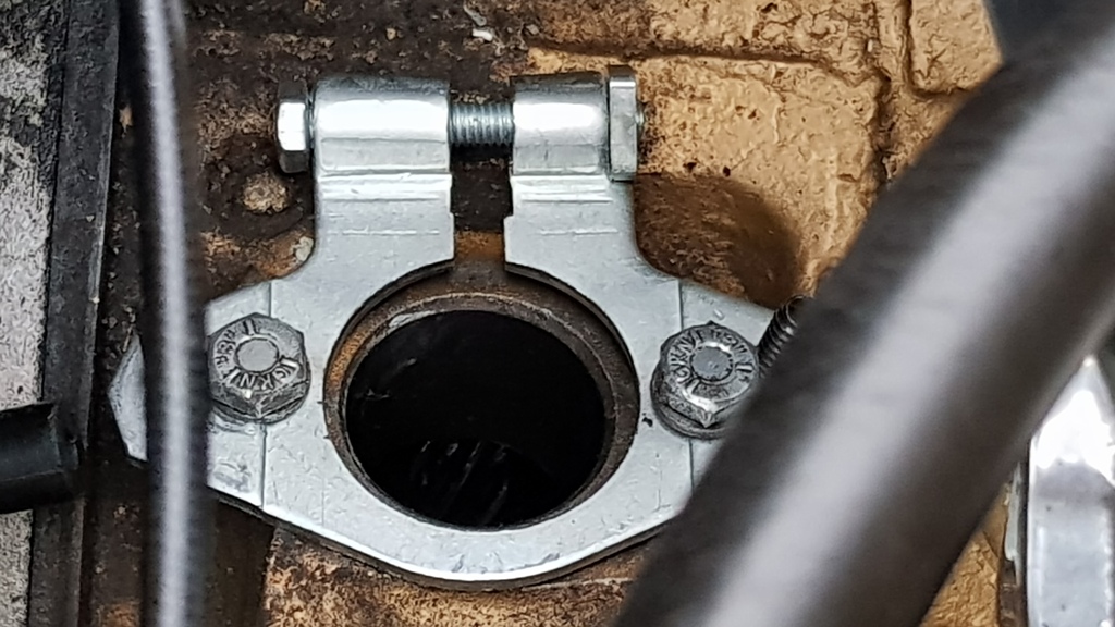

#44 Post by Mahesh »
Chop time,
Mahesh

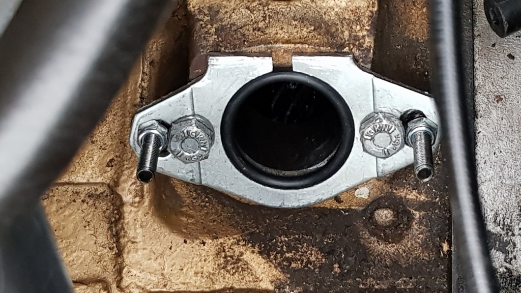

Posts: 1293
#45 Post by Mahesh »
Initially, I used two m6 bolts from the underneath of the clamp, now changed to m5 with a couple of nylocs, the pic explains it better.
The o ring in the picture does not do much, as the ring on the 123 shaft is pretty comforting when put in place, (I was just thinking it might stop the odd oil splatter),.
