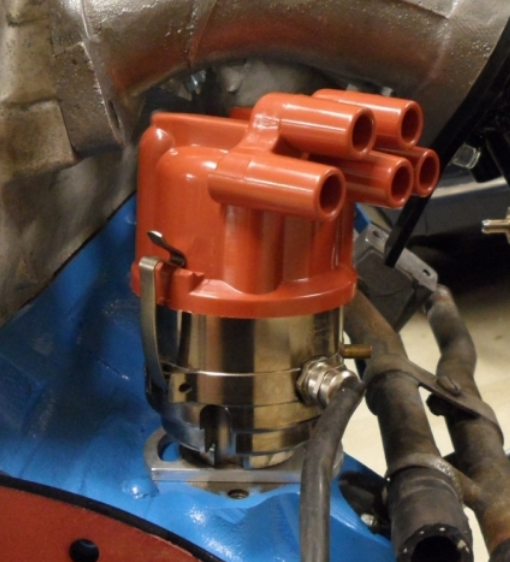

That one you can return. It will not fit as any 123. It is a Dutch product and there is one company here what modifies sprint dizzy s and others and does fit the 123 electronics in it. That company is not the manufacturer and their conversions are not that good as the original product. A few years ago I did make some adapters to fit a std 123 tune in a slant but no more left. The option is to buy a ready to fit modified one or buy a 123 and make it fit your own dizzy what I am doing right now in various cars. Still the original look and cap but modern electronics.
The adapter you can see in the motorsport section at " start with a new project". Maybe I can have a few made again if more want some.

It's a bit difficult to place a link from the forum into the forum with my phone but here is screen shot. It is difficult to reach them. It started as a small company but they went crazy of the world wide phone calls and emails they now receive. Friends of mine are a dealer and I thought they have a different email and phone number for dealers now.
The company that modifies is Hebels British sports cars in Holland. They buy 123 ignitions and modify. They do dolomite ones but never seen one in real. I believe on the forum are a view who have one. The only thing I know that the ones I did see broken were the modified ones and not the original ones in their original 123 housings. They do not turn as nice and smooth. Maybe they do not line up ok or something.

I found the picture just as you posted a reply, (the blue engine cover does look nice, is it still like that ?)
