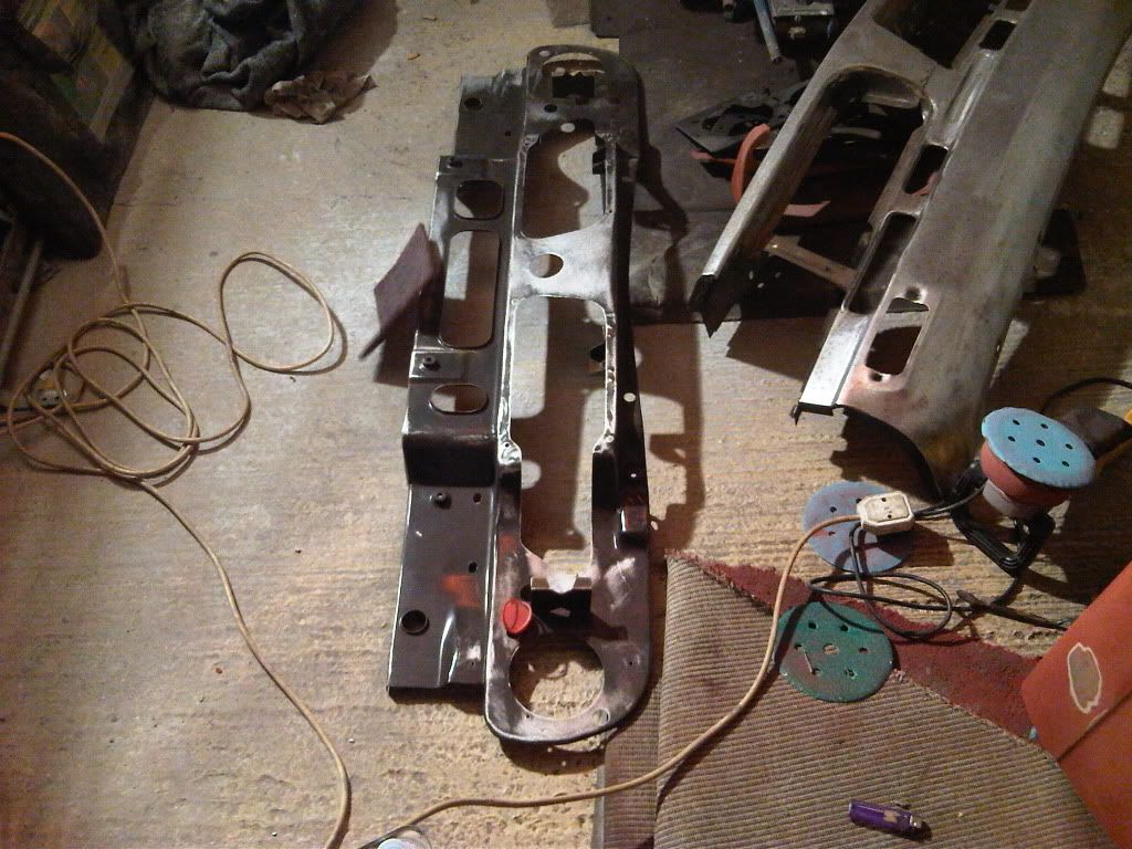

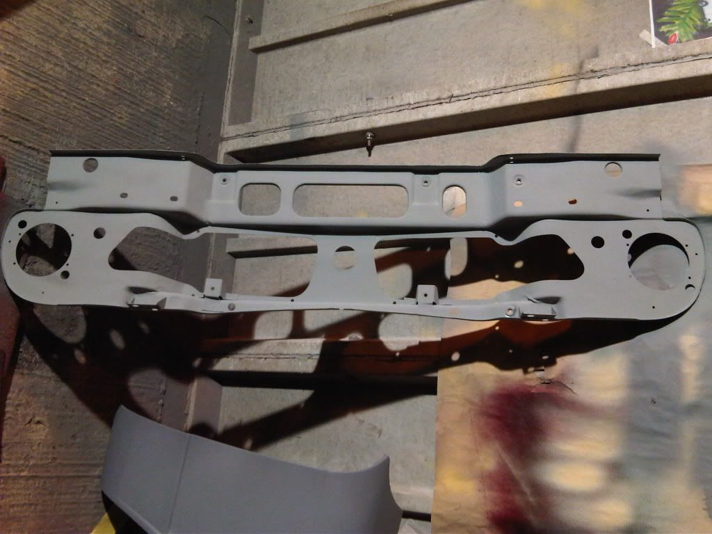

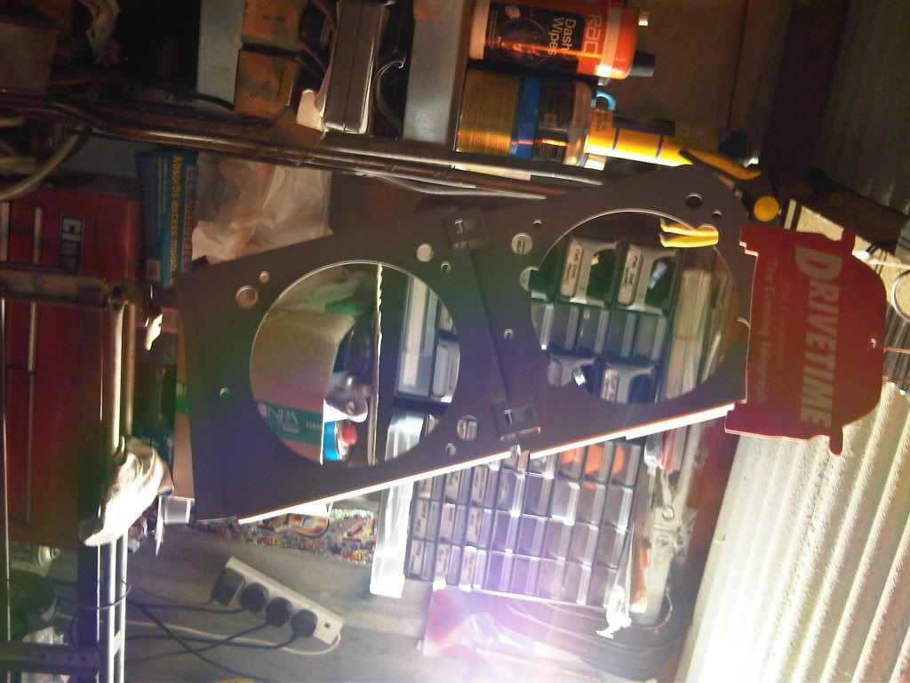

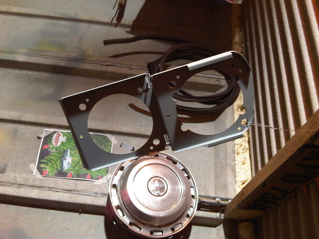

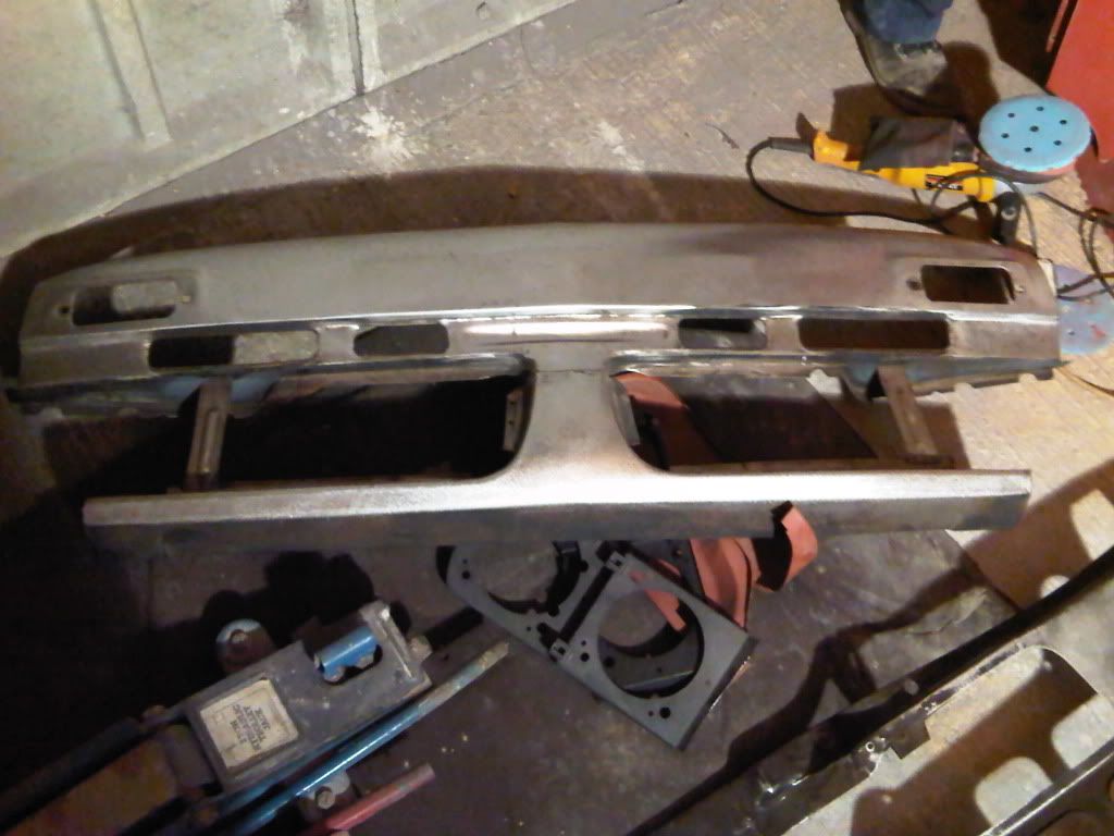

Had my first master class yesterday! Got rid of all the surface rust and stone chip and primed the panels all up in the same colour.
Here are some pics. Eyebrows are done too but forgot to take photo.
Thanks again for the use of your tools and all your help Nathan.
See you all soon.
Tom.

#48 Post by xvivalve »
Ah, its a repro front panel!
Take your plastic egg crate grilles and test fit them in the apertures of the new panel to ascertain whether or not you will be happy with the appearance. You might need to fettle the depth in order to get them sitting satisfactorily...

and you might want to take the bits of panel that will be welded back down to bare metal and prime them with weld thru primer instead.

purplebargeken wrote:and you might want to take the bits of panel that will be welded back down to bare metal and prime them with weld thru primer instead.
Tom has bought some weld thru primer for the very task, last night we primed them in zinc primer to stop them from rusting,as they will be in Toms garage for 2 weeks!!

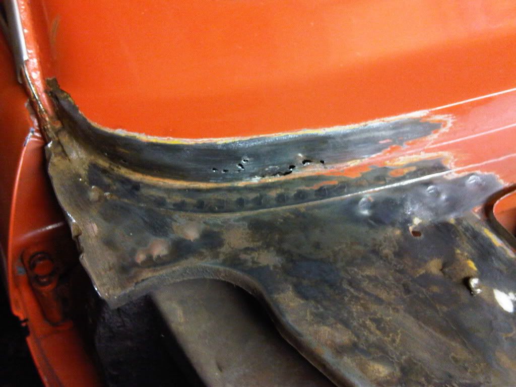

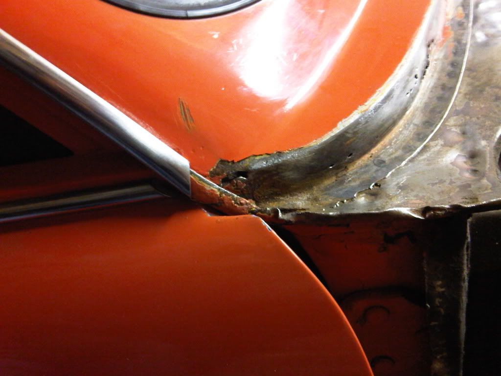

Just popped out to the garage and did a bit more investigating.
I found this:
Spoke to Nathan and he is going to get me some sheet metal to make up a repair panel with and doesn't think it will be too much trouble. Will need to be sorted before the wing goes on though.
Alun - The kidney grill bits are in the boot ready to be used to help line the front end up. It is miles out at the moment but I think it will be easier to get it right when the rest of the front end is in place?
I guess we will need an assortment of hammers other stuff to change the shape of panels though? I know nothing about this so suggestions would be great.
Thanks
Tom
The kidney grilles are trim and do not contribute to the alignment of where they sit, they just emphasise how crap it is. What I am attempting to fore warn is nothing to do with alignment and cannot be rectified by panel adjustment as they are fitted. The repro front panels are notorious for having insufficient depth for the grilles to sit in and they therefore protrude from the aperture once fitted, it is this that I am asking you to test fit as you may wish to adapt the flanges to accommodate them! Once the panel has been fitted you will not have opportunity to redress this...
Zinc based primer is hydroscopic incidentally, so your nice grey panels will attract and hold water if stored anywhere with humidity or dampness. Weld through primer is non hydroscopic,
