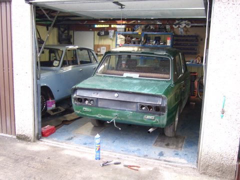

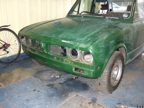

Nugget is home! :D
Already got stuck in too! Given her a quick clean inside and out, and an oil and filter change, spark plugs, battery & fan belt.
Also swapped the horrid late-type carbs for some earlier HS4 I had "on the shelf" as I don't like waxstats and poppet valves. :roll: Adjusted the mixture with the Colortune and balanced the carbs, she's running very nicely now. The tickover was a bit low so she was faltering when in drive, so that's also sorted.
Tomorrow's tasks are electronic ignition with a new dizzy cap and red rotor arm. Might start attacking the doors too if I get time.
We've decided to do a full respray as it seems silly to do bits here and there, we might as well get it all done at once. Looks like I'm going to be busy! :shock:

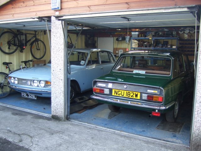

Excellent! Nugget is looking right at home next to the 2000 8) How did she drive?
She will look fantastic in a fresh coat of Brooklands Green. The correct paint code for the car is HAE - there are three different shades, but HAE is the original!
When you spray her, please take that TRIUMPH badge off the top of the front panel, it's not correct for a 1980! It was left over from the 1500TC guise she was in when I bought her. It's only stuck on with double-sided tape. Likewise with that Club Triumph badge on the boot - that wasn't my doing! :lol:

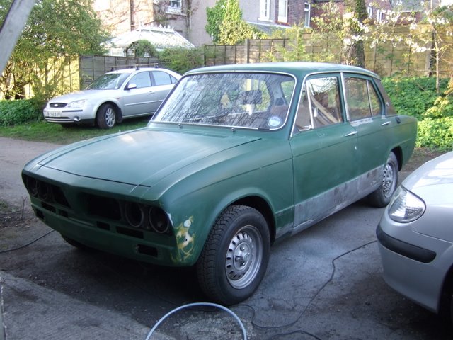

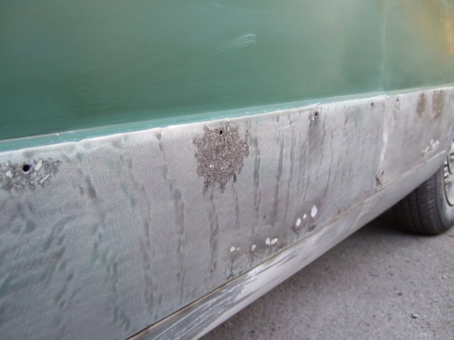

More progress today! We've stripped most of her brightwork off and Tracy has been busy with the wet-or-dry. I have taken the paint/filler off all the door bottoms to see what I'm up against. Both drivers side doors are rock solid. The rear passenger side door needs one small repair patch, but the passenger front door isn't so pretty. Can't decide whether to swap for a decent second-hand door, or weld in a door bottom repair.
Time for a beer now I reckon! 8)
Purplebargeken
Re: Project "Nugget" - 1980 Brooklands Green 1500HL Auto
#50 Post by Purplebargeken »
Cracking work! Weld in a repair panel. Matching gaps is a pain.

Personally I'd try to keep the original door. The panel gaps on NGU are very good and you'll lose this with a replacement door unless you re-skin it. If the repair goes wrong, you'll be after a new door anyway so it's worth a try!

I'm with the "keep the door and mend it" camp on this. That said, you don't reskin a door to make it fit, you either remove or add metal from & to the edges of the existing skin by grinding or adding lengths of, for example, welding rod and build up with lead as the factory did to finish.
Keep the one you have, go on, you know it makes sense! :wink:

Howard81 wrote:Exactly how bad was it under the paint?
I'll try to sort out some photos this weekend Howard.
Did lots more flatting last night and will be doing some more tonight. We've managed to sort out the "bumpy" paintwork on the roof and have found a bit of localised rust repair and filling, but nothing serious. :D

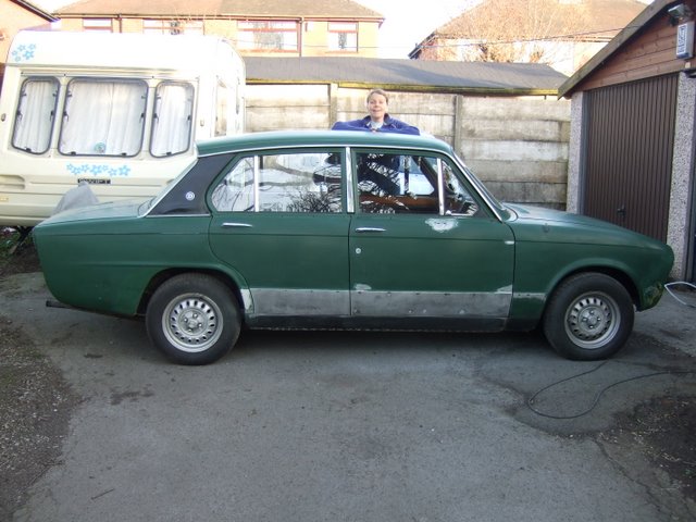

More progress! Most of the flatting is now finished, hence Tracy looking rather jolly! :D Rusty bits have been stripped back as far as possible, ready for some rust remover.
I've also had a proper go at the front passenger door. Actually not as bad as suspected! :) I think it will repair OK and last a while, and I will perhaps think about a proper door repair panel sometime in the future.
