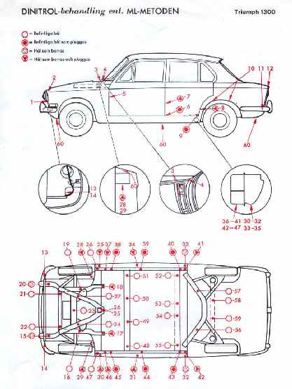

Mark, Wax injection is a bit hit and miss in the hidden places unless you drill your own injection holes in certain places.
I think may have mentioned to you that I waxed Ada by drilling holes and filling with discrete rubber bungs or by hiding them under under tread plates etc. This applies particularly to the sills. I've seen inside a few Dolly sills where someone had waxed only to find a very poor coating from trying to reach in with an extension pipe. It must be the same for 2000s.
Were you quick enough to get a handfull of the UK rubber bung mountain I "accidentally" ended up with last year?
Here's the Dinitrol waxing guide for reference.
Hint...don't do this job on the brand new block paving on a hot day!

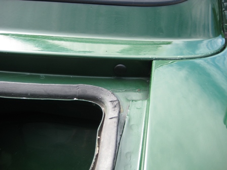

Here's the scuttle wax holes......

Thanks for the advice and encouragement everyone (and for the excellent rustproofing guide Steve)! :D
I think I will be using Dinitrol or Bilt Hamber products. I've used Waxoyl in the past and had nightmares trying to get it where I want it.

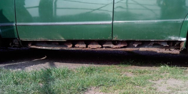

The driver's side sill has been removed and only a small repair to the inner diaphragm and one jacking point was required, and the new sill has been fitted.
We knew the passenger side sill needed attention because of the hole at the rear. However, the photos attached show what was (or wasn't) lurking beneath! :shock:
Welding is due to commence tomorrow and we're hoping that it will be completed over the weekend, including the floorpan repair.
The brakes have needed some work in the form of a pair of reconditioned front calipers and a reconditioned servo. A new top ball joint and a track rod end will also be fitted and hopefully ready for the MOT next Wednesday, and we will be able to collect Nugget next weekend. 8)
