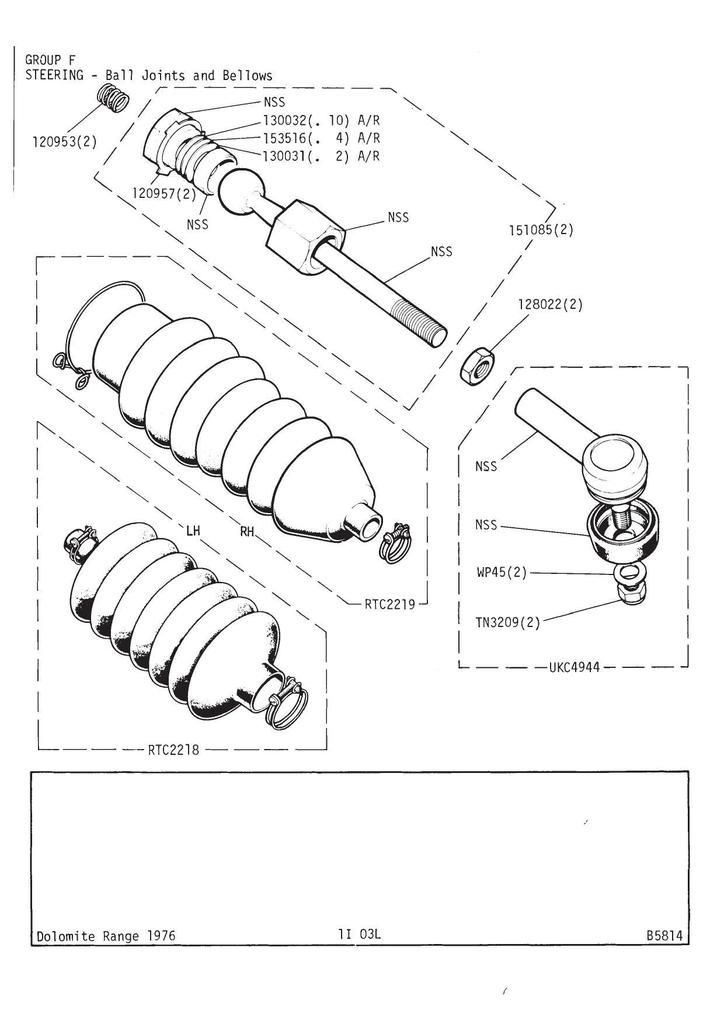

If you also have play in the inner track rod end as you call it I have in the past obtained extra shims, part numbers 130031 (2TH), 153516 (4TH) and locking tab PART 120957 from Moss-europe.co.uk but this was several years ago.

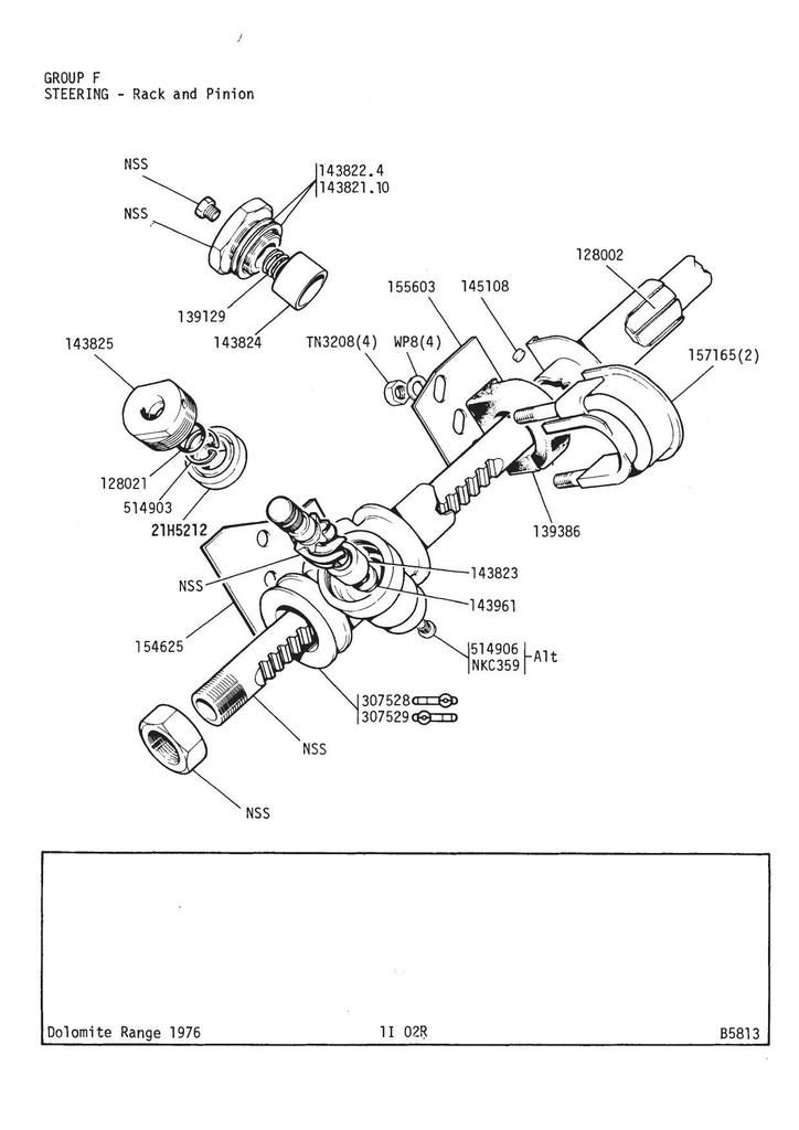

One interesting bit is that from the above parts diagram ( Thanks Dave ) it looks like the only difference between LHD and RHD cars is the rack tube itself. ( 307528 for RHD and 307529 for LHD ). Does this mean that the rack itself, the pinion, the various bearings, shims and washers can simply be swapped over from RHD to LHD from a new rack ?

In answer to your question. It certainly looks as if all the parts except for the tube are the same on the LH and RH racks.

Will you need an "OPPOSITE HANDED" pinion? As it is angled to the left on LHD rack but to the right for RHD.MIG Wielder wrote:One interesting bit is that from the above parts diagram ( Thanks Dave ) it looks like the only difference between LHD and RHD cars is the rack tube itself. ( 307528 for RHD and 307529 for LHD ). Does this mean that the rack itself, the pinion, the various bearings, shims and washers can simply be swapped over from RHD to LHD from a new rack ?
Re: Help fixing steering column movement
I think the LHD pinion is different. Didn't James467 have one sent to him in error? It is documented on his resto thread.
