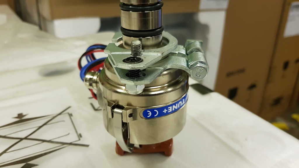

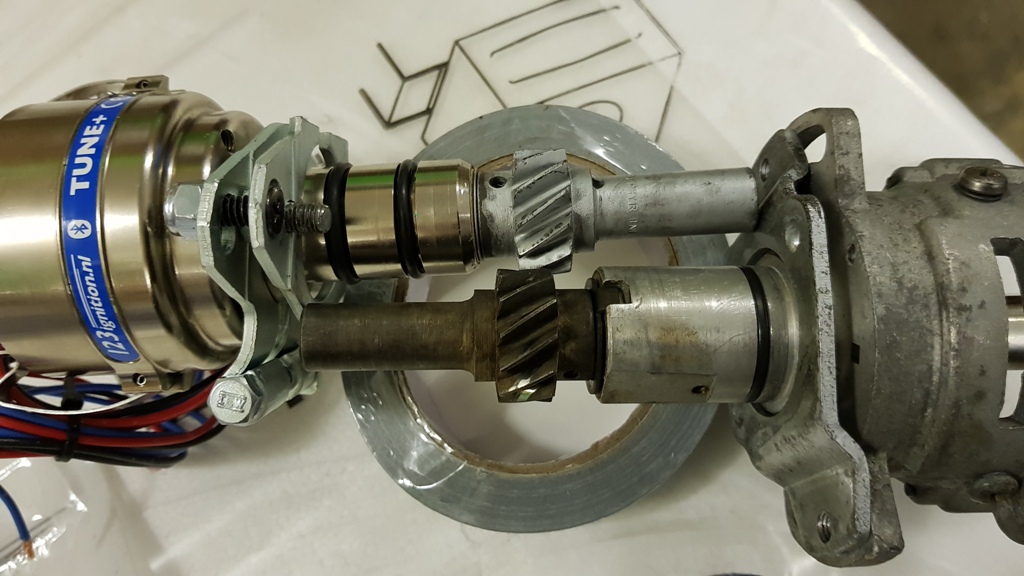

Removed the clamp from the car again, and joined up with the second clamp to check height, the pic was taken with the m6 bolts, now changed to m5 and nyloc.
- 16.jpg (151.22 KiB) Viewed 2274 times
Re: Sprint 123 USB dizzy
The height was my main concern, which is now spot on as the plate mounting bolt heads are the perfect spacing height and keep the two clamps apart just right.
- 17.jpg (203.27 KiB) Viewed 2273 times
So to sum up, the bottom clamp is bolted to the engine, the top clamp to the bottom clamp, and the 123 to the top clamp, and once the timing is set, both nylocs and clamp tightened up.

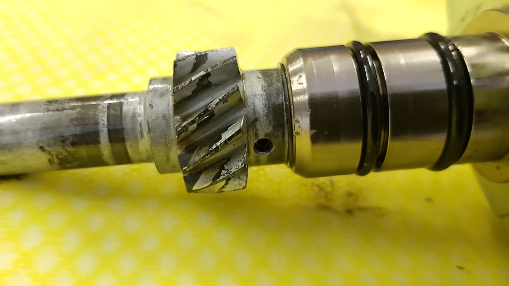

I painted the drive gear silver, as I will remove after a couple of days to see where the gear contact point is.

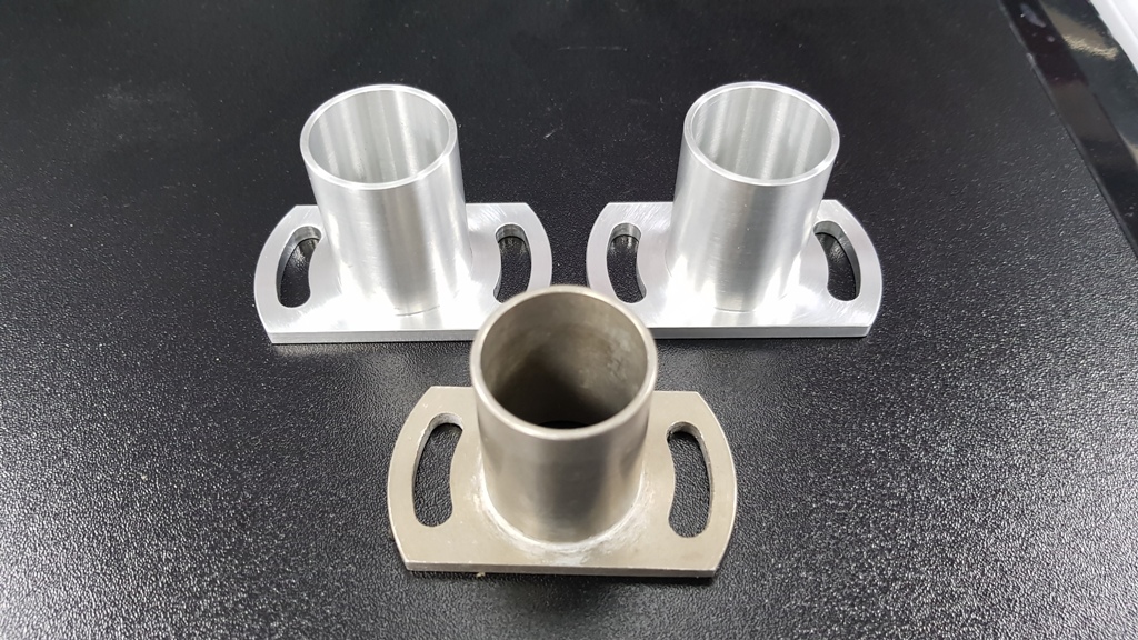

Don't worry Russ,
I have asked the engineering firm to make an extra, measurements will be available.
Hope to also get the correct adaptor mounting height measurement, which as Jeroen has mentioned is crucial. The silver paint should have worn down by now as an indicator.
The aluminium billet needs to be at least 46mm x 70mm x 40mm (ish)
If that helps you get a pricing estimate.
With a bit of luck next week, should have the adaptor back.

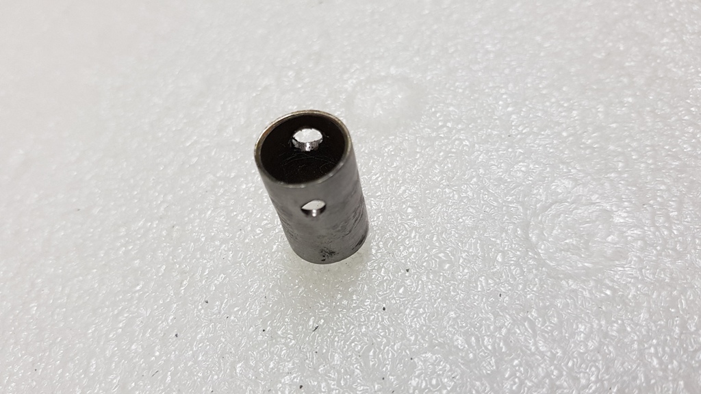

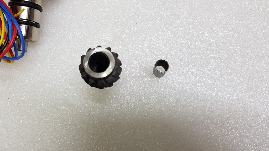

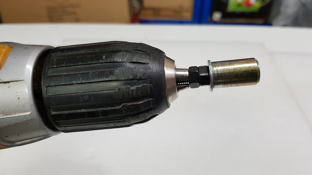

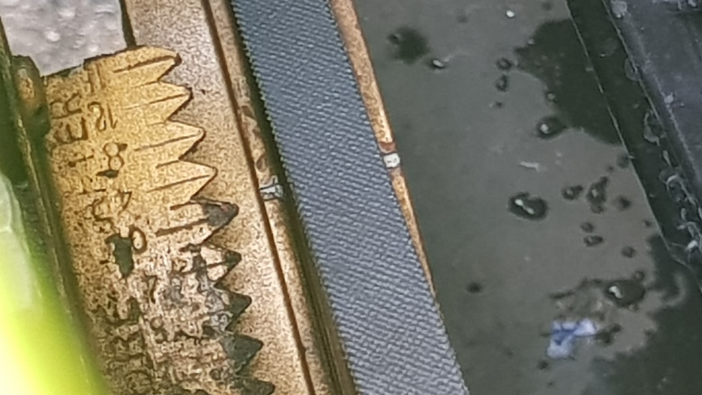

In the meantime I have filed down another bush for the drive gear., a bit longer this time, and better done,
I could really do with a mini lathe.
the adaptor I asked for by this coming Tuesday.

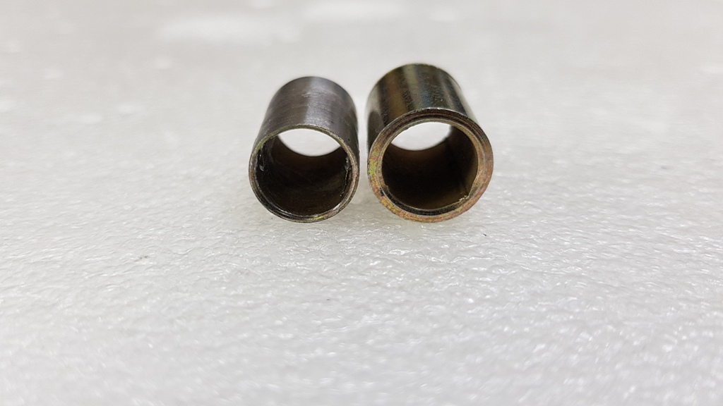

Just thought I'd put a picture up of the closeset dimension off the shelf bush, and the diy reduction job next to it.
The cloning/breeding process seems to be a success,
will know for sure after fitting,
at the moment it seems like
a perfect copy when offered up to the original.

Unfortunately a good chest infection over Christmas had slowed down the works, however its now time to
remove the 123 from the car.
Set back to default, and removed the 123.
The silver paint has worn of in about the right position, with the adaptor in place is should go in about right.
