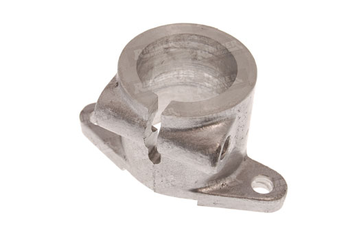

This is the housing fitted to the gearbox if that narrows it down ?

Re: Gearbox change
This looks like an adaptor ring, according to the sprint workshop manual (33.35.07), the slave cylinder has a built in flange, so your flange is made to use another slave cylinder of similar performance, but bore sizes, travel and master cylinders need to be matched for fluid displacement.

Re: Gearbox change
That slave cylinder only does the 1850 and sprint,
My car is a 1979 1500hl, the slve cylinder on mine pushes into that bracket and is secured with a pinch / lock bolt .

Re: Gearbox change
Indeed and those brackets and slaves are not all the same...
But they all have the pinch bolt and groove so look interchangeable, but they arent.
