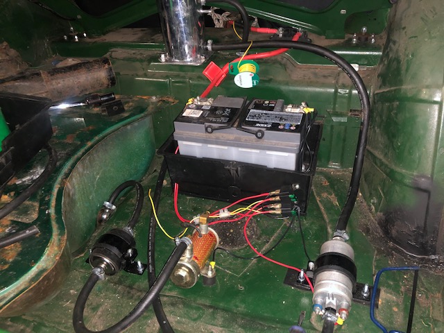

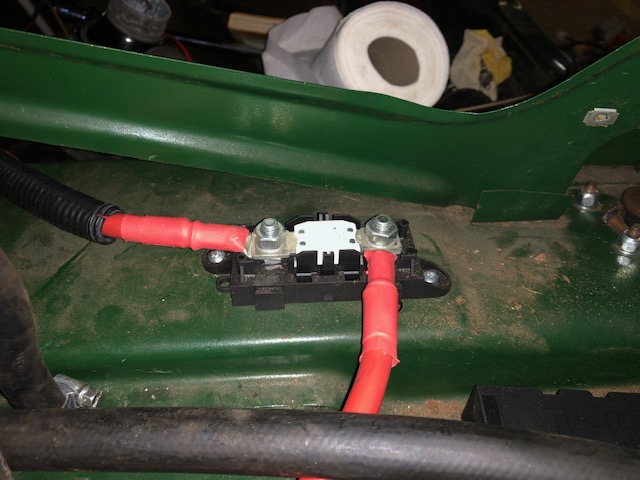

I used self-tapping screws to fix a busbar to the underside of the heater matrix, just behind the vents. This has 6 rows of 3 x 6.3mm male spade connectors. I used 4 x 3 rows (1 input 11 output) for positive and 2 x 3 rows (1 input 5 output) for earth. In hindsight, I could have used my old fuse box instead ! This powered other components like the boost guage, oil pressure gauge, Nissan ECU, Kenlowe fan switch, tacho convertor etc.
The battery has been relocated to the boot. The thick positive cable goes straight to a 175A fuse for safety. When everything is running, I’ll measure the current with all lights on etc while cranking the motor and reduce the amp rating accordingly – 175A is probably way too high. The thick cable is connected to the starter terminal which spurs off to the alternator and an ignition side inhibitor switch.
I’ve now got 10 fuses in the engine compartment for battery side power and 6 fuses in the passenger compartment for ignition side power. I also moved the club voltage regulator next to the ignition fuse box to reduce wire length again and to keep it dry.
Close to the engine compartment fuse box, I’ve got 4 relays connected to the battery side fuses :-
- Horns
- Twin Kenlowe fan 9 inch fans
- Both dipped beam lights
- Both main beam lights
I’ve got 3 additional fused relays in the boot where the battery is :-
- Facet fuel pump that feeds the swirl pot
- Bosch 044 fuel pump that fuels the engine
- Heated rear windscreen

- ign fuse.jpg (84.52 KiB) Viewed 89639 times
- boot.jpg (113.14 KiB) Viewed 89639 times
- big fuse.jpg (109.07 KiB) Viewed 89639 times
- battery fuse.jpg (90.91 KiB) Viewed 89639 times

Electrics
I found a small device that converts the Nissan ECU tacho output signal to the same type of output signal as the standard Lucas coil, meaning that the original rev counter works !! I also commissioned a custom Nissan / Sprint speedo cable that allows me to use the original speedo.
As an additional safety feature, I fitted a brake fluid level sensor. I found a company that made me a small black plastic rectangle with the word BRAKE printed in translucent red. I swapped this with the FASTEN BELTS insert in the dash warning light and wired it up. I figured that I always wear a seatbelt out of habit these days and I don’t know if my brake fluid is low whereas I do know if my seatbelt isn’t on.
A common modification for the CA18DET is to replace the original spark plug coil packs with those installed in many Audis. They are supposed to be MUCH better than the 30 year old Nissan product. They are apparently used in R8s and some Lamborghinis - how could I resist !!
