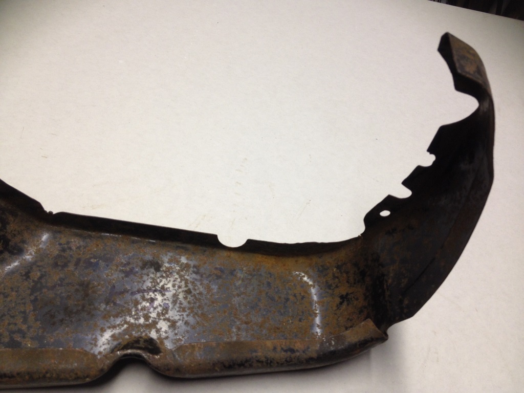

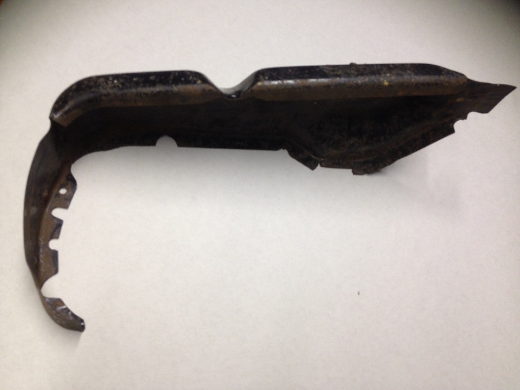

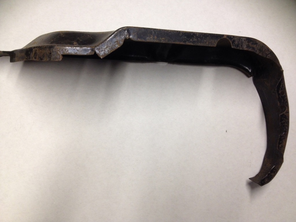

These any good for you? have tried to do them in your style......Failing....
I have a pair of them unfortunately they are for the same side. from Mr Ketley at £25 RIP.

Re: NWL – Project Concours Carmine Sprint
You could use one of these to replace or repair your NS one, or as a template to create a repair panel. Your OS panel may be ok, or if not, you could use one of these to make a reverse template for that side.oily66 wrote:I have a pair of them unfortunately they are for the same side.
