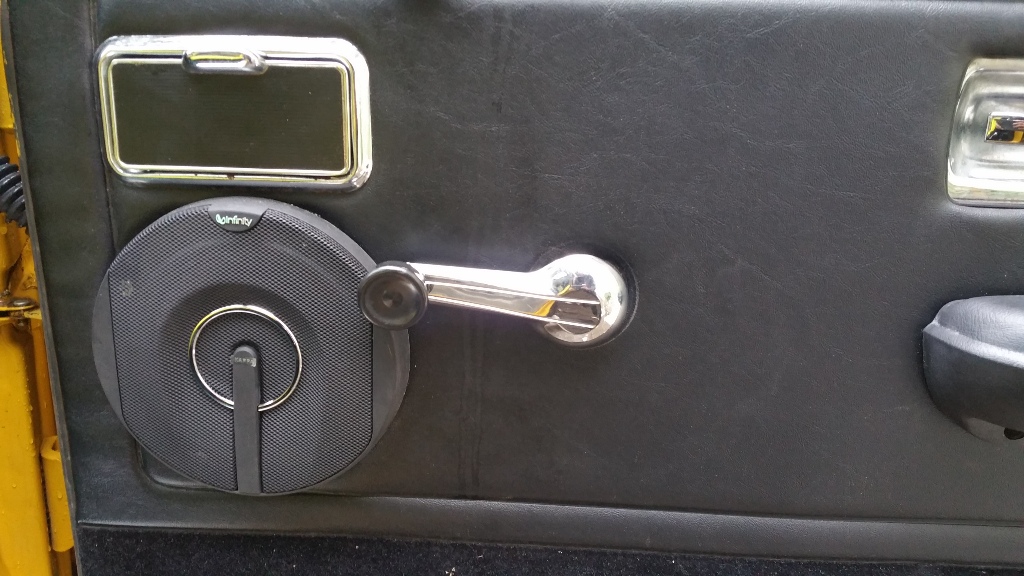

Oh well they are fairly common....so an e/window conversion for you then...
Or you could do a different speaker location like the trim under the front parcel shelf at the sides...

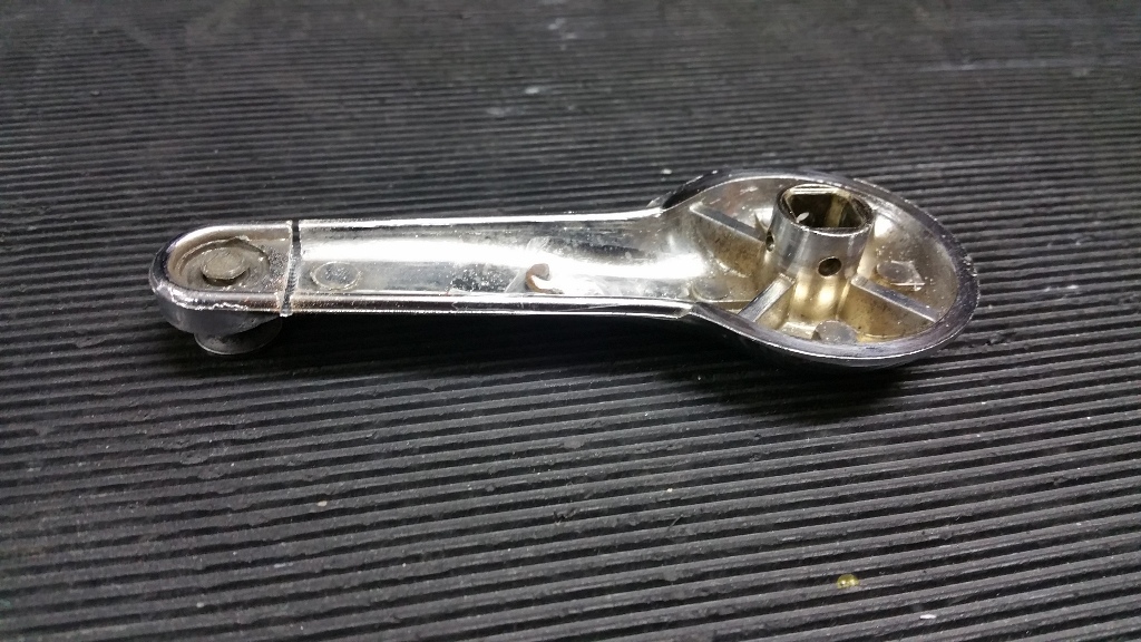

Needed a bit of rounding off,
Used a washer to marker pen the handle,
Unfortunately, I don't have a bench grinder and an engineers file is too slow,

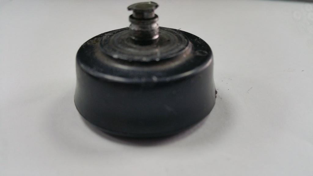

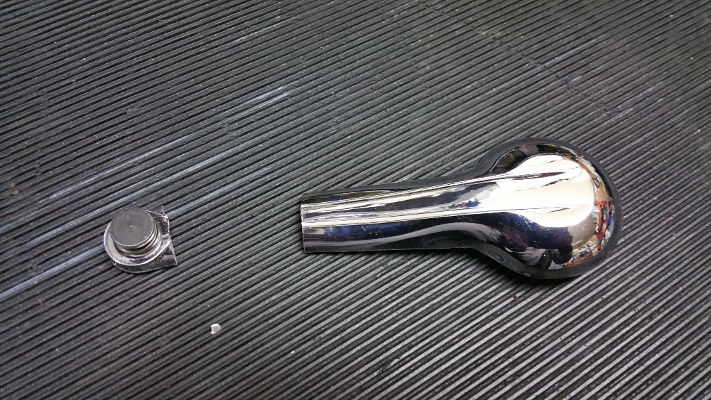

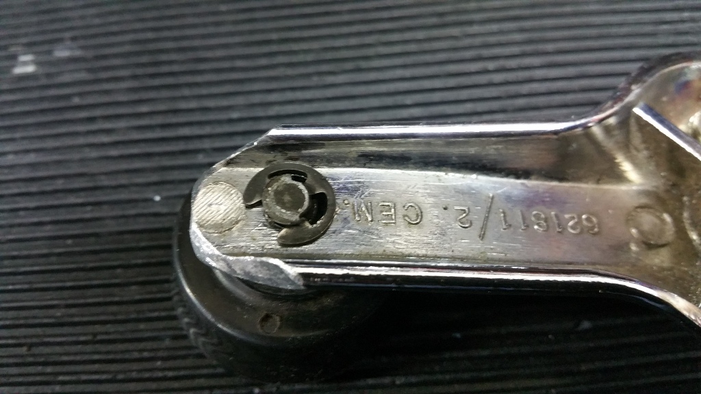

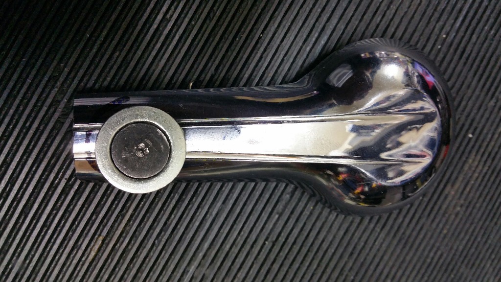

Getting better at handle chopping, second and last one, and therefore I encounter a problem,
The e-clip retaining flare did not survive the extraction in a good way and is flaking off,
Now either I heat up the shaft and hammer it, but the knob will not survive, or I drill the
shaft center and screw in a washer, third option get another handle and start again,
unless anyone can suggest otherwise?

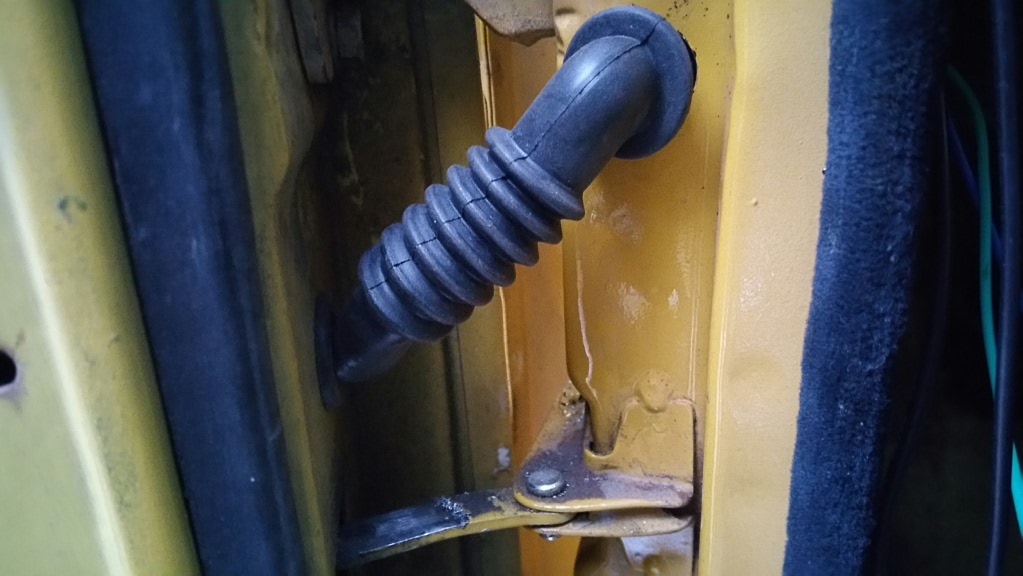

I have considered that, but the handles do look nice,
If electric is done later, I will use the existing plastic escucheon and put in a
chrome toggle switch in the center, only prob is it means another door to frame
grommet which in turn means more holes.

Can you run a hacksaw cut around the groove and fit a smaller clip?
Can you drill a small hole through the spindle then put a washer on and a split pin or something of that type to secure and keep the rotation?

It's only two handles, I bought the door cards
with the cutouts from a club member (honest).
The front doors are the best place for the speakers,
unless you suggest otherwise (on the other hand
don't make a suggestion
) or was that the suggestion)

I'm ok for handles at the moment, was the Omega central locking individual electric solenoids or BMW type with a central air pump, just curious.
Door grommets can be a pain, door side easy, frame not so.

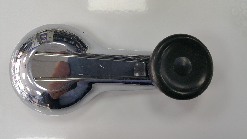

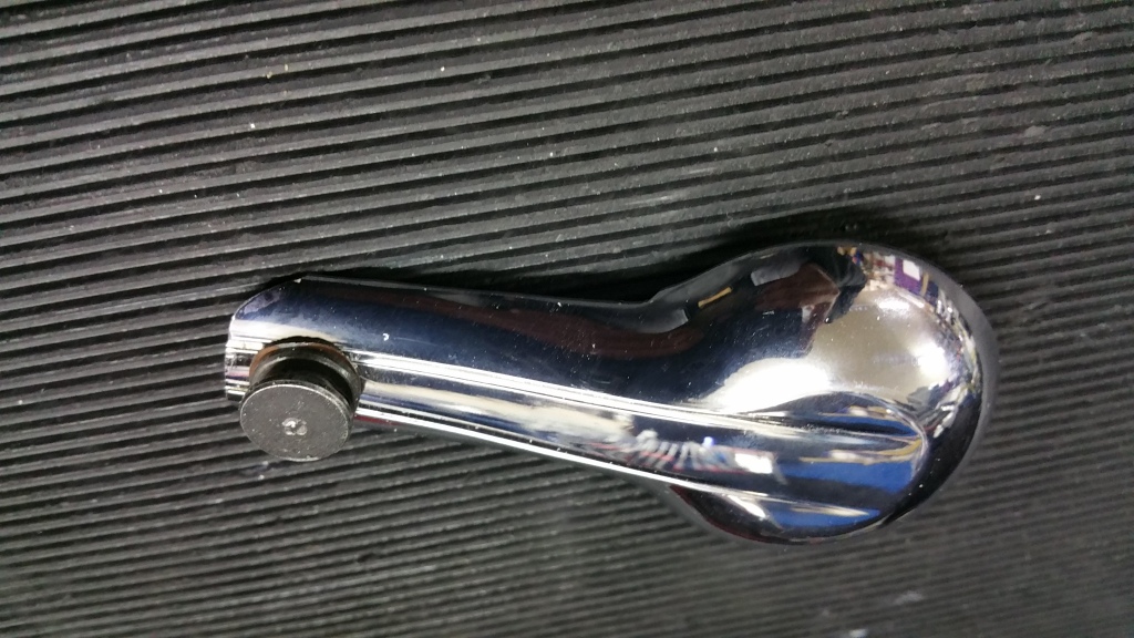

Gone with Tony's recommendation of another hacksaw cut, but I had to make the goove below the
original yet close as possible to the top of the shaft,
not the best of pics,
got an e-clip in, (original flew off) somewhere)
and the end result is a stubby originalish window winder handle,
Probably won't last that long.
