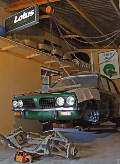

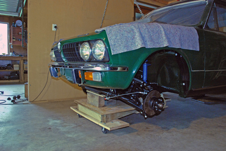

The project has taken a big leap forward following the installation of engine and gearbox all sitting on its subframe. I used the up and under method which I had trialled earlier and which has been used by others.
The car was rolled on its four dollies in under the hoist and the first step was to lift the car sufficiently which allowed the slave (1850) subframe to be unbolted and moved out of the way.

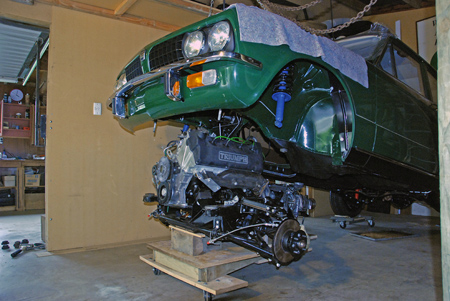

Then it was a simple matter of lifting the car higher until the complete engine assembly could be wheeled in under the car
20121127-3683Pw Engine iin position.jpg (134.57 KiB) Viewed 4359 times
and it was lowered down until the lower front shock absorber bushes could be attached. It was necessary to jiggle and rock the car a little so that the exhaust manifold bolts cleared the side of the chassis rails and at the same time it allowed the inner wishbone mounting points to move into their correct position, tucked up close to the inner wheel guard.
The two shock absorbers helped to guide the assembly down onto the subframe itself. The rear upper mounting rubber bushes were pushed up onto the tubes on the chassis rails and I attempted to do the same with the front upper mounting rubber bushes although they tended to fall off just at a critical moment so I left them sitting in the subframe. When the car until it was about an inch clear of the subframe I dropped the front bolts down through the front upper bushes and it guided the whole assembly into position.

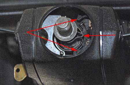

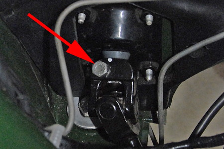

I could not persuade the upper universal joint on the intermediate shaft to slide up onto the bottom of the steering column. The workshop manual gave few hints although between the parts book and the manual it seemed that the upper universal sits with the clamping bolt at about the 9 o’clock position. I eventually pulled the steering column out of the car and sat it on the bench for I had restored two intermediate shafts, the original one from the car and the second from the donor car. Two bottom couplings had also been overhauled and fitted with new rubber bushings although only one has the earthing strap connecting the top and bottom halves. I used the one with the earthing strap in my car
Only one of the two upper universal joints seemed to fit the splines on the steering column and by carefully working my way round the steering column spline I found that it was in fact necessary to fit it at the 9 o’clock position.
20121201-3692Pw Upper steering universal.jpg (51.35 KiB) Viewed 4286 times
I worked it up and down the splines a few times in order to remove any burrs or rubbish in the splines themselves and then marked the position with a couple of dabs of typewriter correction fluid. I did the same on the bottom coupling. Then making sure that the steering column was locked with the tab on the column midway between the left and right indicator releases,
