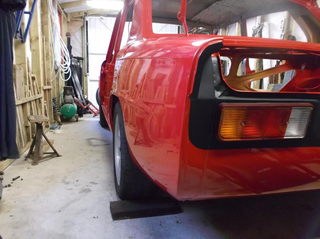

Seen these and loved them

#62 Post by soe8m »
I like this type of rearlamps.

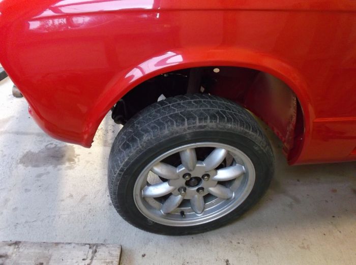

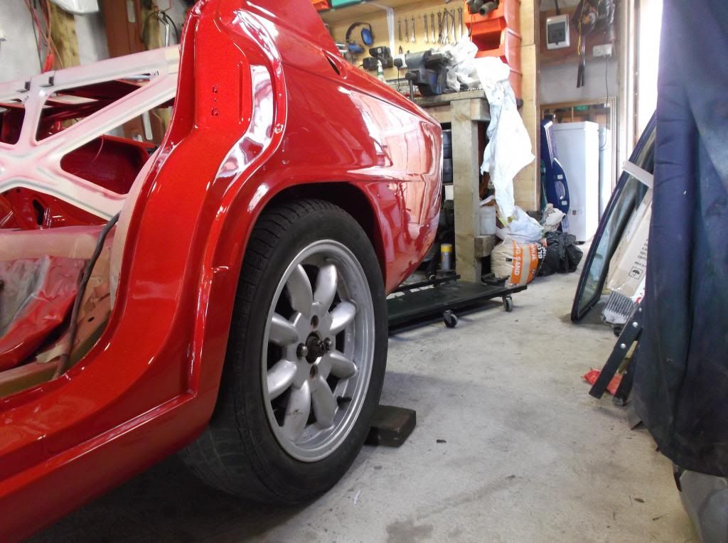

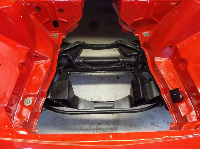

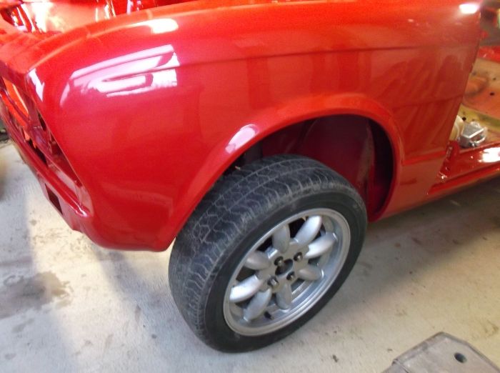

Subframe on
Back on its wheels
Hopefully get the back axle on tomorrow.

Looking gorgeous!! Gonna be fantastic when it's finished!! Very inspiring !! Keep the updates coming!!

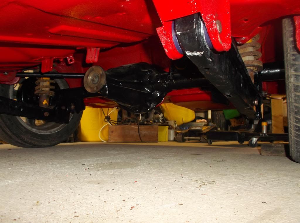

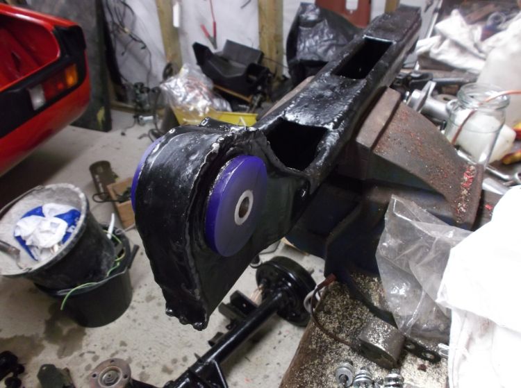

Had a crap afternoon on Sunday, the car came with Polybushes fitted to the rear trailing arms which I stripped out to have the arms refurbed, when I tried to refit them I could not get them in enough as they are the type in two halfs, this meant it was impossible to fit the arms to the axle.
So I have ordered Superflex 'Cotton Reel' type bushes, it really is a false economy using cheap copies, I wasted about 3 hours messing about .
When you have a freshly painted car the last thing you want to be doing is using a crowbar & hammers to make things fit.
So hopefully have another go this weekend.

Still struggling with these trailing arms, the Superflex bushes arrived but seem to be impossible to fit using the vice, so will need to find a friendly garage with a hydraulic press to get them fitted, or has anyone on here got a press in the Hampshire area?
Reg
Posts: 1264
Location: Darn saarf..
Re: MSO 662P
#71 Post by Reg »
Tony Burd wrote:Still struggling with these trailing arms, the Superflex bushes arrived but seem to be impossible to fit using the vice, so will need to find a friendly garage with a hydraulic press to get them fitted, or has anyone on here got a press in the Hampshire area?
Hi Tony, I had trouble with those in the vice too.
Try a long nut and bolt with two large washers..worked perfectly for me every time. :)

Hi Reg,
Good idea, funny I was talking to a guy at work about it today & he suggested the same thing, he used the same technique for bushes on his Mk2 Cortina.

Just tried it works a treat, still a bit tricky as the bush wants to skew, but as long as it is all lined up it pops in, thanks.
1st one in, 3 more to go!

Back Axle is fitted, no more polybushes to fit, hooray!

All nice and shinny paint work - shame the shocks and spring didn't get the same treatment.
