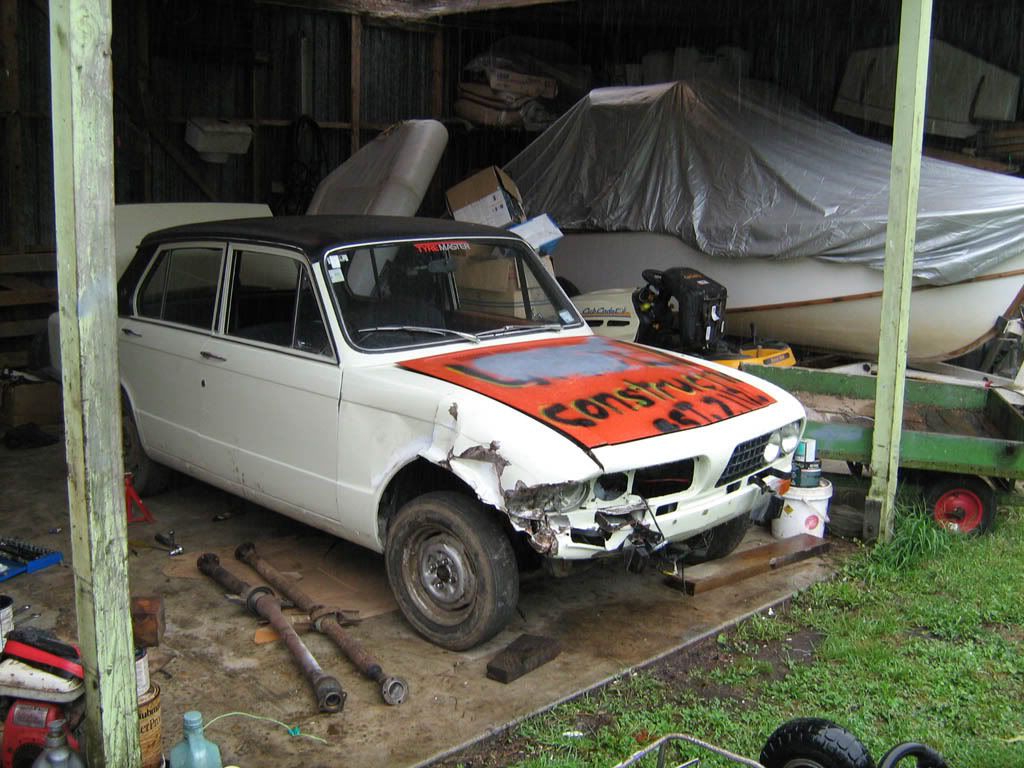

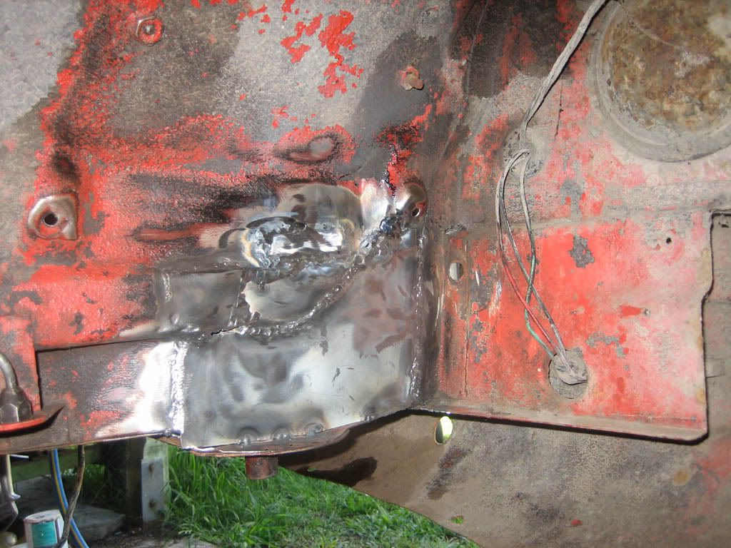

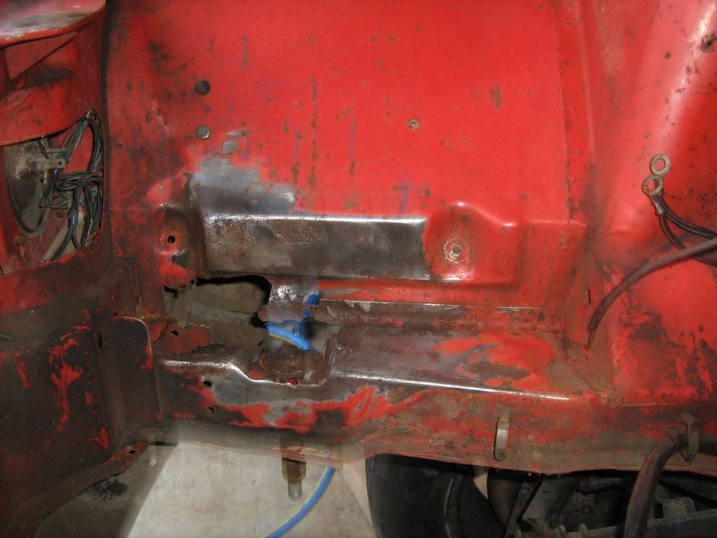

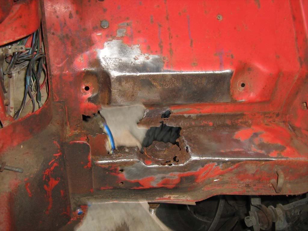

Welded up on the outside, chassis

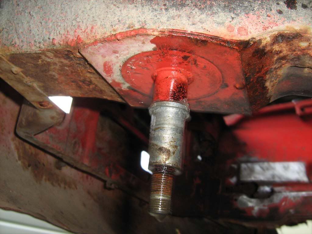

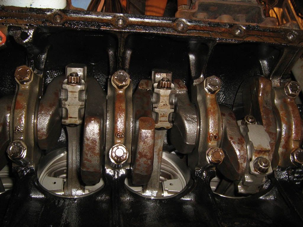

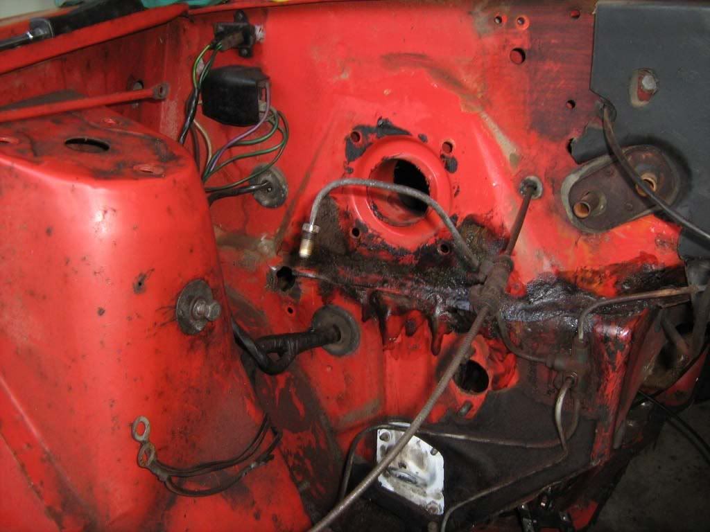

Stitched together from the inside

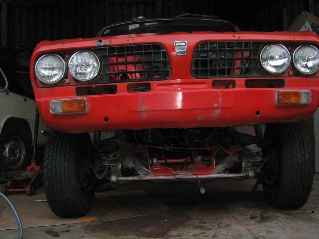

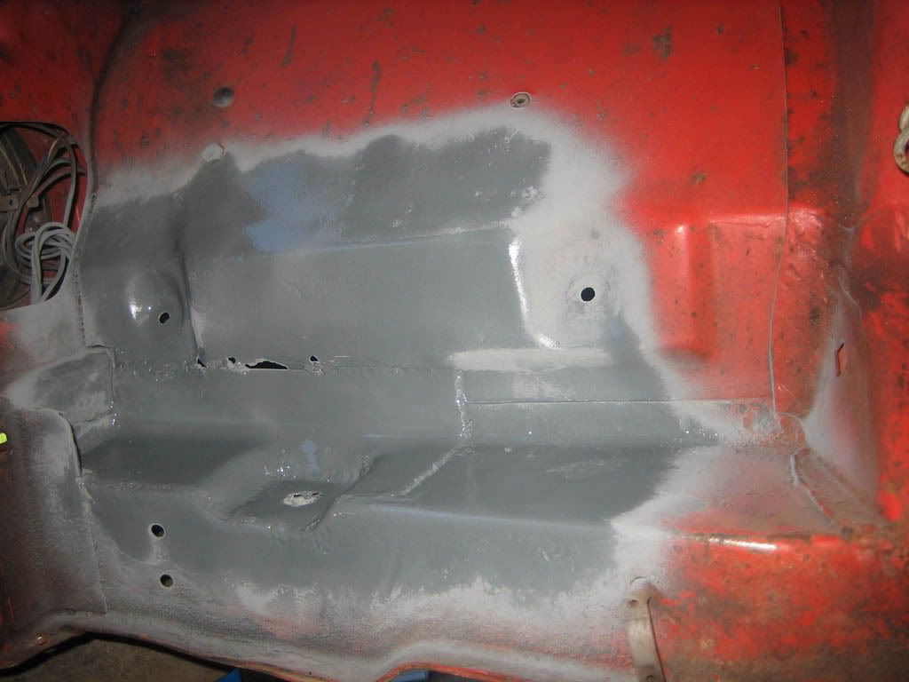

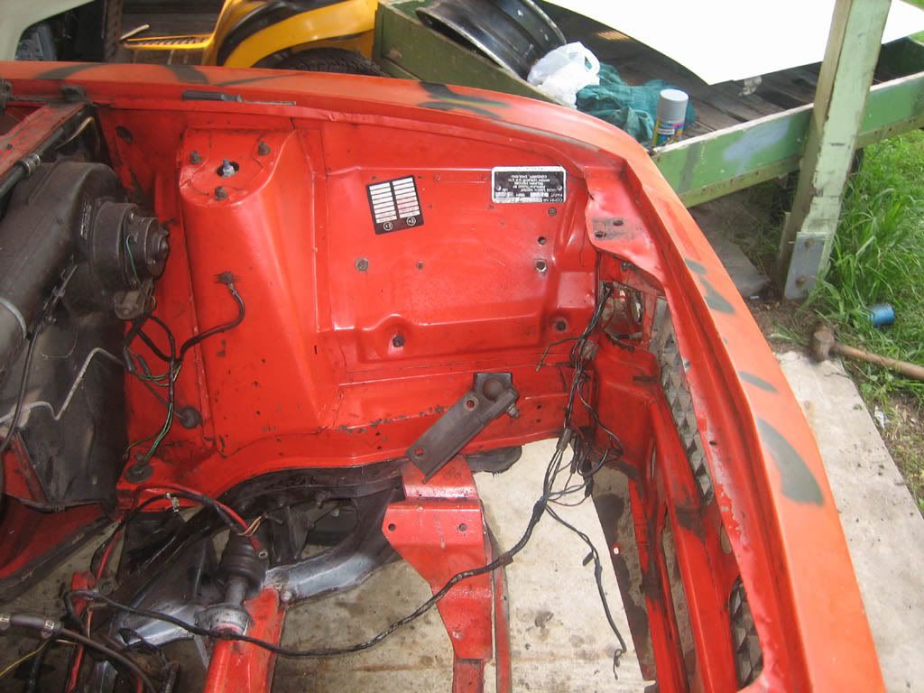

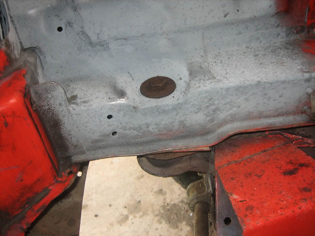

Primed Outside

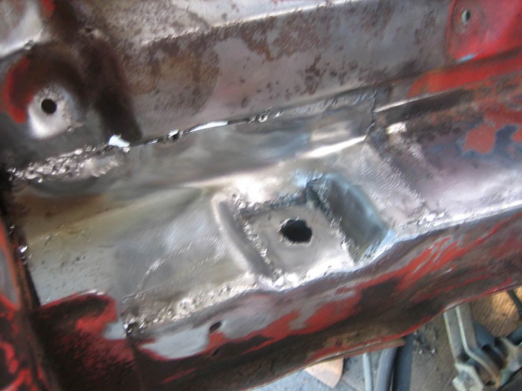

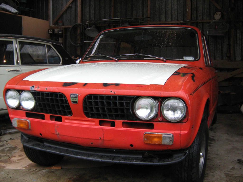

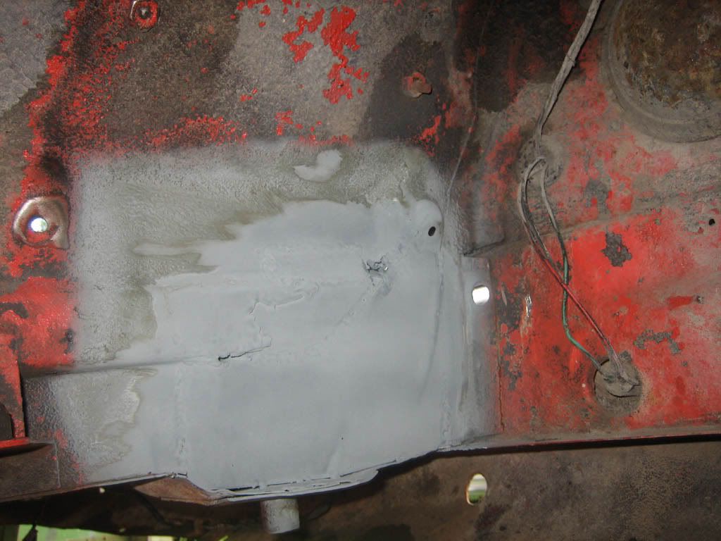

Primed Inside

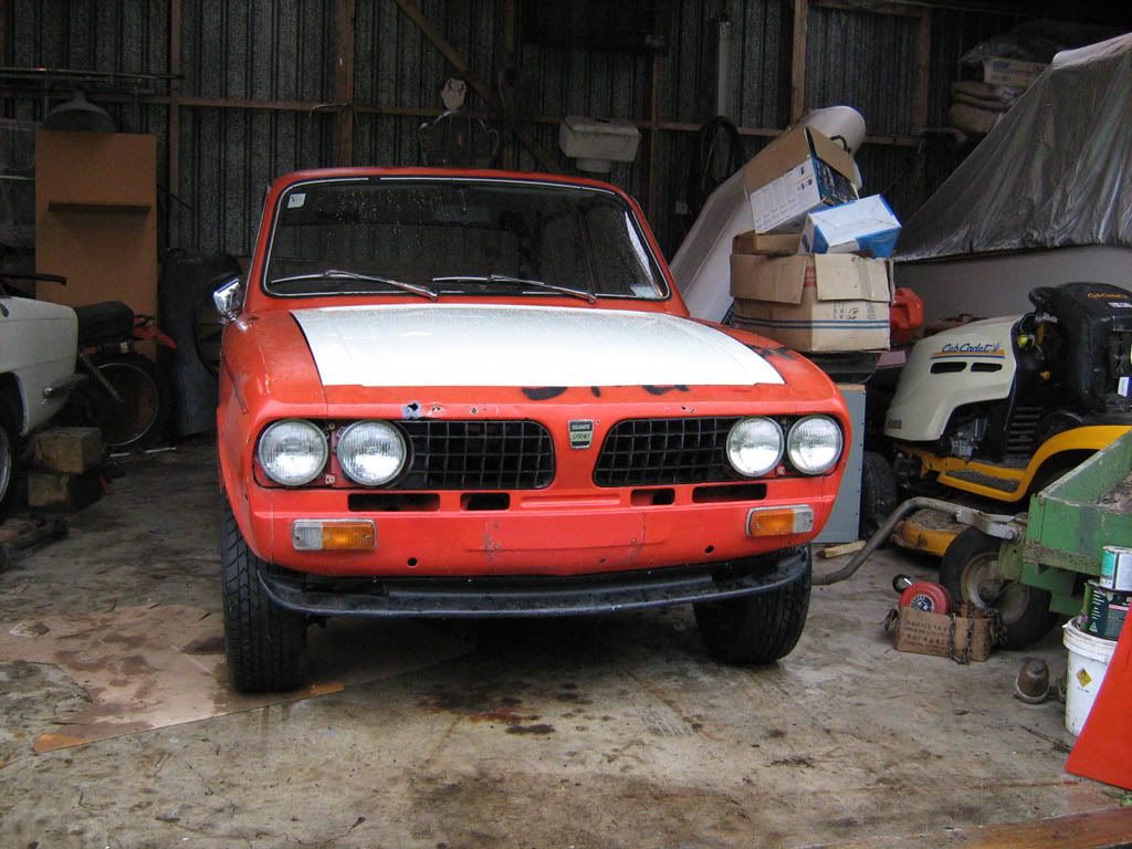

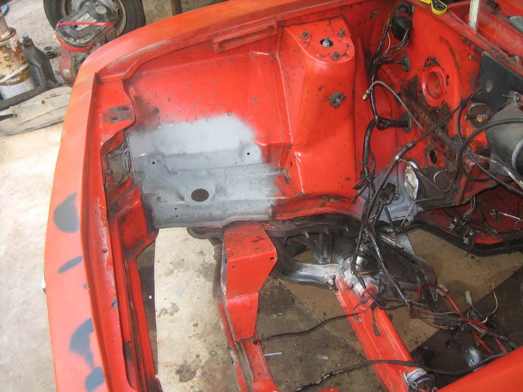

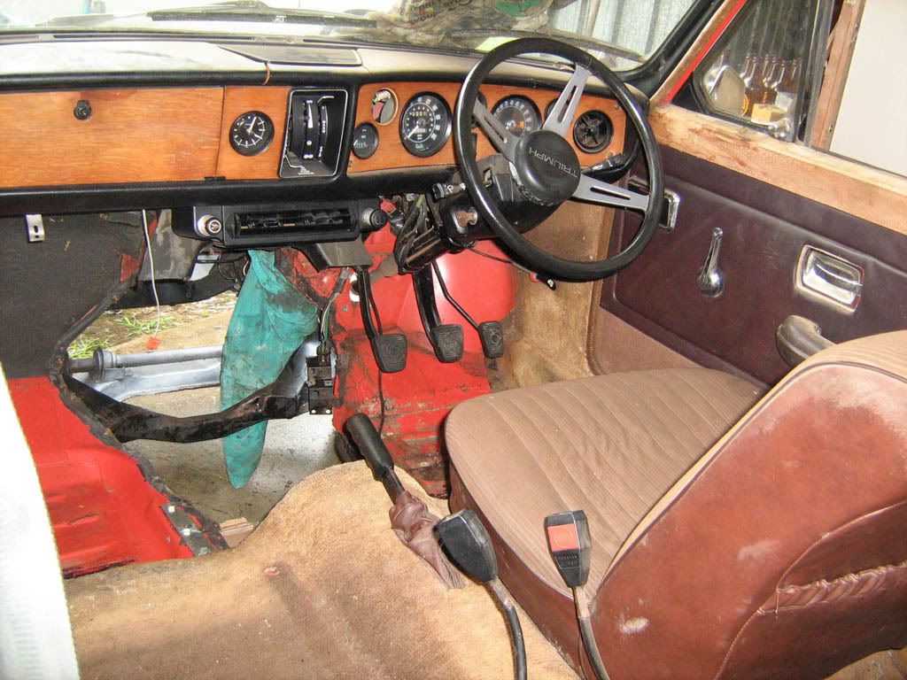

How its all sitting

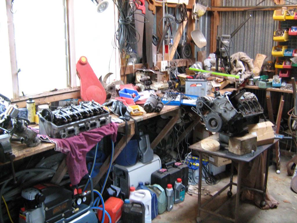

Cleaned engine bay
Was not to lazy tonight, got the torque converter off, flywheel and the insert that it bolts to.

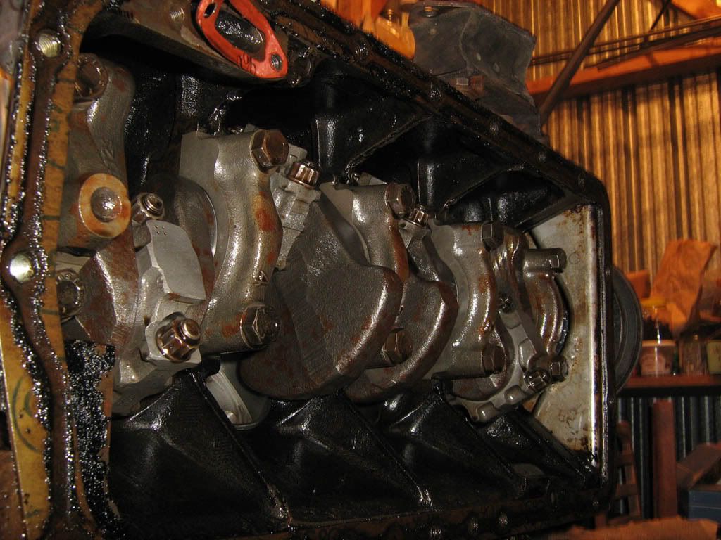

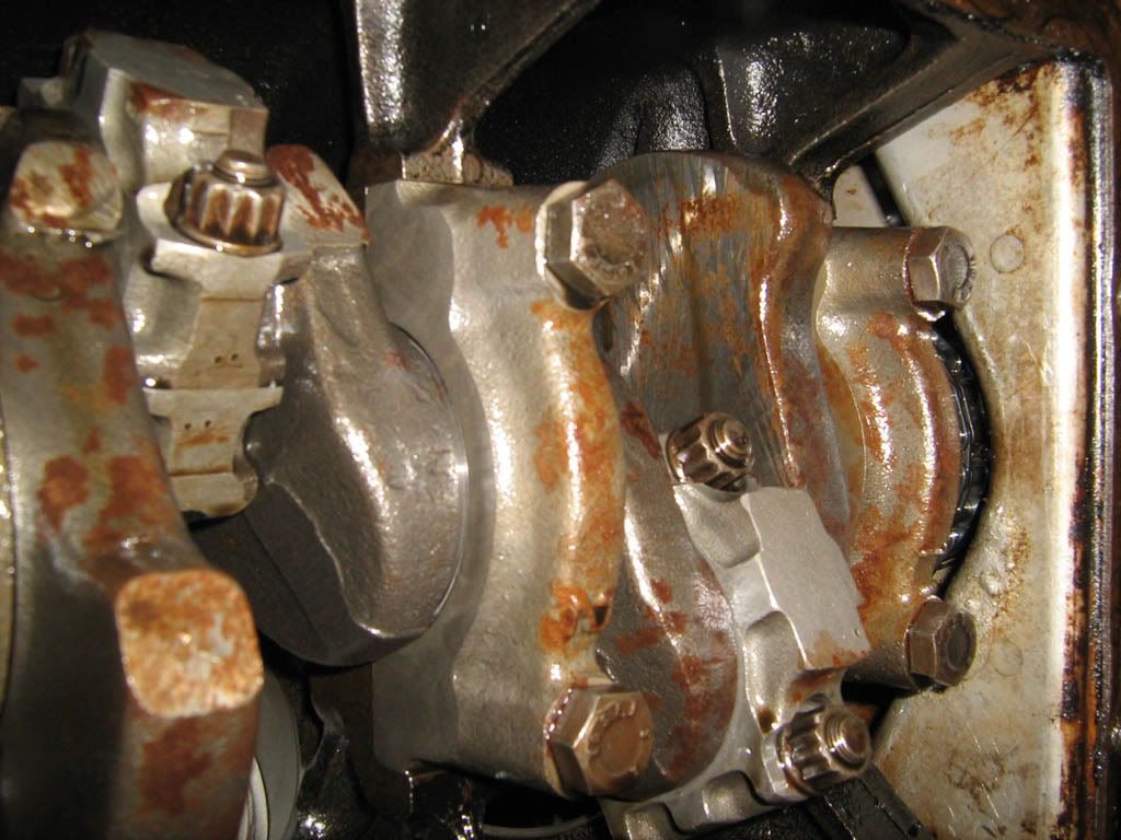

Also took the sump off, hoping to maybe find the washer i think may have fallen in the block.
I did not find it but i did find 4 small chips of plastic.
I can't think of what they could be??? Maybe something off my water pump or something?
