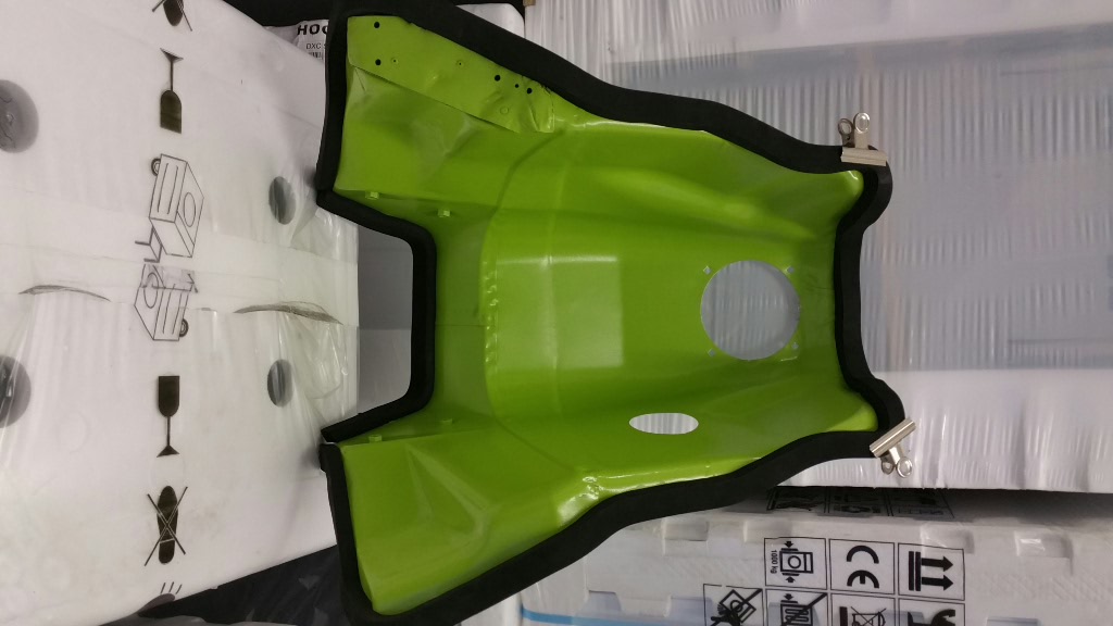

Inspired by Flyfisherman, I used a neoprene spongy seal, but in order not to break tradition, as always, overdone,
2016-06-03 20.39.26.jpg (85.83 KiB) Viewed 1314 times
25mm wide x 15mm thick, but it does compress down to 4mm.
Bulldog clips temporarily loaned from someone :)

#635 Post by GTS290N »
I like the bulldog clips.
No, seriously, I love that tunnel, brilliant improvisation it's awesome.
#636 Post by Jon Tilson »
My only concern is that you can force it down low enough to get the little studs to line up. I can see that seal being a bit thick....
Then of course you have to compress the front edge enough to pull the horizontal holes in to alignment. They are only spire clips and even with
the old seal Ive had studs snap off and spire clips give way. So best of luck with the refit....:-)

J nuts for the tunnell are pretty buckled to begin with, and I can only find J nuts in smaller sizes, U nuts (clips}
are no problem.
For the thick seal I have ordered some M6 U clips which should allow me to use longer bolts initially and then change
to shorter ones.

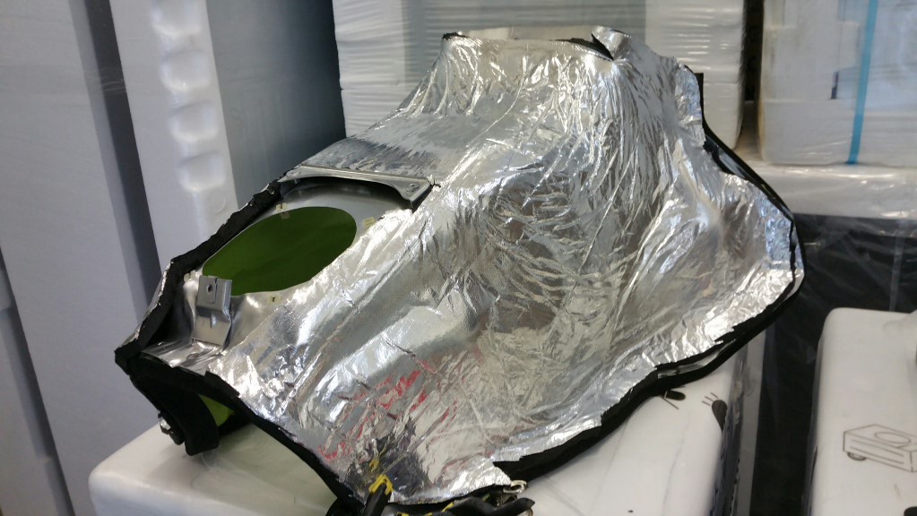

Put the glassmat on, still have to trim some,
2016-06-07 21.13.45.jpg (137.65 KiB) Viewed 1215 times
Looked better before

#641 Post by Pippin »
It seems a shame to cover up the mirror finish you'd previously achieved!
Mahesh
Posts: 1293
#642 Post by Mahesh »
I know, loved the previous look, but the carpet is inevitable.

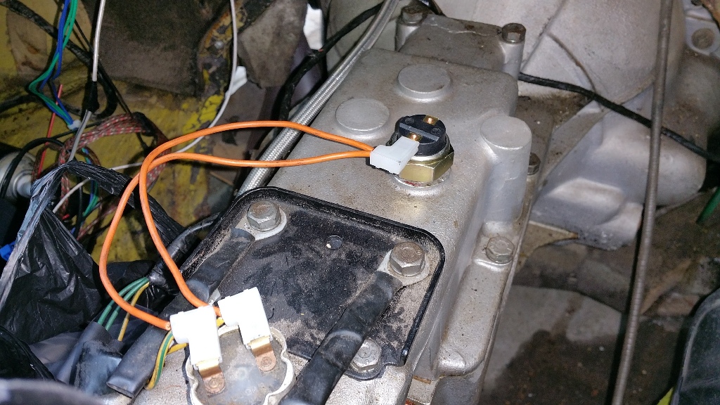

One of the tags did not survive the bending, other than a new switch solder is the only answer.
A small rubber cover with solder should suffice.
shaunroche
Posts: 1054
Location: Northwich
#645 Post by shaunroche »
Is that a 2nd gear overdrive switch I see?
