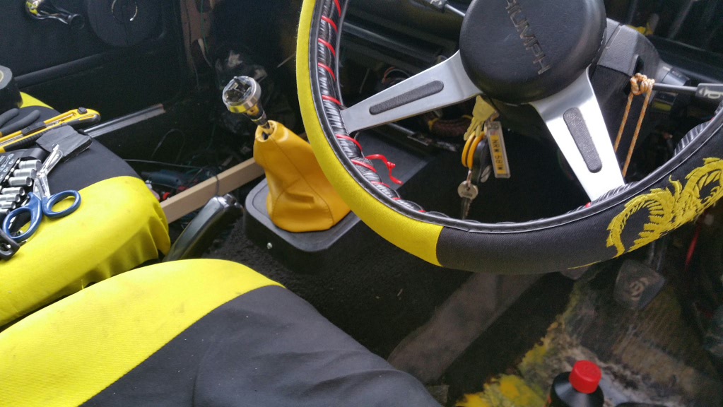

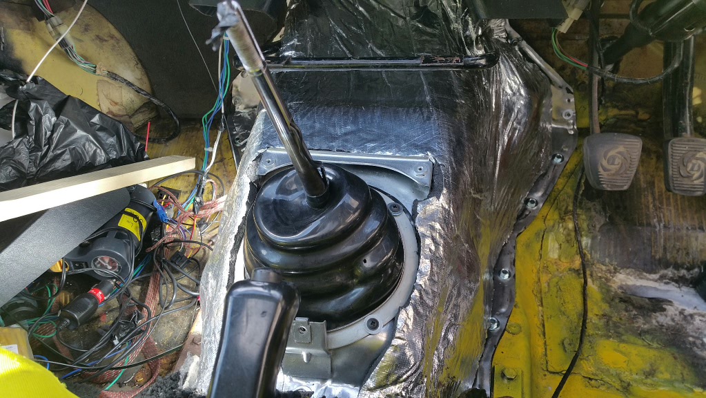

Got the tunnel back in, all but one spire nut fitted back in.
Had to change the neoprene seal to the thinner one, putting bolts and nuts from underneath the car is too much hard work at the moment.
2016-06-12 17.10.43.jpg (221.28 KiB) Viewed 1613 times
The extra bit of padding put in, and the rubber gaitor and retaining ring.
2016-06-12 17.10.59.jpg (213.49 KiB) Viewed 1613 times
Put the tunnel carpet on, with the new padding being a bit thinner, there's more carpet.
2016-06-12 17.11.20.jpg (141.85 KiB) Viewed 1613 times
#648 Post by Jon Tilson »
Err - isn't the hole in the gaitor where the o-d wires go?
Never mind....not worth taking apart now....
Next time.....:-)
Cracking job....I'm not surprised about the seal. You need the studs on the front bulkhead to pull the lot into alignment. Of course in most cases the poxy
small studs and nuts shear off.
Mahesh
Posts: 1293
#649 Post by Mahesh »
I did manage to locate all four studs, one needed bending inwards, but got away, secured all four with nylocs.
I was looking at the gaitor hole, but the o/d cable is non std, and I have left slack.

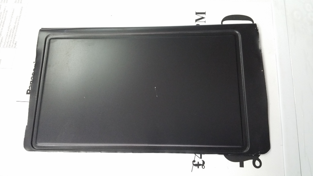

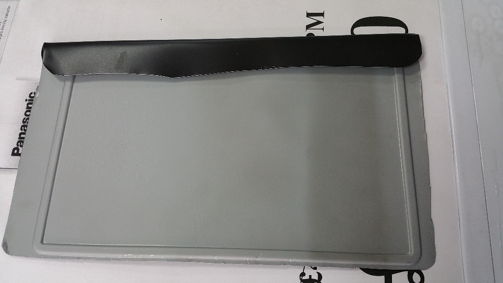

Managed to cutout the backing board (tin) for the two new fuse boxes.
The idea is to mount the two boxes onto the board and use the fold to clip it to the passenger side
of the parcel shelf, as opposed to making holes in it, a magnetic strip stuck will allow easy removal
and stop the rattle.

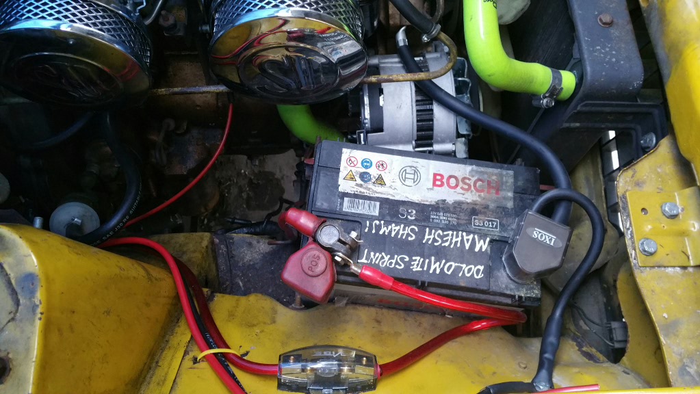

Only managed to change one battery terminal,
2016-07-09 20.51.11.jpg (163.17 KiB) Viewed 1390 times

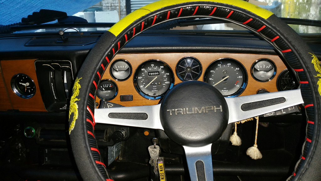

Managed to fit the parcel shelf back today, and even cleared the seats of tools and bits.
Also put the dashboard back,
2016-07-14 21.00.22.jpg (199.21 KiB) Viewed 1291 times
Took the car out for a spin, and I must say a Sprint is very forgiving in 3rd and 4th gears.

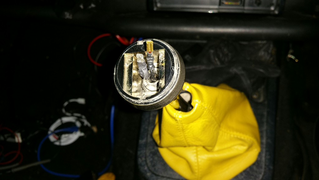

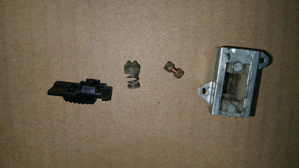

Put the new overdrive switch in, and it's faulty, bought brand new end of last year and it does not
make a connection between the two points.
Also when in place it does not slide up or down easily as it seems to be a bit larger than the old one.
I wanted the old switch namely because the in/out writing is engraved in and filled in with white, as
opposed to the new one which is merely white print.
Best option, refurb the old switch, took it apart,
2016-07-16 09 14 50.jpg (229.77 KiB) Viewed 1262 times
Simple design, no wonder it lasted so long with so much use,
a quick clean in the ultrasonic cleaner,
The plastic ends on the spring can easily be lost, ( done it) found it)
All put together and back in the car, works a dream.

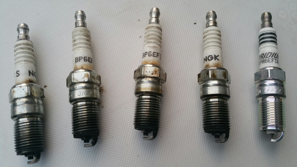

This evening I changed the contact set and condenser, much better, check the ignition timing, spot on.
Then I changed the spark plugs, looking at the picture the old plugs are not something to be proud of, but they are,
2016-07-23 20.49.57.jpg (151.26 KiB) Viewed 2084 times
The plugs are actually a bit drier then they went in, and in the same overall condition, normally would be dripping oil.
Hoorah for club alloy spark plug tubes and red rubber grease.
The fifth plug is one of the new set of NGK Iridiums, let's see next time.

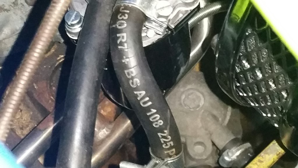

But every silver lining has a cloud, this particular bit of fuel line was replaced last year Oct,
