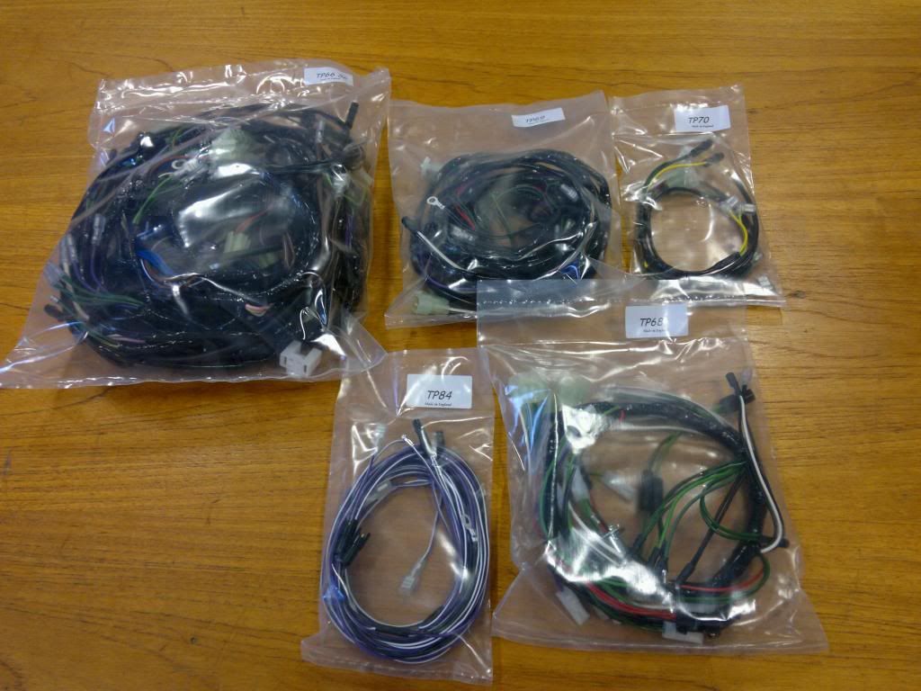

Box arrived at the office today with my new loom in it. Definately going to need to do some homework and figure out how best to approach it but it does look good!
Just waiting on the remanufactured bulkhead pad then should be good to crack on.

The loom is pretty straight forward to install Mark. Get the bulkhead pad on first & then start on the loom, that's the way I do it. It's fairly easy to follow where each connection needs to go.

The main loom goes in best from the engine bay side.....iirc, but check the big dash loom connector goes through the big hole first...:-)
Posts: 7242
Re: Operation Orange - 1980 Sprint restoration
#83 Post by Carledo »
Jon Tilson wrote:The main loom goes in best from the engine bay side.....iirc, but check the big dash loom connector goes through the big hole first...:-)
Not in my book it doesn't! Though Marks new loom with its big headlamp relay box MIGHT make me change my mind!

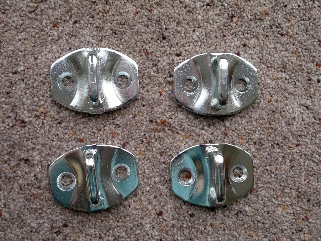

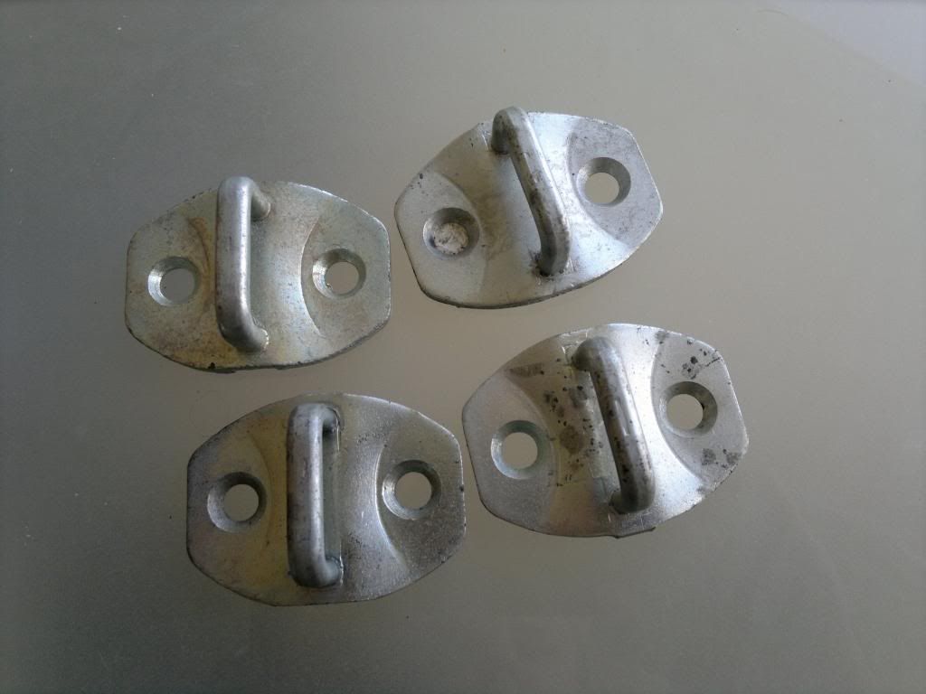

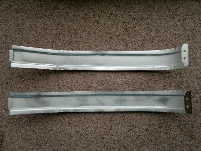

I decided that I had a few bits that needed plating. I wasn't happy with my NOS door catches or the rear door stiffeners which looked a bit tatty. With a platers just down the road I thought i'd give them a go.
Before
After
Door stiffeners were blasted and then clear zinc passivated. Originally they were sort of galvanised but this finish is more shiny

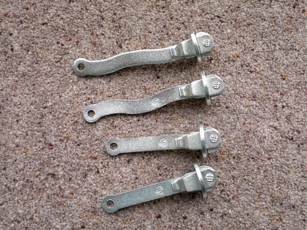

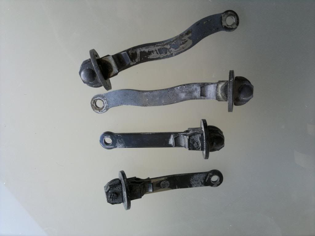

I wasn't happy with my door check straps either. These never got painted in Orange for some reason and they looked a bit crappy. They all got SPL'd and ended up e-coated. I actually don't like them painted as the paint comes off so for the moment I they too are clear passivated just like many modern cars. I might paint them, not sure.
Before
After
