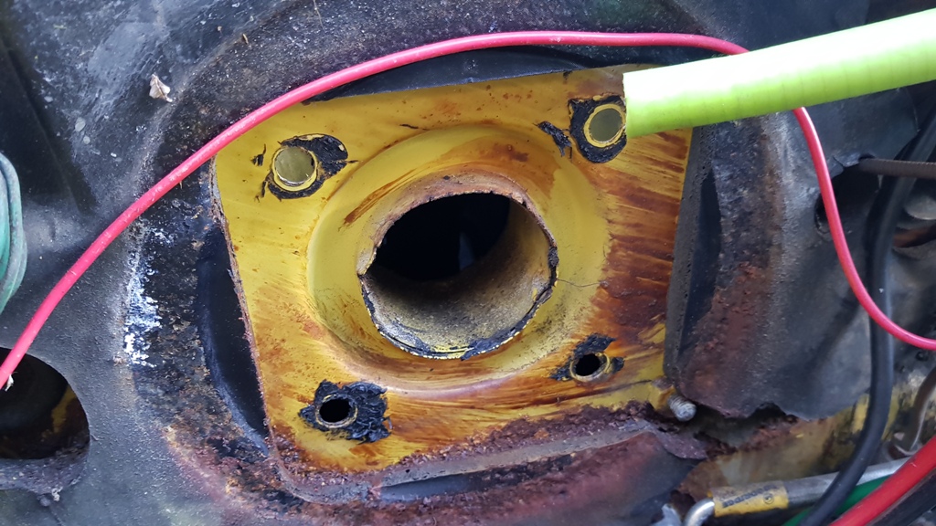

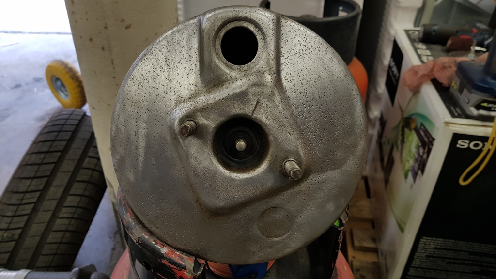

Took the brake servo off for a clean up and quick look, the bulkead
needs just a quick wipe,

Nearly there,

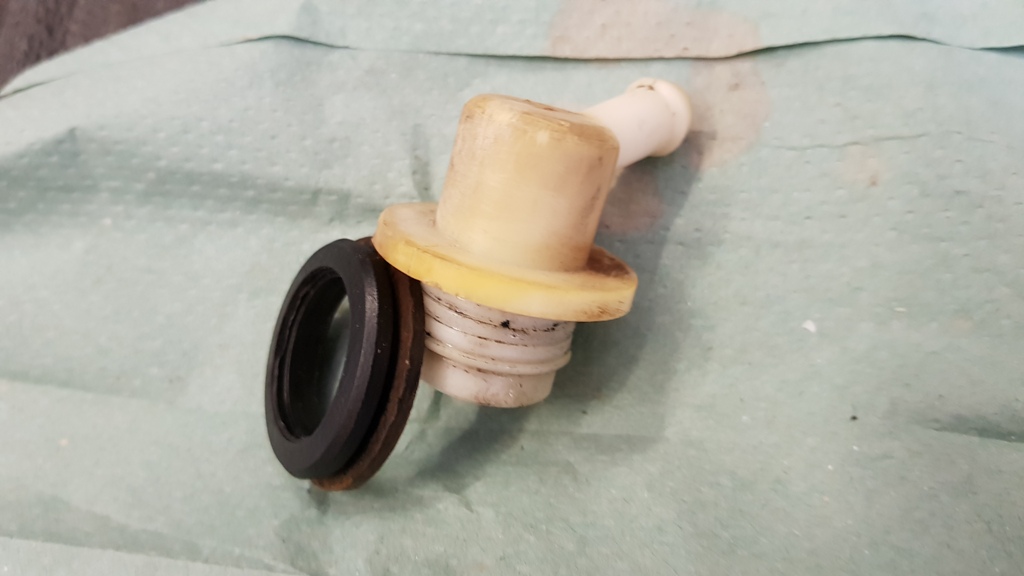

Ive got the same thing to overhaul the servo,how do you get the white plastic hose joint out of the servo ?
Thanks Dave

I carefully levered it out with two screwdrivers, had I known the design of the grommet, I would have just pulled it out by hand.
Will put a pic of the one way valve and grommet on tomorrow morning, makes more sense then.

Mahesh wrote: Thu Jun 08, 2017 9:24 amNearly there,
Hi Mahesh, How did you get that excellent polished steel finish from the rusty paint original please ? It looks great.
More than just a wire brush and a Black & Decker I suspect.
Thanks ,
Mahesh
Posts: 1293
#760 Post by Mahesh »
Thanks Tony, Ryobi drill and wire wheel brush attachment only,
it's a shame I cant do more to loose the pitting, just have to paint over.
And a pic of the one way valve and grommet,

Mahesh wrote: Fri Jun 09, 2017 11:07 am Thanks Tony, Ryobi drill and wire wheel brush attachment only,
Mahesh
thanks for photo,to lose some of the pits in the servo,try etch primer and then primmer filler before you put the top coat on,im going to try engine paint on mine,not striped mine yet that's a job for tomorrow :) :)
Just skim it with body filler to loose the pits.

Thanks guys, but only a simple paint over for now.
But while the servo is out, I might as well put in the throttle
pedal strenghtener from Alun.
Luckily for me, my bulkhead has a grommet in the third hole,
so no need to drill :)
I haven't put the pedal on the other side yet, the bolts are merely for
the picture.

have you got that plate on upside down ?

#765 Post by James467 »
Na he's cool.... and the plate's on the right way up. You can see it on RUK being an auto which is what the plate is based on I believe.
You can get the servo off without taking out the parcel shelf. However, if you have strong manly hands like me access is rather tight! :wink:
