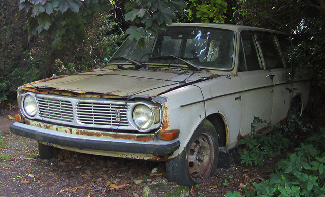

And a lot of other things to do. My house resto still not finished and this week it was get the 2500 running again. It was recovered from the UK and arrived last friday. My wife did drive the volvo for two weeks now and she and the kids don't mind but the rest of the world does. It looks about the same as this one but than in red.
