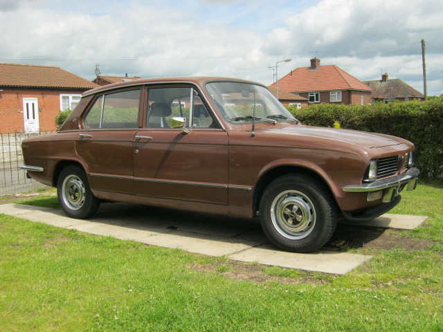

bit of bad news has come along,no`not selling car but brake master cylinder has leaked for second time in 3month,replaced to seal twice already,so----can anyone help with a good tandem brake master but pay at end of month? or exchange scheme
Where did you get the seal kit and are the bores bad?
I do have a newly reconned spare but am a bit loath to part with it.....
hi ya, got seal kit of ebay(jumblemaster) its leaking from the first seal nearest to the pedal
bare in mind it was stood for over 20 odd years so there was bit of crud in master,gave it a go with wet n dry paper to see if that help,but no
its off the car,in my vice and try another seal kit,it will either work or not,got to try something before buying new replacement
Have a really good look at the bore in a bright light. See if you can see any small pits that you could hone out with
1200 grit. Also have a close look at the failed seal.
Should tell you if you need a new one or not....worth a try though I agree...
few spot inside bore,mainly at the front used some 1000 then 1200 and marks have gone,new seal kit went in with red seal grease,all fitted back in car,bleed the brakes
hoping it will last til end of month then i might to bite the bullet and get one from the club,hope not cos ive got 5 spitfire wheel in essex that need transporting up somehow
The pits will be it then...
Should have said I use a pressure bleeder (gunsons easibleed) or sucker on mine so you dont have to move the pedal.
Its the pedal travel that wears the seals....I've often had master seals let go on a brake system after bleeding the usual way.
I started using a vaccuum sucker recently made myself from an old battery hydrometer with a squeezy bulb. Works a treat single handed and no need to pump the pedal at all...so minimal wear on the seals.
been out and about today 40mile round trip(stop n start) no sign of leaking and brakes feel good
Result....
Long may you run.....
NOPE
not worked,still leaking after 2 new seal kits,so new tandem is on the cards,end of month
well its sorted,,got a second hand non-leaky master cylinder of andyj(huge thanks) bolted it up saturday afternoon and re-bleed the brakes,all working great,brakes are bang on
