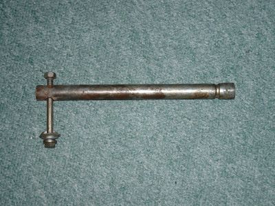

I actually used this:-
But mine had been soaking in plus-gas overnight. If it had been in any tighter this tool wouldn't have shifted it.

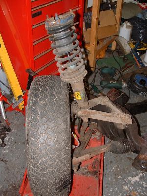

I braved a cold garage today to get the rest of the Sprint stripped out. Removed the exhaust. The tail pipe has rusted through, the box under the passenger seat looks pretty new but the bracket that the rubbers attach to has come off & the other box looks ok but is very rusty. I also removed the prop shaft & gearbox. That's about all I can do for now on the car except I need to make up some casters on a frame to go on the front, so that the car can stay mobile & I can get on with stripping the front suspension whilst it's away.
I've honed the bores of the engine block & they are fine so I can start buying some bearings & stuff and get on with rebuilding it. Happy days! :D

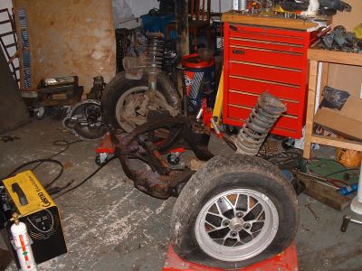

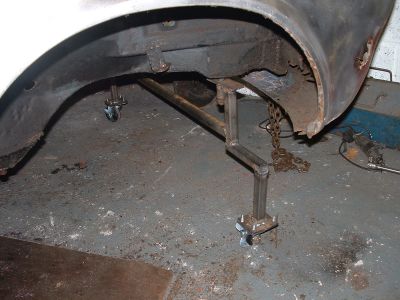

Went out first thing this morning to buy some box section, some flat section & some castors to make up a frame for the front. Took most of the day, what with running out of gas & my welder only wants to feed the wire when it wants to. Anyway, I finished the frame so was ready to drop the subframe assembly out. The rear subframe nuts were really on there but with a little persuasion from a 2 foot breaker bar, they were off.

cracking along then Mart ! Great stuff, If you get a chance it would be good to see how you've made up the frame.
<edit> sorry, must be going blind, Just seen the frame on castors in the pic, supporting the front of the car, any tips ?
