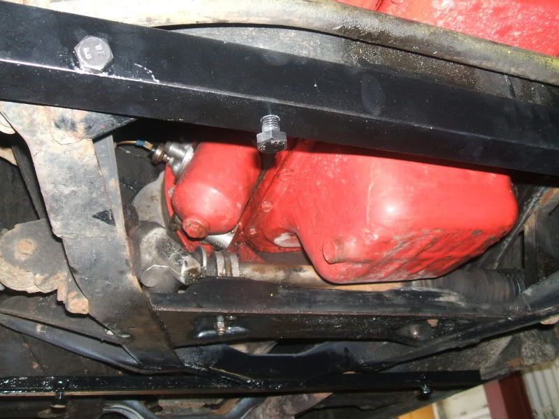

All i need to do is sort out the sump guard mounts to protect my newly rebuilt engine.

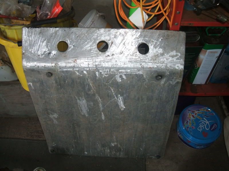

so i go hold of some 2x2 angle and some 1x1 angle and set to
and replaced the old sump gaurd with the new one ive made

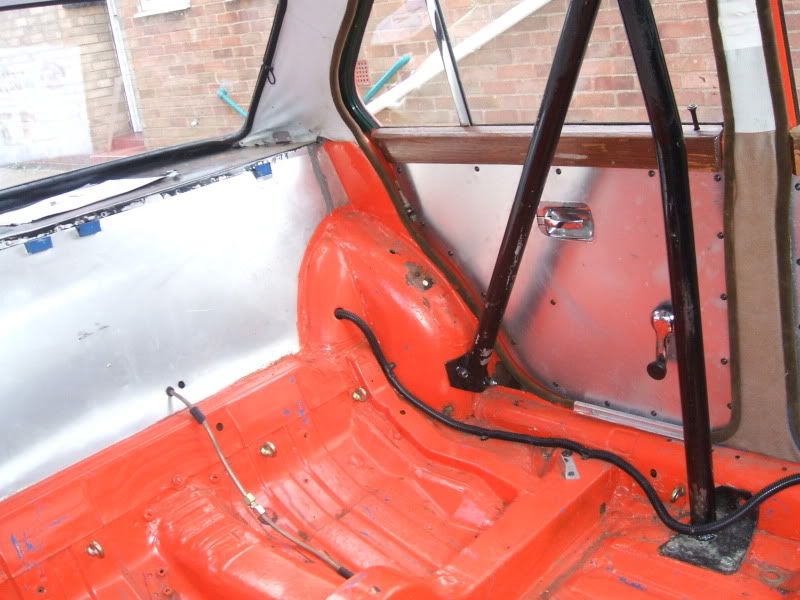

ive allready got a half roll cage fitted and a firewall behind the back seats, here they are fitted to my old car NGL544R
Ive also got all my fuel and brake lines routed inside the car as I had in NGL last thing you need is to rip a brake line off!

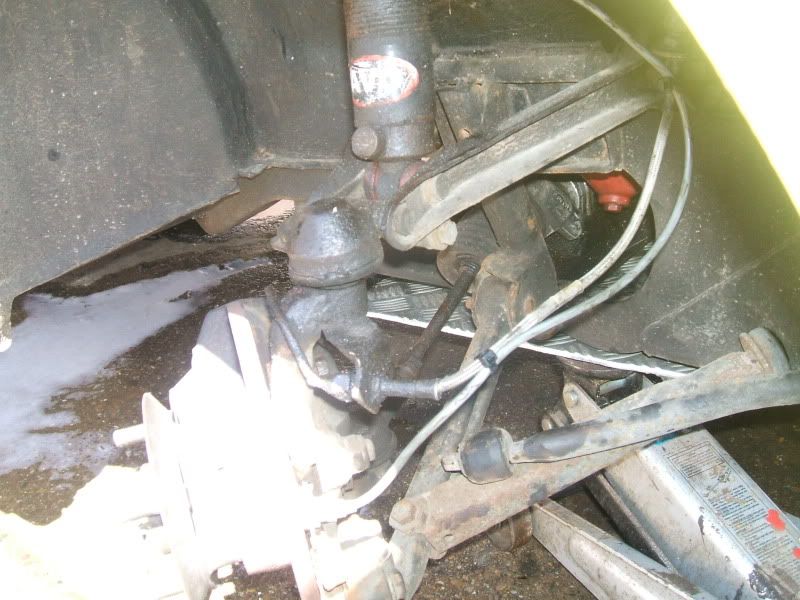

I fitted a tripmeter to NFX last week to help us on the important regularity timed sections
think you can see the sensor i welded a bracket the the stub axle base and removed the brake dust guards to let the heat out and stop some brake fade,i fitted the EBC uprated disc and pad kit last year i would recomend it and the braided hoses.

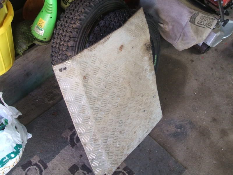

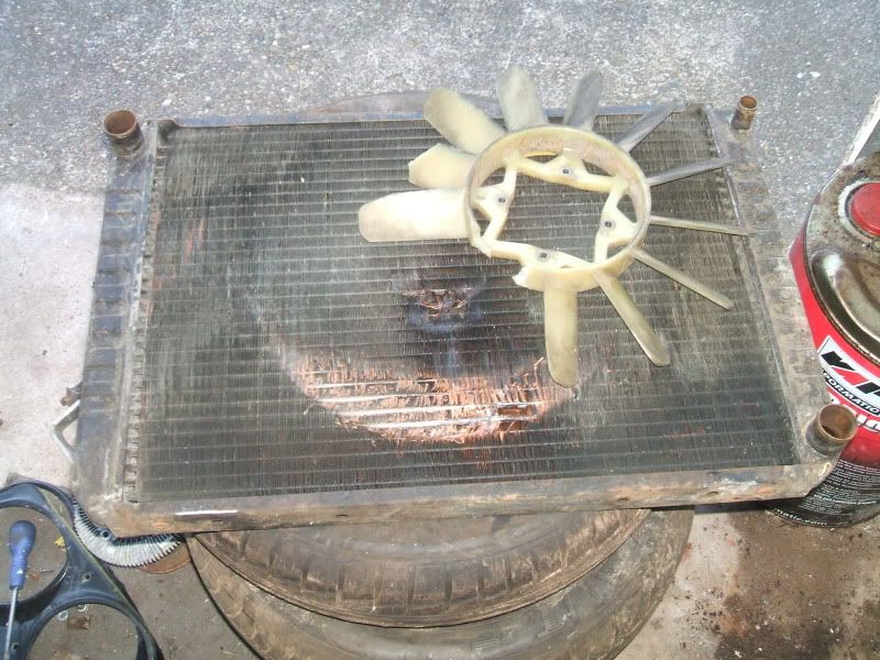

So ive been busy mending the carnage aused by the Viking event remember this
well it looks like this when its raked out not pretty

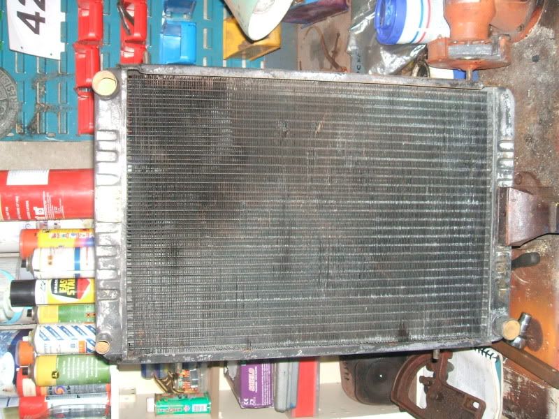

So i managed to find a replacement TR& rad from Macleesh
so ive cleaned it and the new fan up and NFX is back up and running,finally some comfort i can put the beetle back in the garage
