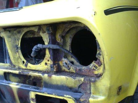

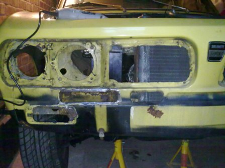

Today started to strip the front, the bumper did not want to come off, thought it was gonna be a grinder job, but it gave in eventually! Lights revealed the mess behind, though seem to remember those being club item?

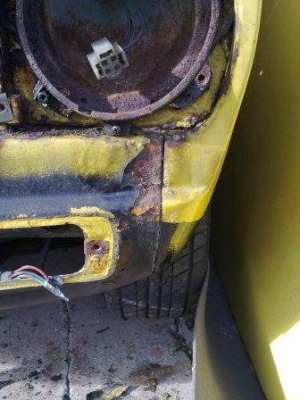

Front wing lower.

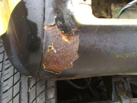

Suspect sills,

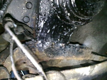

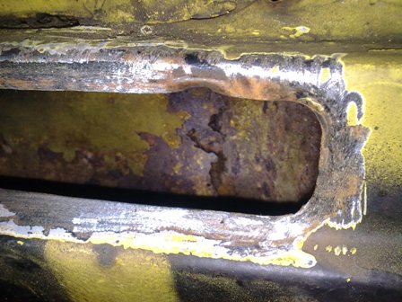

Been looking at the front panels on the sprint,i reckon the outer one can be salvaged, but not sure about the inner due to the surface rust. Wondering what is best way forward. Looking at the inner panel, its had a patch welded over some corrosion at the point where the bumper brackets bolt through. This patch is now shot and i'm wondering the best way to repair?

If this were mine, I would:
Remove the front panels and utilise a pattern or perhaps, even better, utilise of of Alun's glassfibre repro front end panels. Have a look at Project SE for what I removed and refitted. Worth doing IMHO.

The second picture suggests to me that you are looking at a full restoration, which is obviously what you expect, when in your first post you listed things needing doing or looking at including the sills.

If it was up to me Jeff, I would start with the sills.

Sill outers via Alun too. Sill inners and things like jacking points can be fabricated if you have a bit of patience and some good snips
Rip of that front end and sills and see what's what. A good grinder and some thin cutting disks (plus maybe an elecky B & D file would make life so much easier). Whereabouts are you?

Cill prices out of date there Ken, those are the old 'with courier' prices. Outers are now £25 each net, inners are £15 each net, and reinforcers are £35 net. A Jeff is a hop and a skip from me and I'm overdue to visit him, I doubt we'll need a courier!
My advice is unless well experienced at restoration, strip a little at a time and repair that bit before moving on to the next, else the end result is a shell with lots of metal missing and subsequent disheartening
