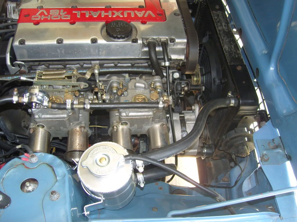

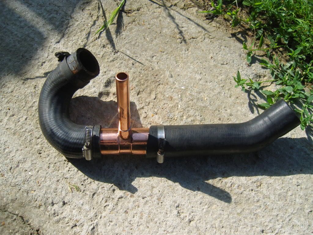

Bottom hose removed and split to take new bespoke T piece (it helps to have a friendly plumber to make this bit up :wink: )
Replace on car with small bore T piece pointing uppermost to enable connection to....
Lovely shiny new bespoke alloy header tank, with return hose to radiator completing the circuit....
Where Jon leads, others follow.
Martin.

mbellinger wrote:Following in the footsteps of the Master......
Excellent work, Martin! I too prefer the idea of locating the header tank on the offside.
Coo that looks nice...............fetch my sunglasses, Martin does it right after Jon shows how to bodge it :lol:

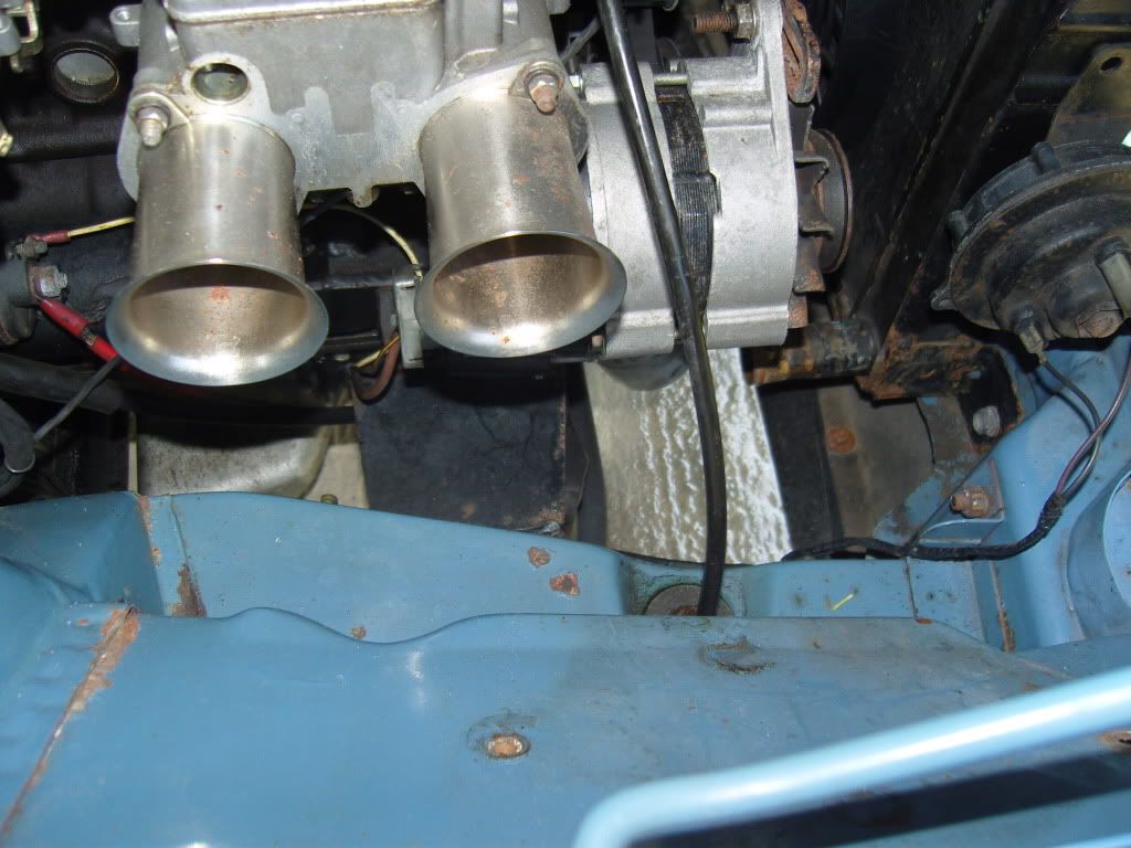

After much deliberation, taking into consideration both Jon's and Martin's demonstrations, I went for an expansion tank mounted on the nearside. I choose this option because to position on the offside on my 1850 would have made access to things like the dipstick, battery or clutch master cylinder more awkward and plus there is ample room on the nearside.
The tank I have used came off a Rover 25. It has a 16mm (5/8") outlet and the 6mm hose from the thermostat housing fits the top connection. I have managed to mount the tank close to the strut turret. This means I have it sited so that its top is just slightly higher than the thermostat housing (I checked using a spirit level).
I routed the 16mm hose under the radiator to a t-piece in the bottom hose.
My car is no different now. The temperature needle sits in the same spot on the gauge. The heater works exactly the same.
No, actually there is a difference, it is easier to check the coolant level!
I haven't been in a traffic jam either with or without the new arrangement so don't know about any difference there.
However I do feel more confident about having to contend with a jam :) .
Before, on the long climb from Inverness going south on the A9 the temperature crept up to halfway, so when I next drive up that stretch of road I may see a difference?
