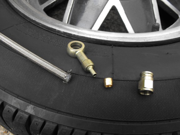

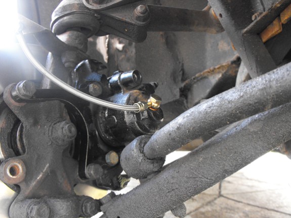

I went a slightly different route, going for a banjo fitting at the caliper and going all the way to the hard brake line with one braided pipe doing away with the Dolly flexi pipe at the same time. I used braided pipe off the roll and end fittings designed to assembly at home with nothing more than a couple of spanners. All the parts came from Rally Design

DOLLY76
Re: Flexible hoses for a Trackerjack conversion.......
#4 Post by DOLLY76 »
Nice bit of kit there.

Being used to working on bikes I was considering using a banjo type hose myself. This issue is getting a seal where the hose enters the caliper. The Sierra calipers have a recess and getting a copper washer seal on that side of the banjo could be a problem. Although it looks like the washer sits on the outer rim of the recess in the photo.
Where I think would be good for a banjo type braided hose is the flexible clutch hose, especially with the prices Rimmers want for them!
triplesfanatic
#9 Post by triplesfanatic »
Looking at the Sierra caliper on my dining table I see it can be done easily if you get a copper washer that sits inside the recess and allows the banjo to clear the caliper body. This has to be the way forward and cheaper than getting the hoses made up.
