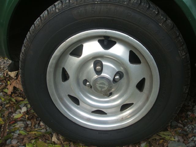

Hi folks, first post. just bought an 1850hl last week, had a few triumphs in the past (tr6,1300tc) but this is my first dolomite that is actually usable. I've just fitted a set of halogen headlamps and what with winter coming in I noticed that the alternator is struggling to cope with headlamps, blower etc. Is there a common alternator upgade? Also, my car is fitted with a set of wheels (picture below) which I've never seen before. The gent I bought the car from tells me they are cosmics and were fitted by the triumph dealer when the car was new but I'm not sure.

Yep, they're Cosmic alloys, are there any spacers behind them, or are they bolted directly upto the hub?
