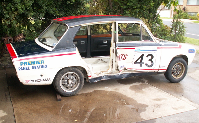

Car 43 regularly competed in this category until April 2008 when it was the innocent victim of another driver’s mistake during Round 1 of the State Championship at Wakefield Park and was for all intents and purposes destroyed. Fortunately for me without sustaining any serious personal injury. The body shell has been in storage, awaiting the resources to restore it once again to Group C specifications. Thankfully after a long wait, as of today the body shell was moved to a repair facility where the work has now started on its repair and restoration.
After Accident
After Accident

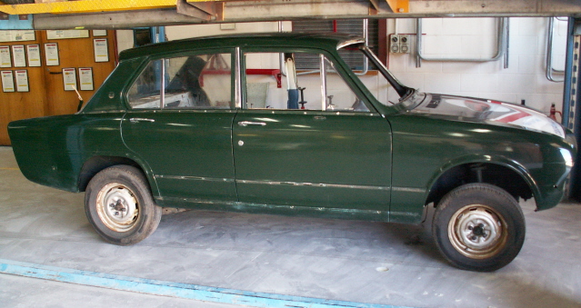

I took the "donor shell" to the the TAFE facility today for them to remove whatever parts they need for the repair of the race car.
Donor car
Donor car
march9th (5).jpg (195.11 KiB) Viewed 38042 times

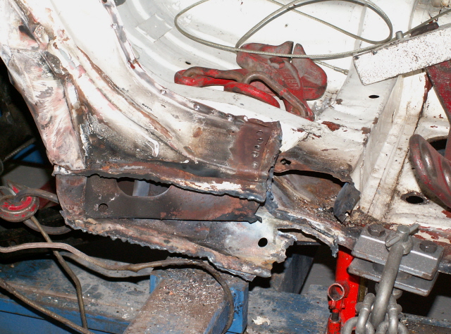

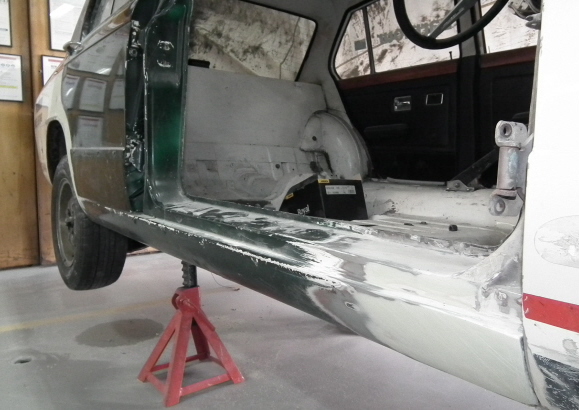

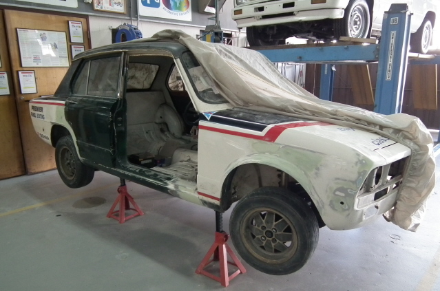

The car is only being worked on 1or 2 days a week by apprentices, with very close supervision from the head teacher. I am very happy with the progress so far. They have started to straighten the shell and have how removed most of the right hand sill and B pillar. Both the left hand doors now open with no problems, probably better than before the accident.
On Jig
On Jig
Rear Sill Area
Rear Sill Area

Had a look the car today, and it is looking good. Basically the shell is now straight and awaiting the fitting of the sill, centre pillar and associated bits and pieces. The sill and pillar removed from the donor shell is still in rough cut state.
Progress will stop over the next few weeks with TAFE holidays. Had intended to take some photos, but found the batteries in the camera were flat when I arrived at the repair centre.

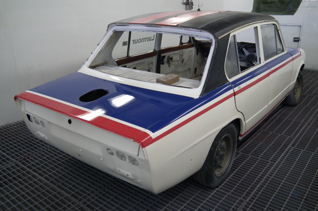

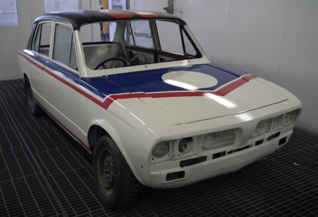

It has been quite a while since I have seen my car, so I thought that I would give the TAFE a visit today, and what good timing it was.
The car is now painted. All that is left to be done is the black on rear panel, and a light buff of the paint work. Although the teacher that has been overseeing the job is a little disappointed with a few small "things", I am over the moon with it. This is ONLY A RACE CAR, so it is going to get stone chipped the first time that it is used. It looks fantastic to me. The engine bay, boot area and inside will be painted by myself, I didn't like to keep asking for more jobs to be done by the TAFE staff and apprentices. I shudder to think how many hour of labour has gone into the repair and paint.
The car should be ready for pickup next week, but due to my work hours I will not be picking it up until the following week, As I am in the process of moving house hopefully the car will be placed in its new garage with in about 2 weeks.

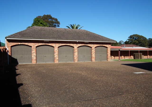

New home for my cars.
Carysfield (41).jpg (203.88 KiB) Viewed 37207 times

imagine, 5 sprints in the garage, on the word GO, each driver has to open their rollerdoor and it is a race to the shops. :lol:
nice looking place Mark, I think you'll still be short of space though.

Wow! What a place, what a paint job. Look at that weather - blue skies and palm trees. You lucky man! How can I convince my wife that there are warmer places to live than Scotland?!!
