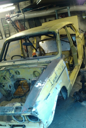

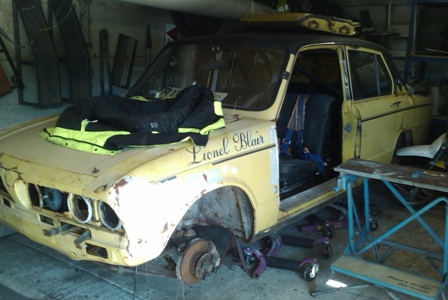

I have recently purchased a 1973 Triumph Dolomite Sprint, The plate under the Bonnet says VA1074 and the car is on a L plate, I purchcased it from a family friend who was the team machanic for the car in the 70s, The car was converted into a Rally car by what was British Leyland in the mid 70s, it was part owned by Lional Blair and it competed in may prestigus Rallys, the car has only done 18000 and the engine 5000 since being upgraded, the engine was built by the British Leyland Works team machanic as a private job and produces 205 BHP, it has twin 48 carbs, it has a full roll cage, has fully ajustable suspension all round and upgraded half shafts. The car also has paper work for many of the Rallys it competed in.
Im told it is one of the 1st 2000 built as its yellow? The car was complete when I purchased it and still has the origanol Rally stage timeing equipment installed.
I have stripped the car and had it shot blasted and primed, I am currently repairing the body, it is in remarkably good condition, not much rust apart from the front panel that was left exposed whilst stored.
I will have the original livery repainted on the car to keep it as original as possible.
Would like some advise on where to purchase panels if anyone can help please.
I will try to upload pictures as I work if any one is interested in its progress?

MikeyB wrote:You're a lucky guy Andy, as an early Sprint nut I would have loved to get my hands on that, do you have a VA (commission number for it)?
At first sight there are some really interesting differences on the front suspension. Look at the lower TC arm, anti roll bar, brake backplate & caliper etc.

I will apply for the member ship, you are correct, nearly all the shell is very good, the sills, doors roof etc are very very good, but once I had it shot blasted the front panels were beond repair, I have drilled out the spot welds and removed the complete front panel, would like to replace them with original as the car will get a lot of use when completed.
