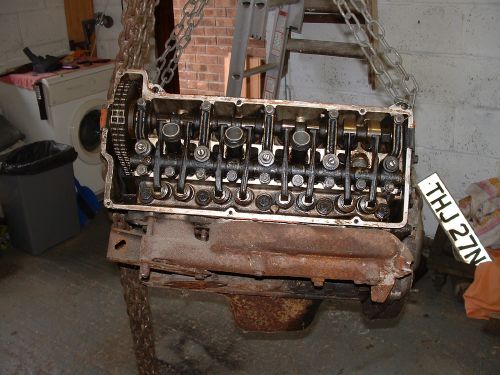

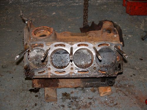

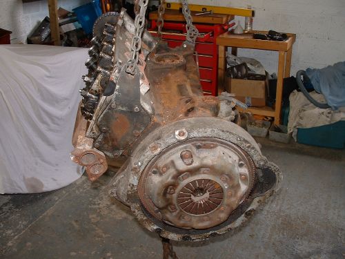

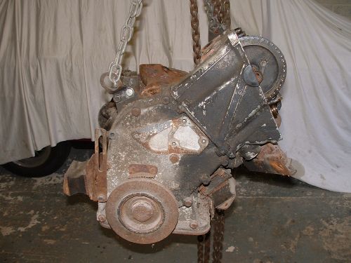

So today I decided to strip a spare Sprint engine I have in my garage. Remember the barn Sprints?.....
Well this is the engine that came from the Honeysuckle one...
The idea is to strip it down completely & see if it's worth rebuilding it or scrap it.
Image Image
Image Image

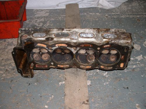

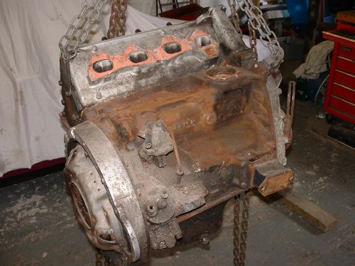

One of the bolts holding the timing chain cover in place had seized solid and the bolt sheared as I tried to undo it. The bolt itself had seized to the cover & as I was trying carefully to prize it off, it cracked. I have a few spare so wasn't too upset. Just a shame to ruin a decent cover.

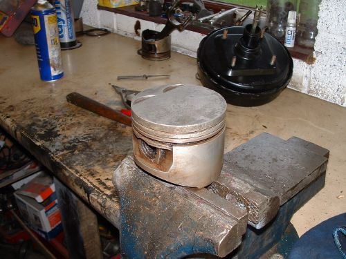

The pistons seem to be seized so I have them soaking & will keep them like that for a day or so.

It took a while to get the pistons out but got there eventually (whacked my thumb with the hammer whilst doing so :fuming: ).
All the bores and the pistons look in good condition & I reckon the engine had recently been fitted with new bearings before it was taken off the road (must be 14-15 years ago now). All the rings were seized in the piston grooves. I got to the third piston before I broke a ring (not that I shall be re-using them mind you).
So I just need to check the crank & hopefully it will be a goer to rebuild.

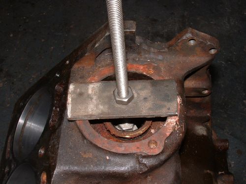

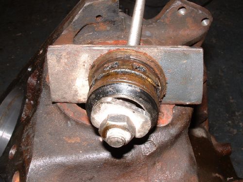

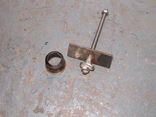

One final bit to take off the block was the brass cage from the water pump, so I made up an extractor...
Image Image
A few turns of the nut & it was out and no damage to the cage at all.

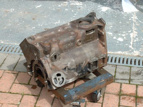

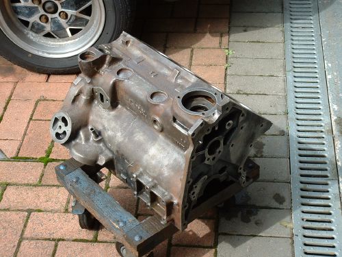

I then cleaned the block up using a wire brush wheel on my leccy drill, getting rid of all remnants of gaskets & other $h1t. Then washed it over with degreasant before finally hosing it down. I just need to run a tap down all the tapped holes.
Image Image

The large piece of metal is 40x5 flat which I had lying around. The piece that goes into the cage was a thick washer (about 2-3mm.) which I had & just cut two sides to it and made one end slightly shorter so that it would slide through the bottom of the cage. The studding I had lying in the attic. It could just as well be a large bolt.
