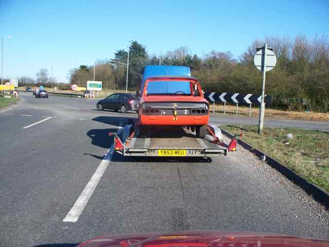

On the road again... in a manner of speaking. Off for the respray.
Big thanks to Mike and Tom (and to Derek in advance)!

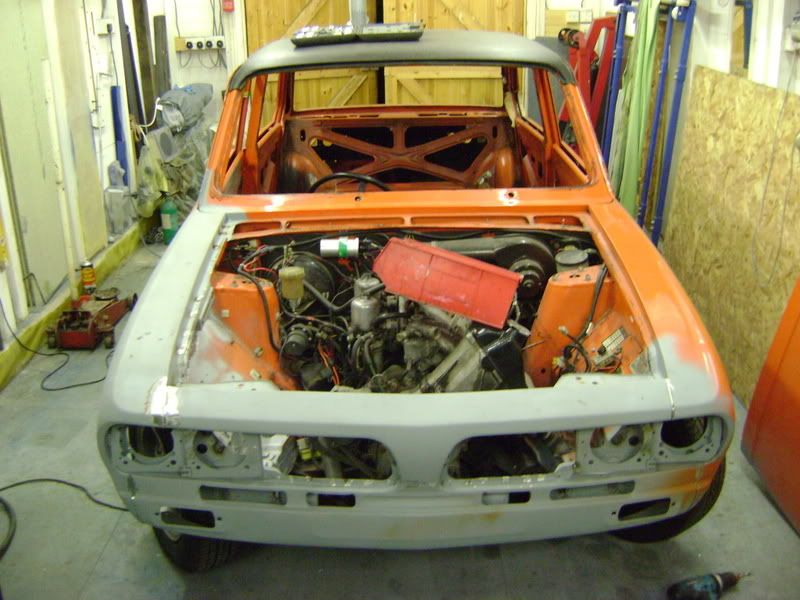

Now safely tucked up in the workshop, the front end has seen additional welding to fully secure the front inner panel to the ends of the inner wings. The upper and lower edges of the O/S wing now fully secured and welds ground flush. Nearside headlamp panel secured in place and I have also re-defined the line where the wings join the front nose panel and repaired the rear drivers seat mounting that had collapsed.
Work began on cutting out the rot above the pedal box. Will get this finished tomorrow.
