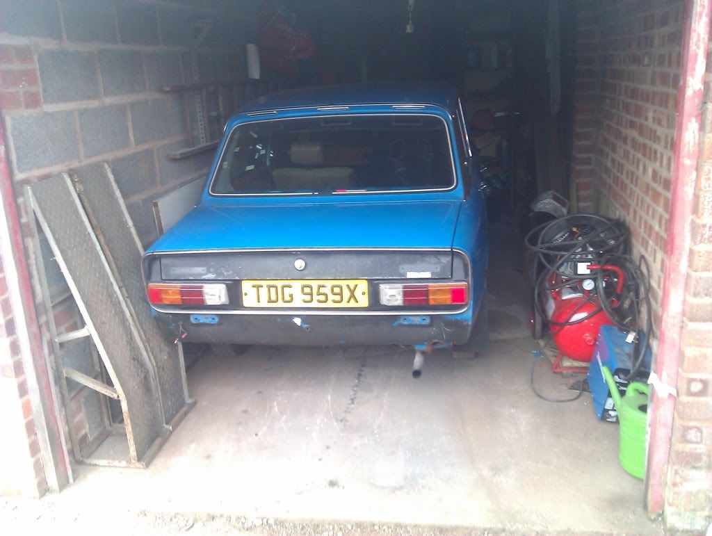

So... the plan is to finish clearing out the lock up i have just aquired for a nice price as it is full of old mens gardening junk,
then move the car in and complete the welding ASAP so I can get it in for a pre mot check.

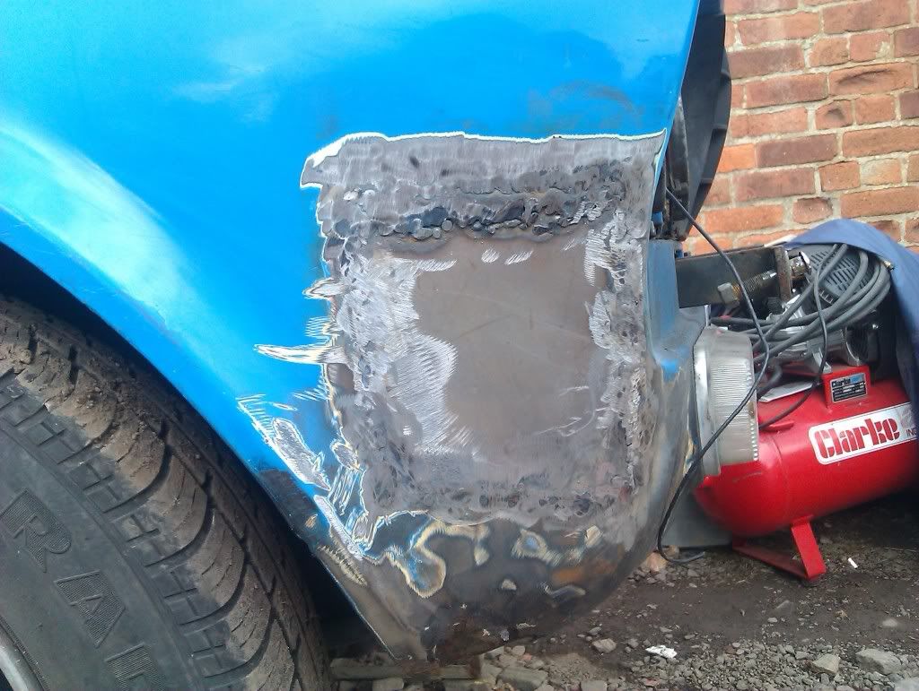

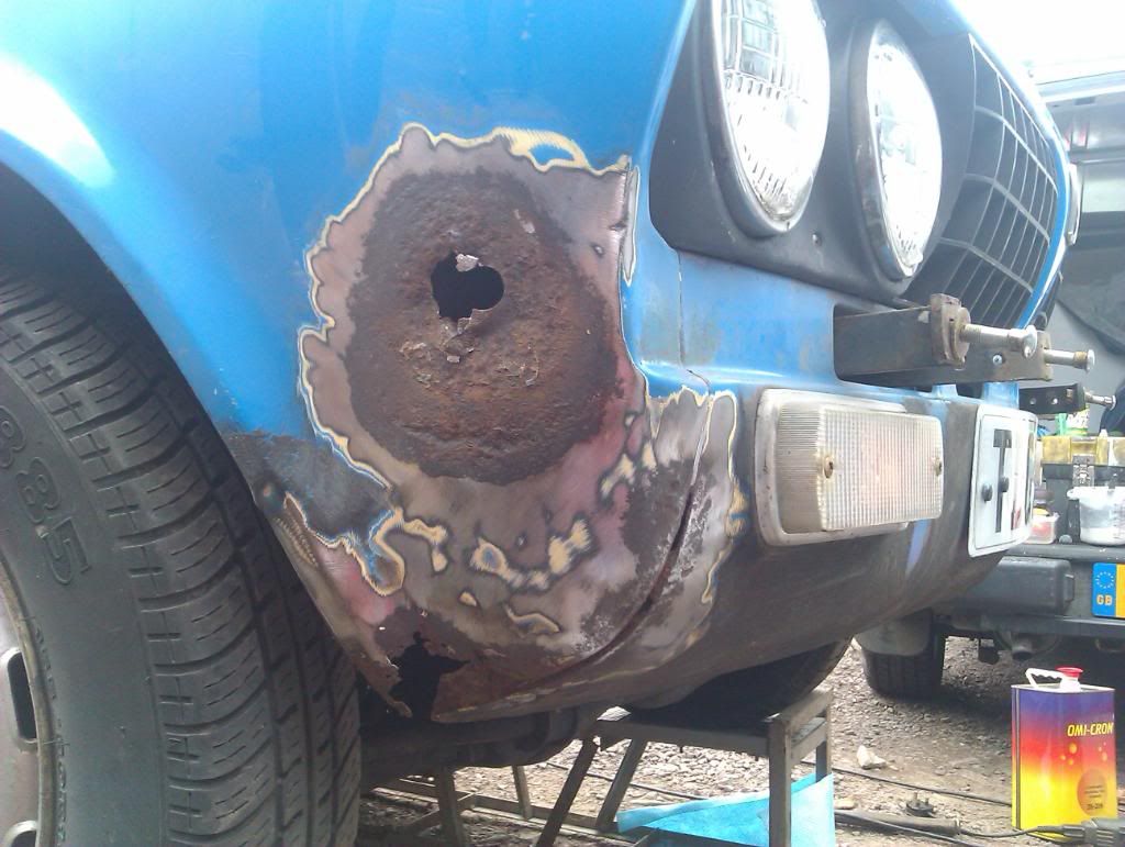

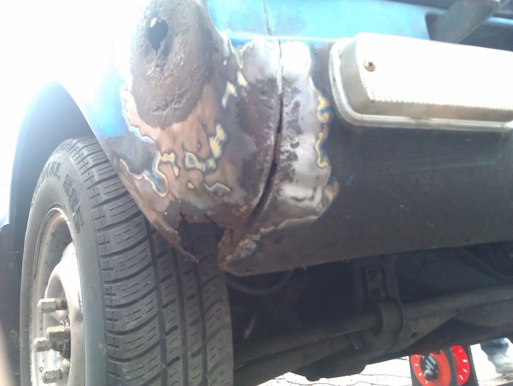

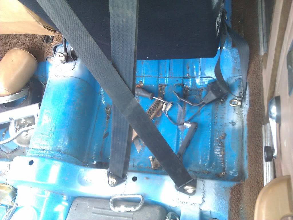

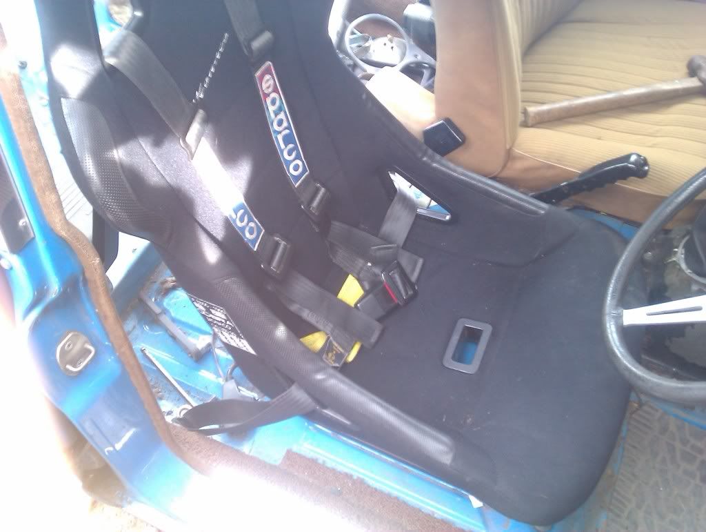

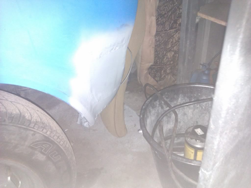

Sorry for the long reply!

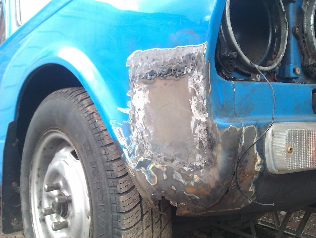

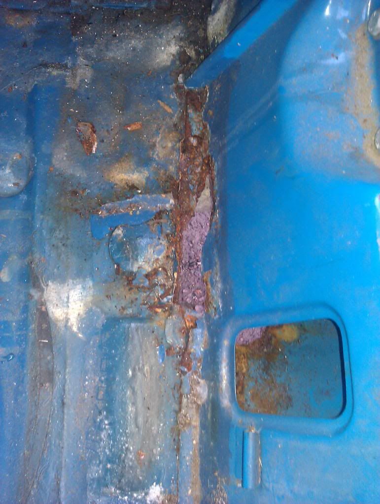

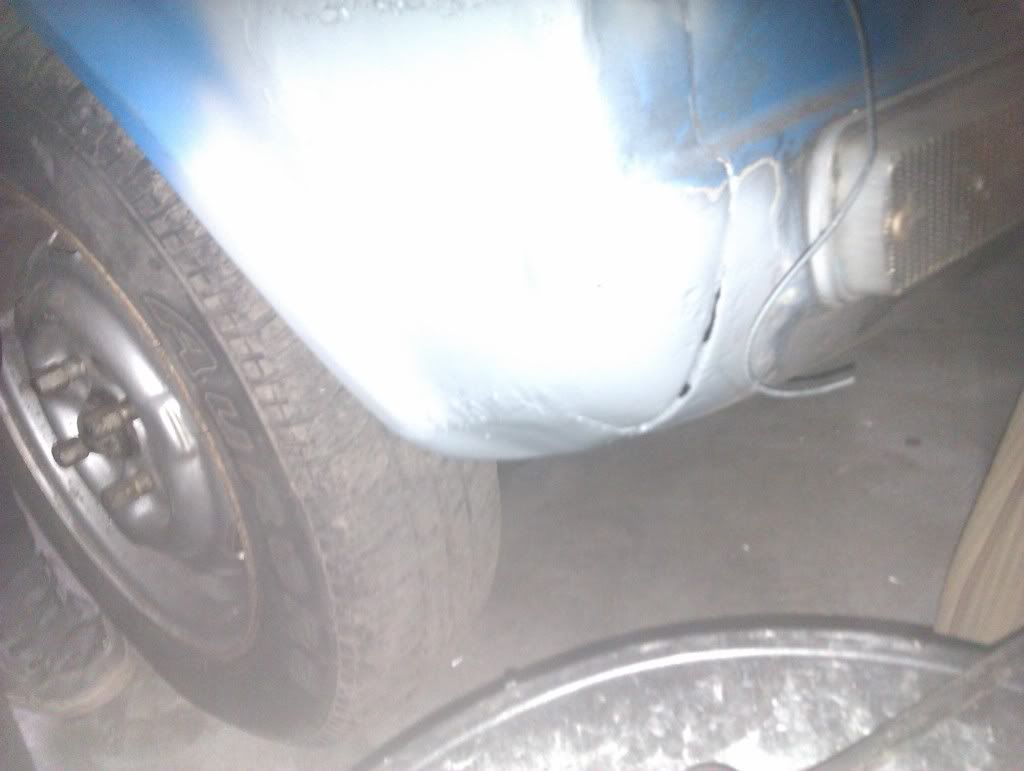

work commitments and shoddy welding have kept me off the computer. i have welded a plate into the wing now and farbicated a new bottom corner too.
I have stripped the seats and fitted my cobra bucket seat and have welded the 4 point harness mounts in place so far but all engine plans are on hold while I make my mind up on what engine I want!!
too tired to type so i'll just throw some pics up
cheers!
cheers!
