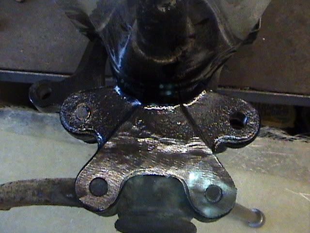

This is an upright with my special brackets added so that a Ford caliper can be used.

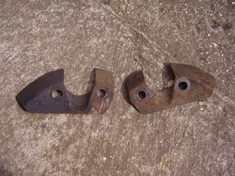

I do not run with the disc covers in place (most modern cars do not have them either) but it is important to fit these (see pic) as the lower ball joint gets hot otherwise.
