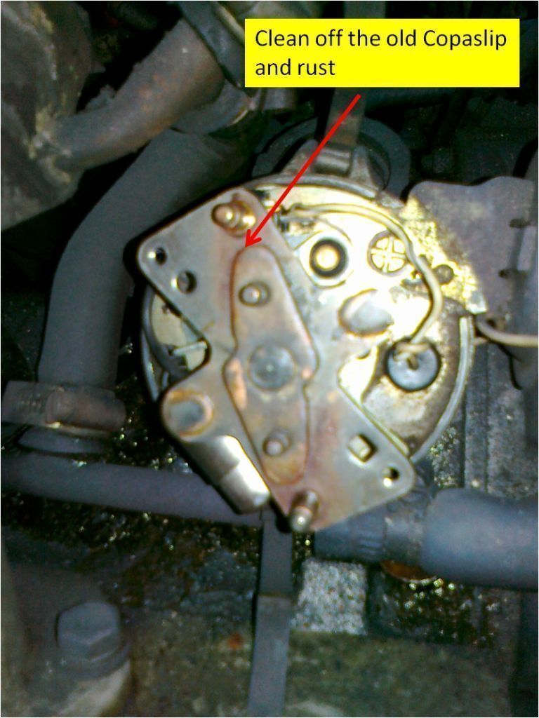

1850 points pic 4.jpg (108.12 KiB) Viewed 1620 times
Move the spring plate to the angle shown. You can now see the points.

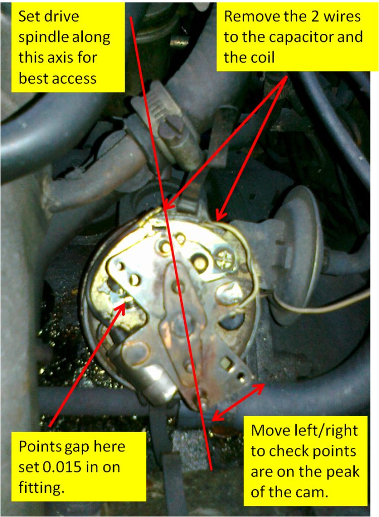

1850 points pic 5.jpg (131.68 KiB) Viewed 1619 times
Remove the 2 wires and the 2 fixing screws. Yes, one of mine has had to be replaced in the past.
Yes, the operating heel on the points does seem to wear.

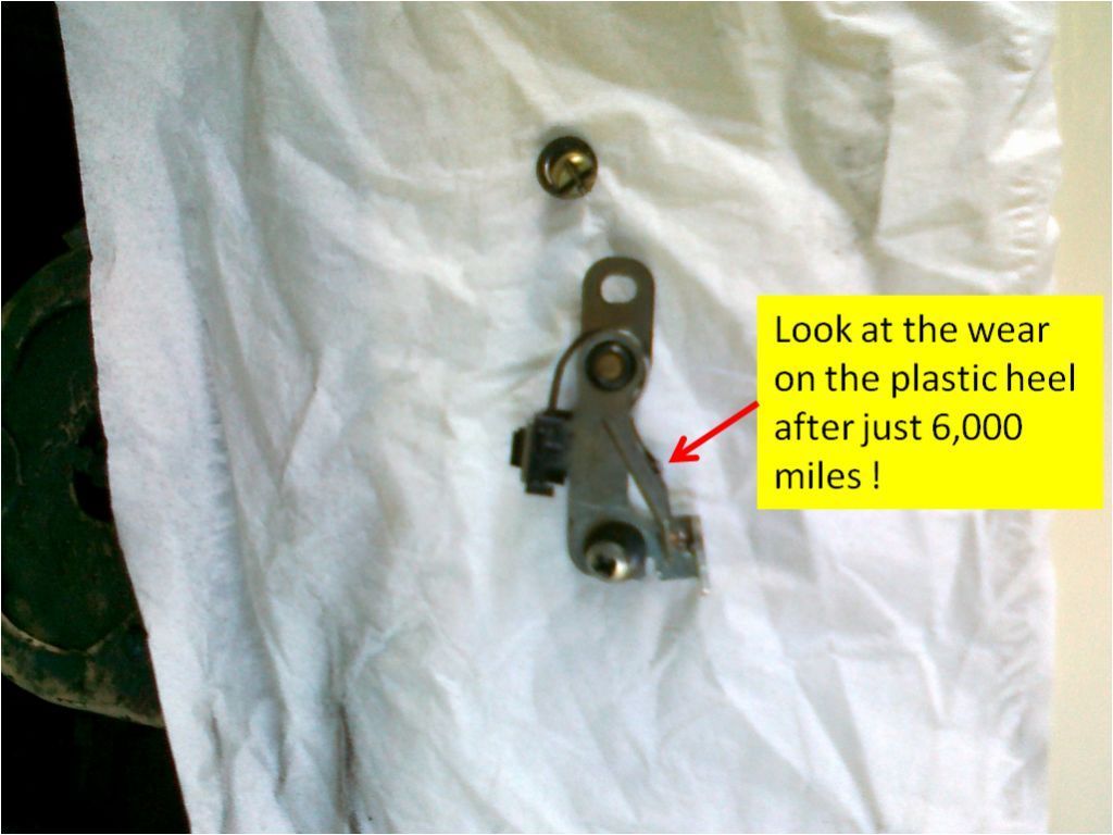

1850 points pic 6.jpg (84.94 KiB) Viewed 1620 times

Smidge of grease on the cam will cut down on the wear.
