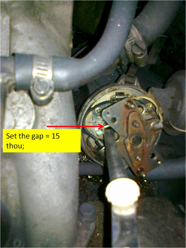

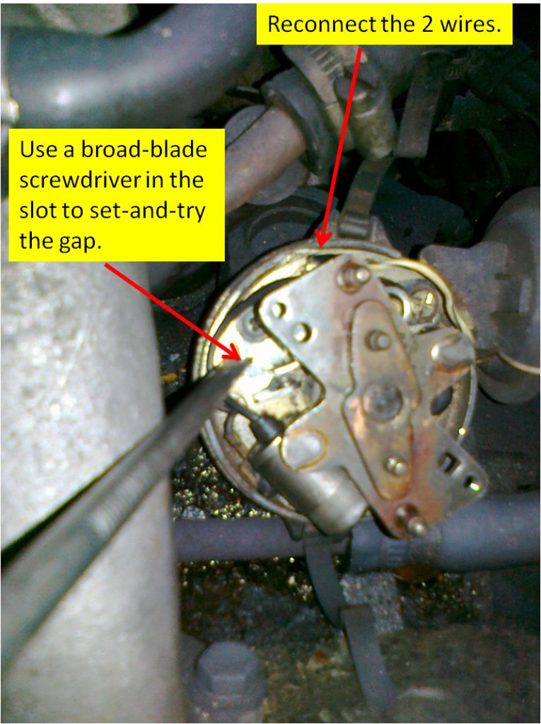

Reconnect the wires, and replace both screws and back off about 1/8 turn so it is just possible to move them with a screwdriver in the adjustment slot.
Using one hand to check the points gap, use the other on the screrwdriver to open / close the gap.1850 points replacement in pictures 3.

Personally I find it not very precise to use the feeler gauge because it has to be used perfectly perpendicular in order to get a correct gap. I'd like to preset it by eye and check this after install with a "strobe light" which also measures dwell angle (don't know the correct name for the device, mine is a Hella-make). Just checked it during starting and later on (when distributor is closed and plug leads connected again) with running engine.

Come on, who remembers the old fag paper trick? My old dad (ex-reme) got my old motor bikes running many times this way, seems they (the fag paper) were less then 2thou, while the fag packet was 15thou. (near enough). Near enough ain't good enough, its got to be exact,.... it is exact,.... near enough then! Ship yard mantra when I was a boy, when we had shipyards!
