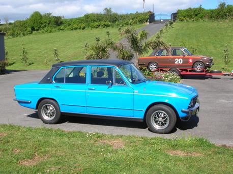

Was just about to post something similar. My Sprint is on 185/60/13 Yokohama A038Rs which are great for trackdays but not ideal elsewhere. I plan on using the car more this year hopefully so am thinking of putting something more sensible on it. The other problem with the Yokos is that they don't fill the arches, and the front looks particularly "high", as seen here:
Twins by binaryimage, on Flickr
Any suggestions? It's on lowered adjustable Spax.
Edit: it's the one on the right with the wrong stripes!

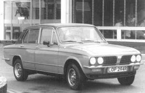

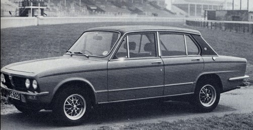

Just to add....
Looking at these Factory pictures of two different Dolomite Sprints we can see that when new that they sat high on their suspension;
- sprint2.jpg (10.25 KiB) Viewed 1569 times
