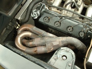

- Posts: 8529
Re: tr7 gearbox conversion
It has been done by a few...
Taken at Cosford TDCIR a few years back.
- Posts: 7244
Jeez Mart , that is a real banana bunch, I dread to think what the underbonnet temperatures were like! SteveMad Mart wrote:It has been done by a few...
Underbonnet temps would be fine with this http://www.zircotec.com/ Run it on a full race Riley and you can touch it after 45 minutes on the track as soon as it comes in. Just remember that the exhaust gets hotter further down the line instead tho.
