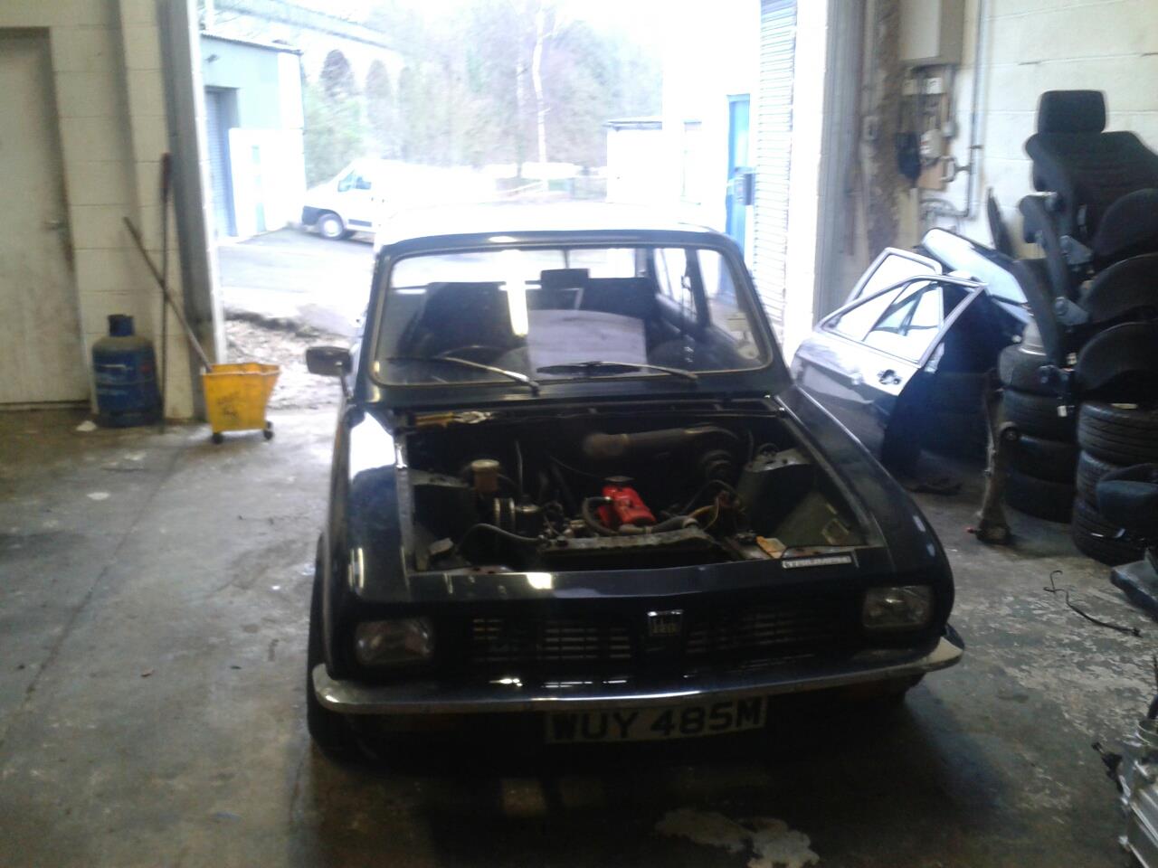

Hi Guys,
Sorry I havnt been on her for a while, I thought it was about time I updated this as I have finally got round to making progress! :P
Here are a couple of initial shots, all the engine and gearbox mounts are now complete and ill get some better pictures when Im next at the unit.
Prop to pick up tomorrow so fingers crossed it might be driving in a few weeks!
Anyways here are a few pics.
Trial fit
Trial fit
Sat on mounts
Sat on mounts
Old engine
Old engine
