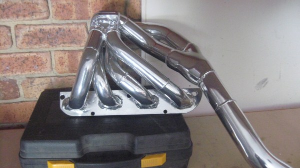

More recently i decided to fabricated asystem for the exhaust as the old cast iron box even though its opened up and runs a three inch pipe restricts breathing somewhat. So here is a picture of the headers - in three parts, we had to completely rejet those 48mm Webers and in a few days will do a final check on a dyno before putting it back on the track after a considerable lay-up. Interested to know what other think.

Hi Guys, sorry but just getting feel of this ... hopefully this attaches the picture of the bespoke headers we just fitted. Huge difference to engine but it leaned out so much had to change emulsion tubes as well as mains and airs! Seems Ok now running LM1 and showing about 12... across the range.
- Bespke Sprint headers.

Looks great. Does it fit without having to chop away at the suspension turret?
Any chance of a picture showing it fitted?

Soorry lads.... I have been away having a quadruple bypass!!!!!!!!!!! The headers worked so well we had to virtually double the amount of fuel required. Now I am back in town as it were, I will freshen engine as it has not been touched for five years and do some tests to see what power gains we get. I did do a few laps at Winton and was reasonably happy, but did not push as I was still in recovery mode...

kojac777 wrote:Hi Guys, sorry but just getting feel of this ... hopefully this attaches the picture of the bespoke headers we just fitted. Huge difference to engine but it leaned out so much had to change emulsion tubes as well as mains and airs! Seems Ok now running LM1 and showing about 12... across the range.
So do they go upwards before they turn downwards to go through the transmission tunnel? A picture of it installed would be great!

Came across this one on a French website... Picture not the best quality, but header is quite spectacular

i love the fact that it goes underneath the sump
