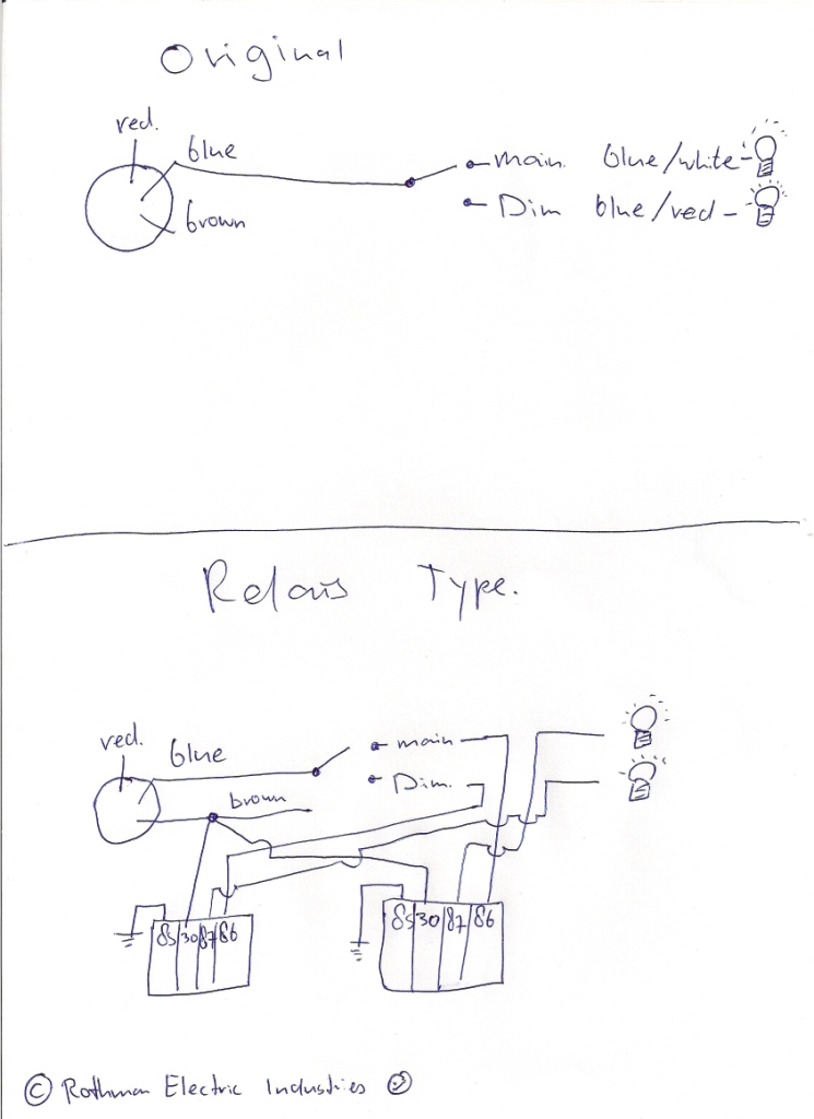

I have 2 seperate relays 1 for the dips and 1 for the high beam I was intending to trigger 1 for dip beam from blue/red cable which is live on dip only and switches off when high beam is selected, and trigger other relay for high beam from blue/white cable which is only live when high beam is selected. Is this not correct? it what I used to do with other brands in the late 70's and early 80's with various sporty Escorts that I used to own,and never had both high and low beam on together. Is Dolly wiring different ? or is there some kind of link in the cables that needs to be wired differently? :? .PJB

#10 Post by soe8m »
No, just two relais and no diodes. Now drawing and will post.

#11 Post by soe8m »

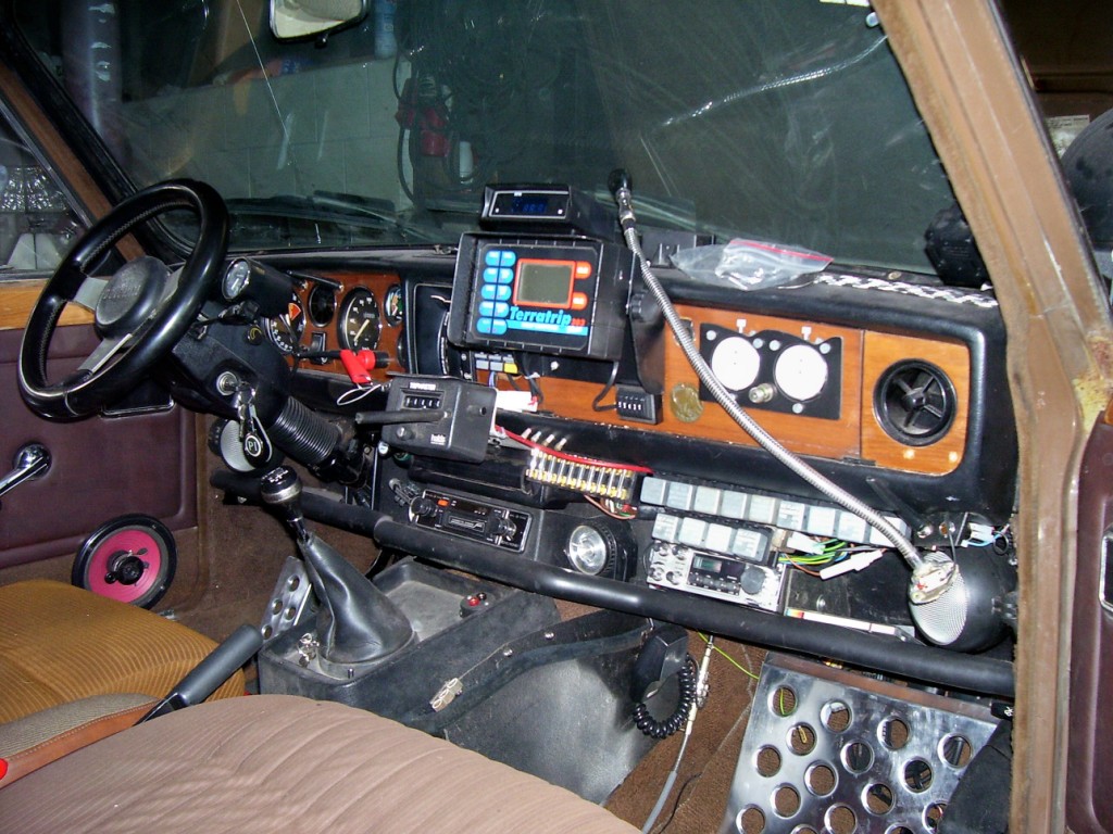

This is it. In the picture of the interiour of my daily you can see how neatly it fits inside the cover. It cannot be seen that there are extra relais fitted for the std. lights.
Edin Dundee
Re: headlight relay help
#12 Post by Edin Dundee »
You are absolutely right Jeroen, that Dolomite looks perfectly standard to me. :lol:

#13 Post by 2dollys »
Thanks Jeroen.This is what I intend to do,but using the blue/red and blue /white wires at the r/h/front at the chassis rail,just in front of the suspension turret,instead of inside of the car. I intend to solder my relays into the wires here and take a fused link direct from the battery to feed the lamps via the relays. PJB
