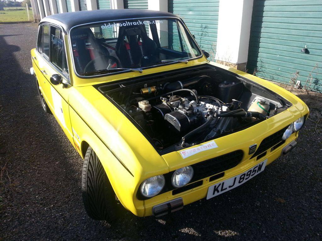

Look what i have just bought
KLJ895W, track day sprint. £3000 from a nice chap in Bristol.
Superficially it looks ok, but upon test driving it my dad pointed out a very noisy diff. We took the back plate off this morning and there is some very worrying play in the cross piece(i dont know the actual name) which holds the planet wheels in place.
synchro between 3rd and 4th is worn
hand brake adjustment cylinder's seized on both rear drums(meant we had to remove the drum to get it in the garage)
emissions are out on both HC and CO. hoping this is a simple jetting issue!
i would appreciate all of you questions and queries!

Lovely car! I was very interested in, my Dad even went to view it.
As for the HC and CO you should be able to alter it by adjusting the mixture screws. I set mine using a colortuner which works really well.
I would also expect a little more power from that engine considering the spec, so maybe it'd be worth checking the jets anyway.

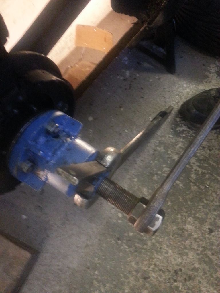

using an awesome looking puller to remove the hubs!
