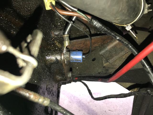

I had the exact same symptoms; for future reference:
After trying the suggestions above, swapping ignition switches, coils etc - 4 hours later, it turned out to be the alternator connector that was not fully engaged.
(Yesterday I had been re-attaching a (what I think is a capacitor, blue cylinder) wire to the thickest brown wire on the alternators connector (via yellow wire tap connector).
- 0.jpg (47.66 KiB) Viewed 725 times
